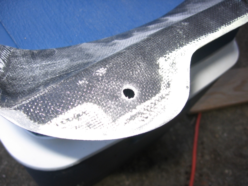

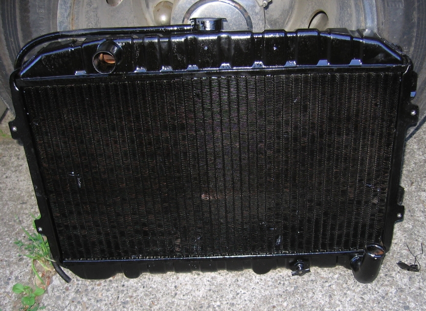

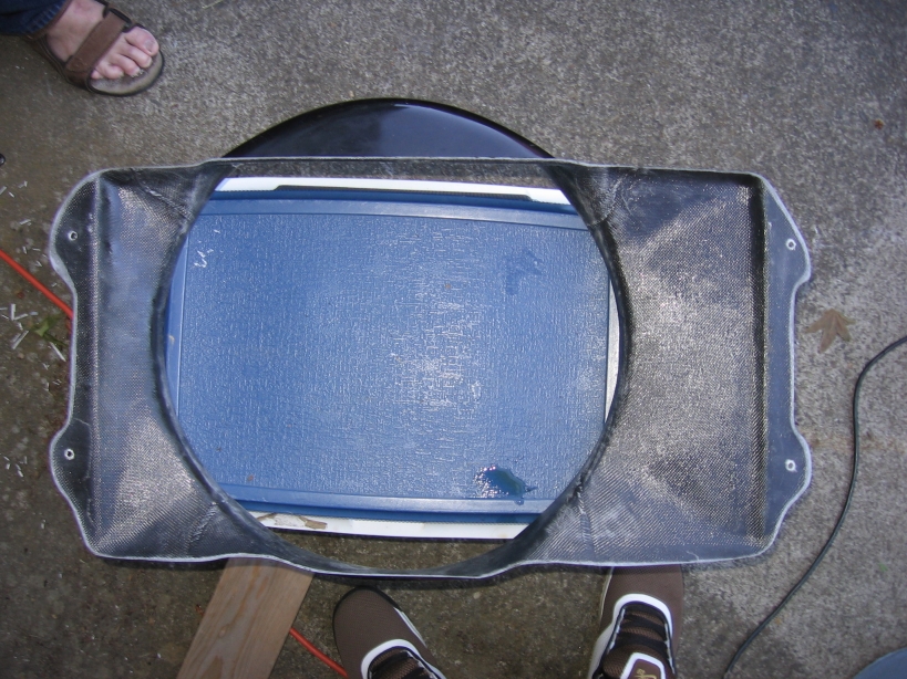

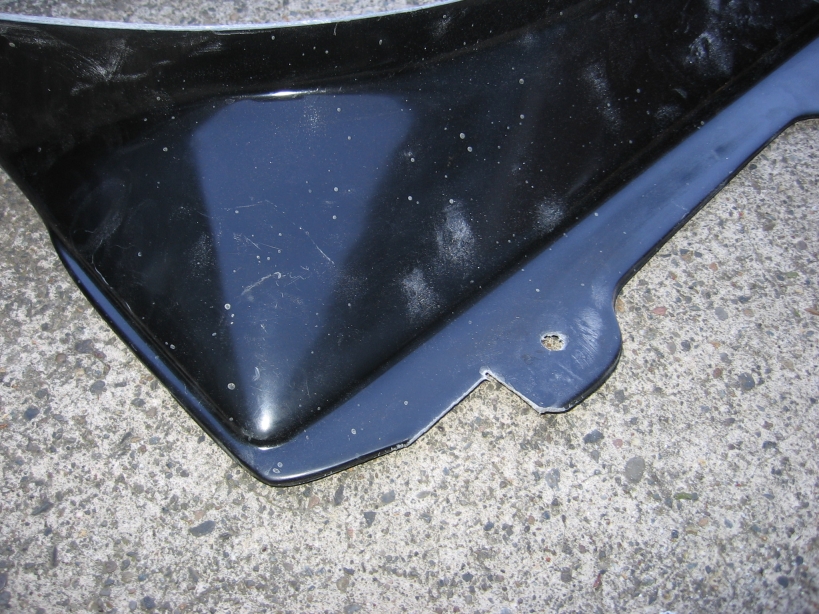

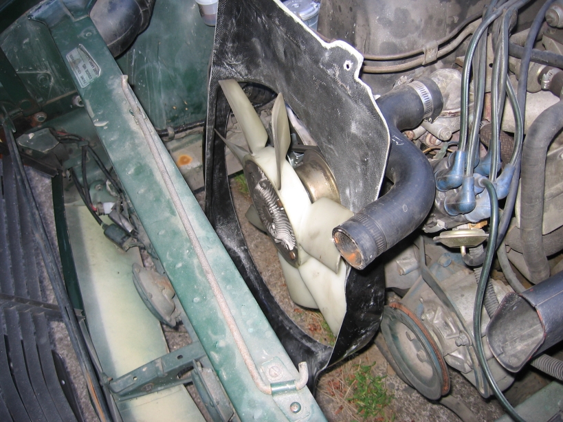

Posted June 14, 200816 yr comment_250748 I just completed mounting the fiberglass radiator shroud that I recently purchased from MSA. Let me tell you, it was a kinda PITA. So I thought I'd share with everyone how it went. 1) First step, drain al the coolant. There's a spigot on the bottom of the radiator, simply spin it and watch the coolant drain. about 2 1/2 gallons are in there. There's also a drain bolt on the side of the block. 2) Second step, remove the radiator. This is very simple. It's attached by 4 bolts and two hoses. Unscrew the hose clamps, work the hoses off and them unbolt it. Be careful when you pull it out, there's still some coolant in there. 3) Next, I had the radiator flow tested and hot tanked to clean it out. It was pretty rusty. 4) Once I got it back, it was time to see how well the shroud fit. The fit was alright but not perfect. It wasn't quite square, needed the holes drilled, and a little bit of trimming because the edges interfered with the frame. So first I drilled the holes. I marked the placement by heating up a small screwdriver and sticking it through from behind to melt a small mark. The drilled at those spots. 5) Fifth, I mounted it through those holes and marked with my niece's sidewalk chalk where the extra material on the shroud was. 6) Then I took a jigsaw and cut off some of the unnecessary excess fiberglass. Now I should have thought it out more, because I ended up cutting off the wrong part. It didn't mess things up, but it didn't help the interference issue. You should cut lower on the shroud than I did. 7) Lastly, it's time to mount it back on. This part was the biggest PITA. If you're gonna do this, listen to my instructions and save yourself some grief. First, put the shroud over the fan and spin it 90 degrees. Then lower the radiator most of the way into it's position. At this point you can spin the shroud into place and lower everything down into position. Now bolt the radiator on, then the shroud on to it. Tighten everything down (not too tight on the fiberglass. And I used nice large washers to spread out the load as much as possible). Attach the hoses, refill the cooling system and enjoy not overheating in traffic! BTW, I refilled it with water and drove it around for awhile to flush the system out before putting actual coolant in. Link to comment https://www.classiczcars.com/forums/topic/28420-mounting-a-radiator-shroud/ Share on other sites More sharing options...

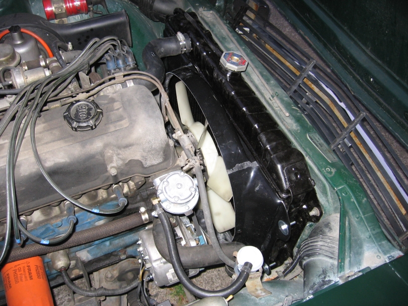

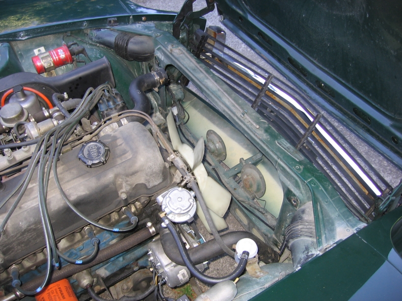

June 14, 200816 yr comment_250753 [ATTACH]23773[/ATTACH] I hope you didn't leave your top radiator hose looking like that! Link to comment https://www.classiczcars.com/forums/topic/28420-mounting-a-radiator-shroud/#findComment-250753 Share on other sites More sharing options...
June 14, 200816 yr Author comment_250754 [ATTACH]23773[/ATTACH]I hope you didn't leave your top radiator hose looking like that! Because of the lighting and angle, it looks worse than it is. It's actually a good bend, not a kink. Link to comment https://www.classiczcars.com/forums/topic/28420-mounting-a-radiator-shroud/#findComment-250754 Share on other sites More sharing options...

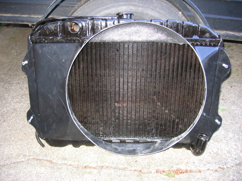

June 14, 200816 yr comment_250762 What happened to the metal shroud on the top of the radiator?My series I 240Z OEM radiator has a short shroud at top to prevent fingers and hands penetrating the plane of the rotating fan blade.Is your radiator original or aftermarket replacement? Link to comment https://www.classiczcars.com/forums/topic/28420-mounting-a-radiator-shroud/#findComment-250762 Share on other sites More sharing options...

June 14, 200816 yr Author comment_250776 What happened to the metal shroud on the top of the radiator?My series I 240Z OEM radiator has a short shroud at top to prevent fingers and hands penetrating the plane of the rotating fan blade.Is your radiator original or aftermarket replacement?I don't know if it's original. I assume that it is, but I'm still new to Z car ownership. When I get home I'll check my FSM. It does have the mounting brackets for the shroud, that line up with MSA's shroud so my thinking is that it's an original radiator.280~Master:I don't see any need in removing the hood, it didn't get in the way. Although I guess it couldn't make things any harder. I didn't remove the fan simply because I needed to get the shroud lined up and marked such that it didn't interfere with the fan's rotation. Link to comment https://www.classiczcars.com/forums/topic/28420-mounting-a-radiator-shroud/#findComment-250776 Share on other sites More sharing options...
