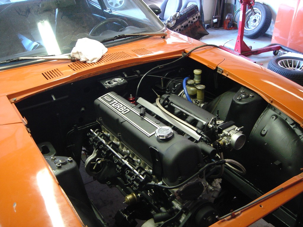

My engine bay is stripped of everything but the engine. No crane! I need some metal work to be done before I can even think about painting. The lower shock towers need to be cut out and patches welded in. Then the battery tray. This is why rust removal is just like cancer surgery. I had a small hole that I thought could be fixed from the outside. It turns out that by the time it was cut completely out, you can stick your fist through it! I cut my batter tray out to reveal heavy scale under the tray. Had I not removed the tray, I would have never been able to get to that rust.

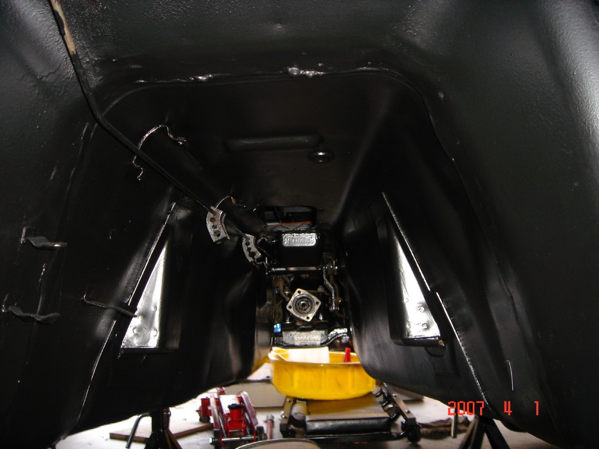

The tranny tunnel was painted with POR15 and POR's Chassis Coat.

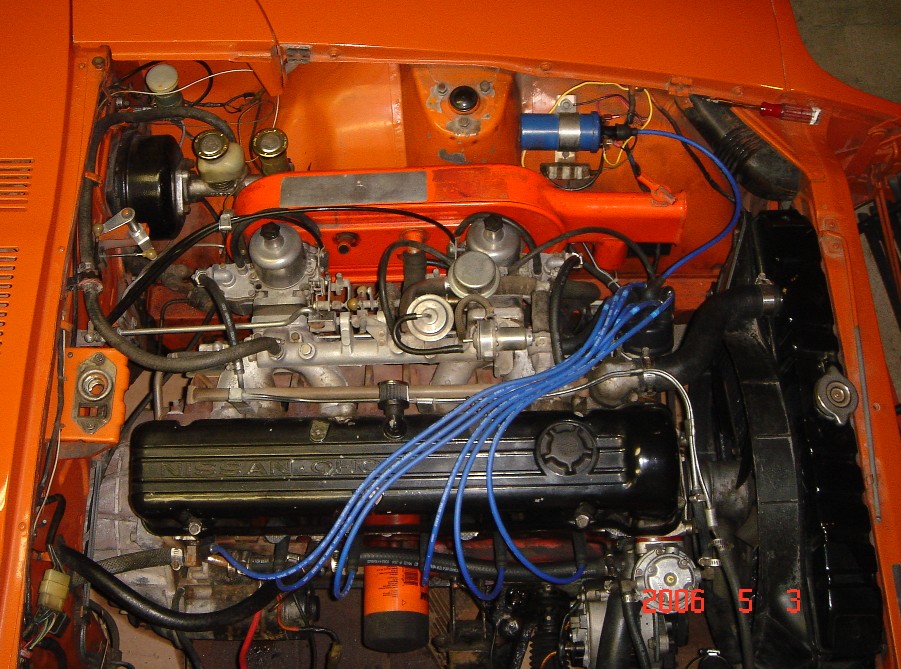

BTW, that black engine bay looks great!

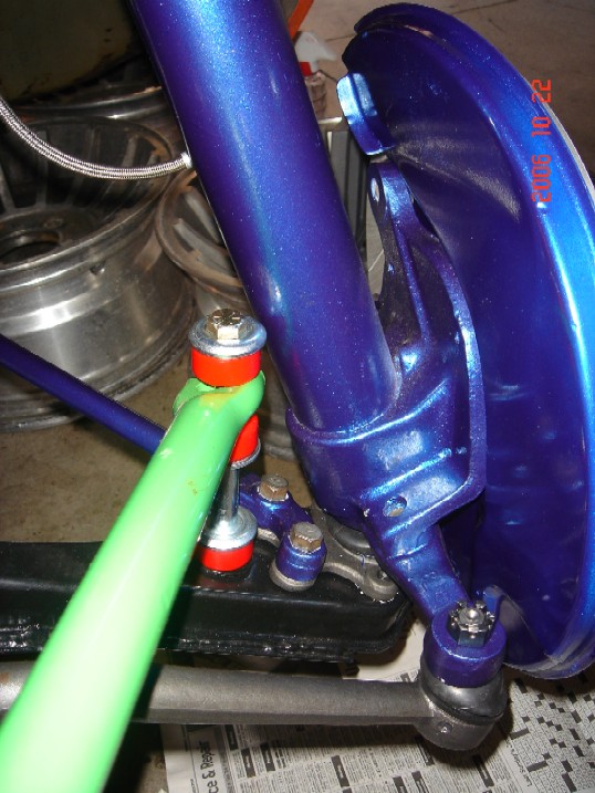

bkelly, I am assuming you mean mine (engine bay). Thanks. :) It was done with a rattle can, as were the suspension pieces also pictured.
