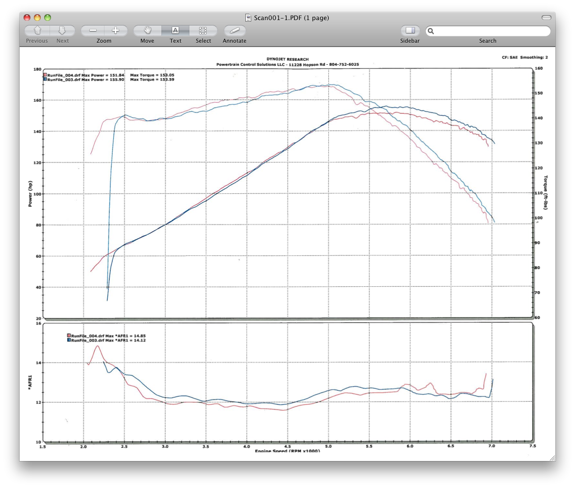

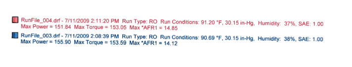

July 14, 200915 yr comment_289530 I just scanned the dyno sheet for my dad. Here they are.Scan001.PDFdyno2.PDF Link to comment https://www.classiczcars.com/forums/topic/28527-new-l-28-goes-in-the-1970/?&page=3#findComment-289530 Share on other sites More sharing options...
August 2, 201014 yr comment_327031 I just scanned the dyno sheet for my dad. Here they are.Converted to images so everyone doesn't have to download them. Link to comment https://www.classiczcars.com/forums/topic/28527-new-l-28-goes-in-the-1970/?&page=3#findComment-327031 Share on other sites More sharing options...
August 2, 201014 yr comment_327034 Impressive dyno numbers. I wonder why the HP & Torque curves don't cross at 5,250 RPM? After all, that is the calculation constant. Link to comment https://www.classiczcars.com/forums/topic/28527-new-l-28-goes-in-the-1970/?&page=3#findComment-327034 Share on other sites More sharing options...
August 3, 201014 yr comment_327063 Impressive dyno numbers. I wonder why the HP & Torque curves don't cross at 5,250 RPM? After all, that is the calculation constant.That only works when talking about hp and lb-ft and when the vertical scales on the plot are equal.That is an amazing looking engine bay! Still no video? Link to comment https://www.classiczcars.com/forums/topic/28527-new-l-28-goes-in-the-1970/?&page=3#findComment-327063 Share on other sites More sharing options...
August 3, 201014 yr comment_327075 That only works when talking about hp and lb-ft and when the vertical scales on the plot are equal.Ah, you are correct. I never bothered to look at the right side of the chart and assumed the scales were equal. Link to comment https://www.classiczcars.com/forums/topic/28527-new-l-28-goes-in-the-1970/?&page=3#findComment-327075 Share on other sites More sharing options...
