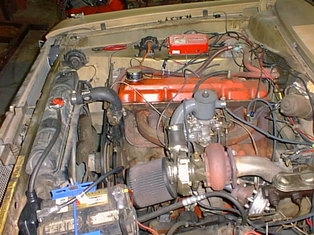

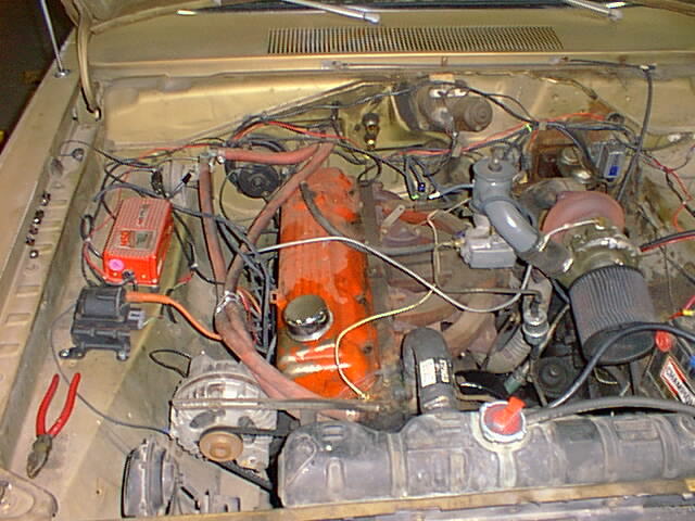

Here's a pic of a carby turbo that was installed on the 225ci Slant six that came in Chryslers (Valiants in Australia and I think the same in US/Canada)
You can get a rough idea of what it looks like anyway.....
