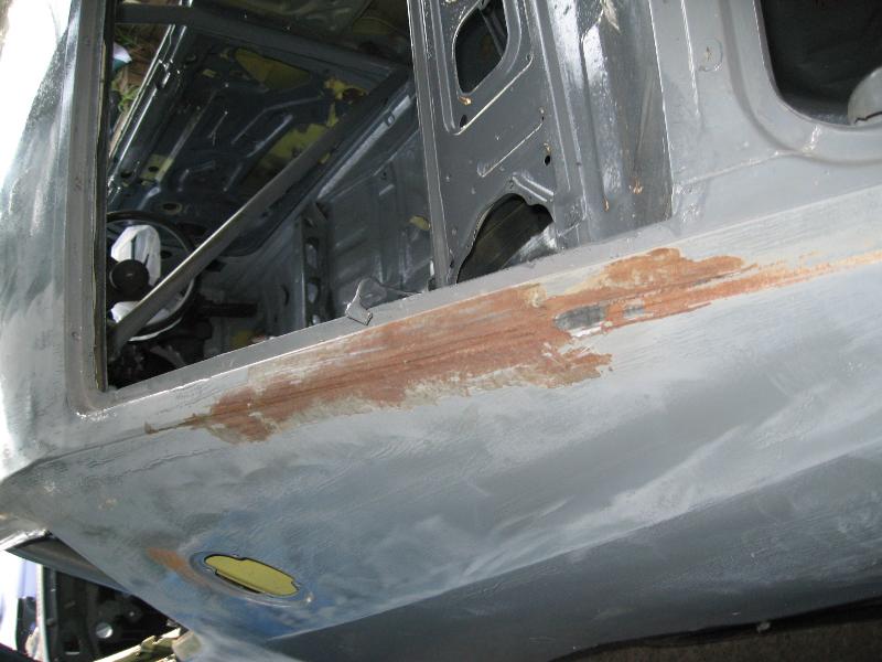

So my mate started trying to convince me that we should attempt bogging, sanding, priming etc.. on a small area and see how we go.. so i started sanding the POR to start work, and sections of POR started flaking off!
It seems that the POR metal ready rust conversion hasn't worked completely.. it seems that 90% of the car may be ok, but there are some areas (the POR looks bubbled, and will chip right off), that the rust seems to still be active beneath the por. It is strange though, because there are areas right next to the effected areas, where the green remains of the metal ready still exist.. and the POR there seems to be working well.

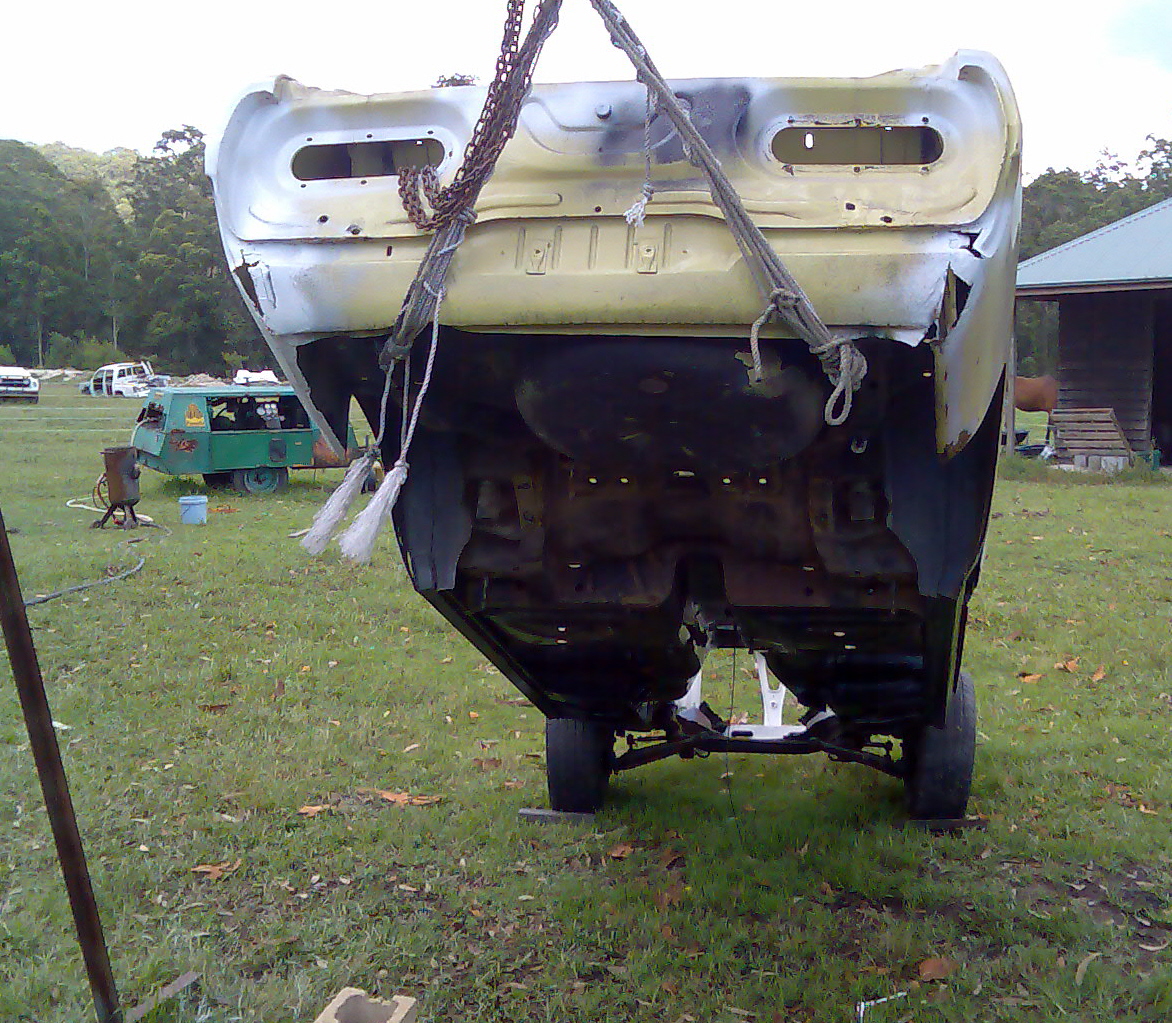

You have to use a big pressure pot sand blaster kit to have any real affect. You can see the one I used in the back of this photo. I found with por you really have to scrub the matel ready off with a rag until the panel is free from it all then let it dry in the sun, it kinda goes a little rusty (yellowish) after this and the por sticks really well. Where the por drips down and builds up I had to scrape off as it hadn't worked/stuck properly. My whole car has been done in por and if I could turn back time I would have only done the underneath and in the cabin where it was sandblasted. The por requires no marine clean or metal ready if sandblasted. My panels were dipped so they didn't need the metal ready either. The bits I used metal ready on are the bits I've had problems with. As it states in the instructions por sticks best to rusty surfaces, not clean panels it seems.

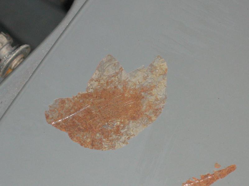

I have emailed por, waiting on their reply, but i think if i go over the car and find all the dodgy bits, scrape them off then metal ready etc.. again then it will hopefully be ok (from what i have seen though it certainly doesn't support their claim it sticks better to rust than a metal ready treated surface.. see the pic attached.

Your pic looks like you didn't take the loose rust off-and the POR didn't saturate the area. The order of events that I use are:

got a lame responce from the POR distributer for australia saying i either didn't dry the surface properly (i didn't POR on the same day as cleaning), or that the por wasn't applied thick enough (i used a paint brush..). I thought POR was meant to magically absorb moisture from the metalwork?!
there was definately no loose rust, you can see n the last photo that there are ares of converted rust right next to the bad rust..i could understand if there were patches by themselves..
