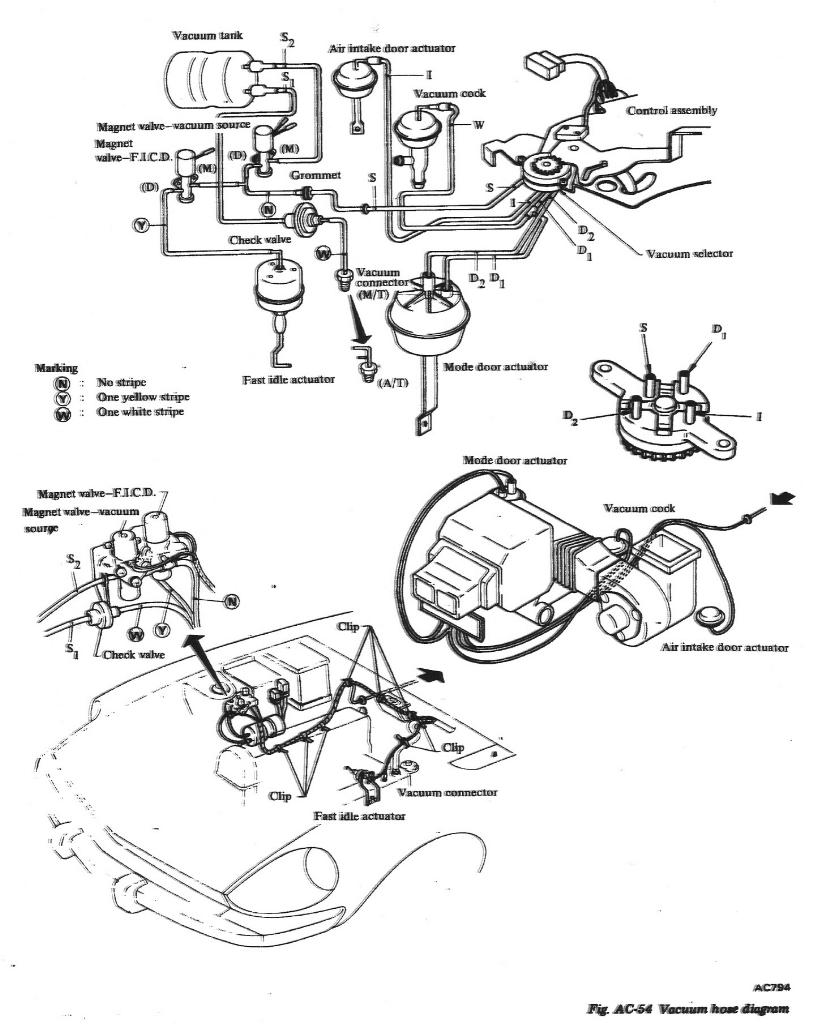

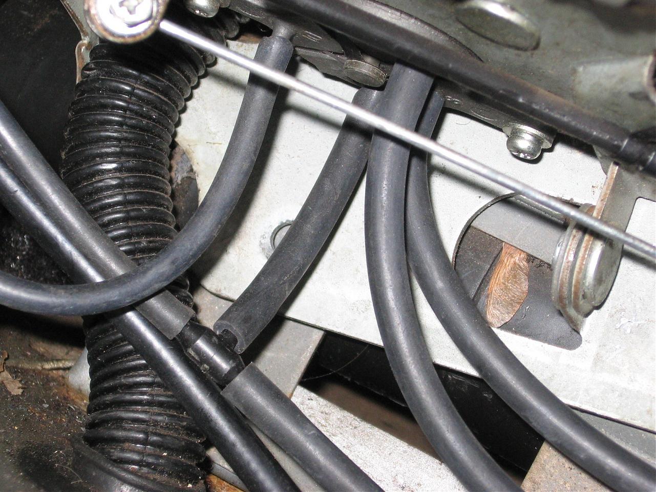

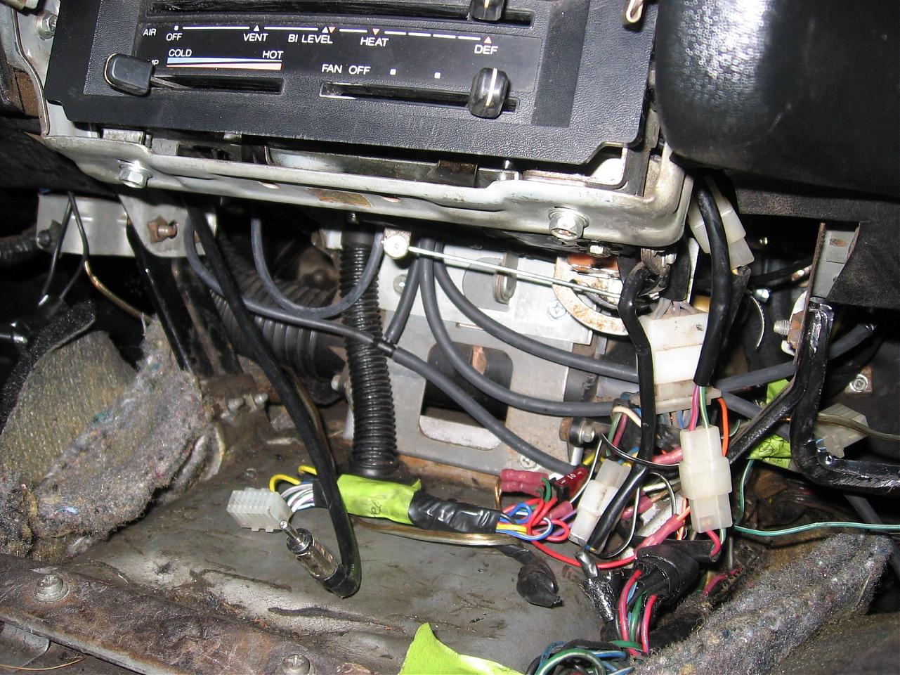

As far as ebay goes..get in line . The heater problem is most probably caused by a vacuum leak in the tubing. I attached a couple of pictures of the manifold where the lines attach. Check the mode door acuator and the linkage to the lower vents also . A hand vacuum pump and an FSM helps to trouble shoot leaks . I find it easier to just pull the console and dash out to get to everything . Jim

That is a good vacuum hose diagram, but a little hard to see. Any way to clear that up a bit Stephen?
