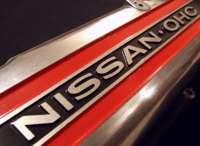

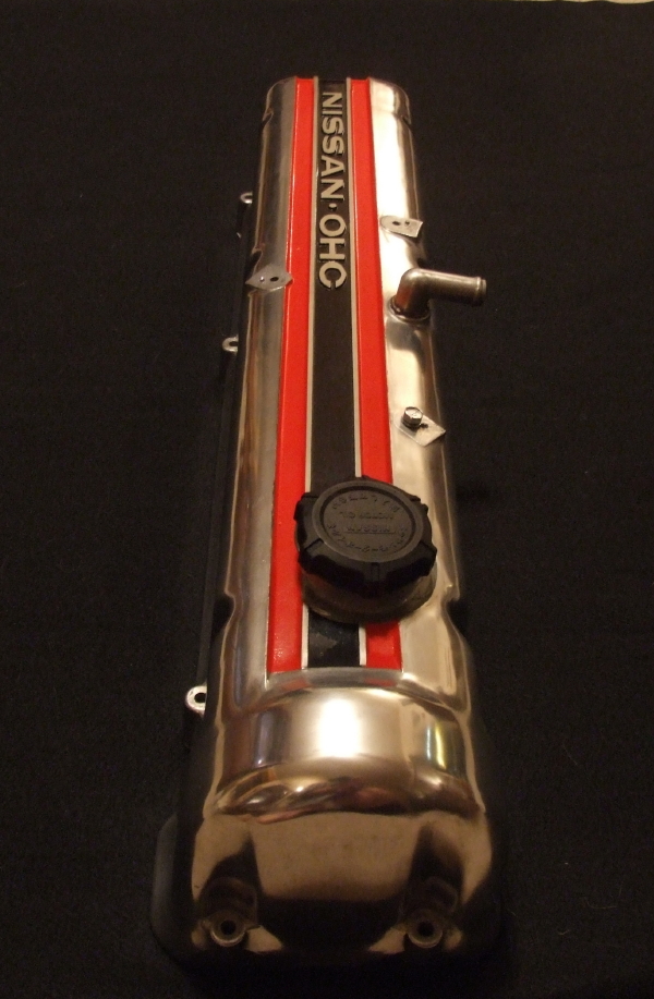

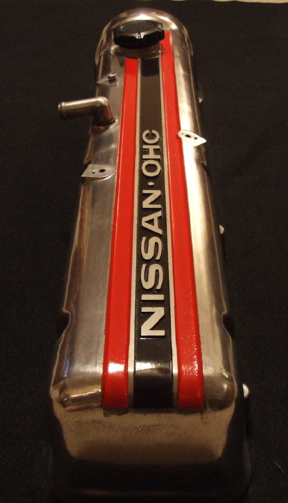

Here are a few shots of a valve cover semi-polished, done to a medium/soft shine. Took it down to 1000 grit, then several passes with Mothers aluminum polish by hand. I did not want extreme shine, rather a nice bright soft lustre, therefore I stopped at 1000. Taking another pass or two up to 1500 will provide a more brilliant reflection as I hope you can contrast when other pictures are provided.
Please see my picture gallery for a lot more examples of the type of refurbishing that can be done to these cam covers. (http://www.classiczcars.com/photopost/showgallery.php?cat=500&ppuser=9676) Time consuming, yes, but I really enjoy doing them. I've also been experimenting with media blasting with IMHO very attractive results. I am considering doing this part-time as a service (more so the media blasting as pictured in the gallery).
