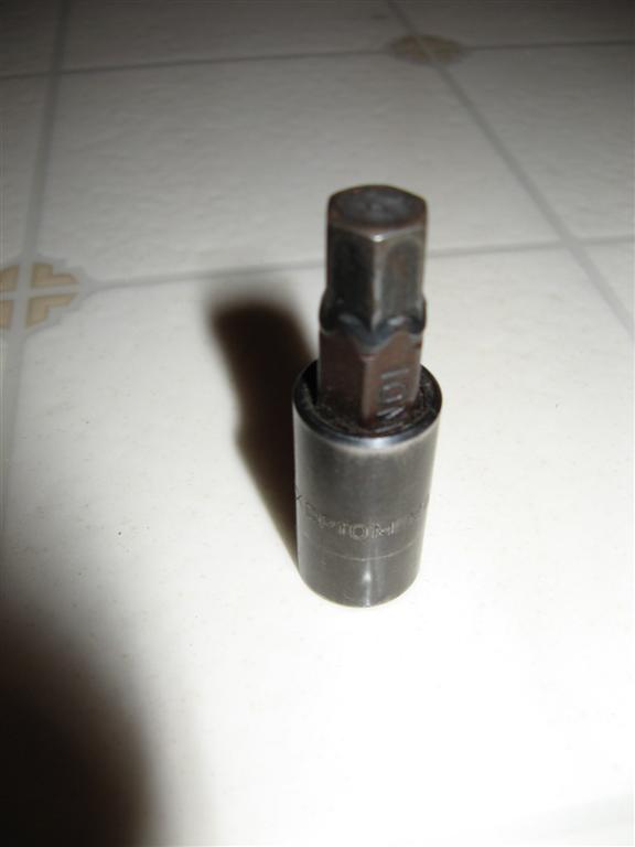

October 21, 200816 yr comment_263991 Don't mean to bring this thread back to the head gasket, but i wanted to ask Stevef1972z a question. What tools did you need to pull the head off and how did you assess any issues with the chain, since my biggest concern is the timing chain as well. The only specialty tool you need to pull the head is a 10mm allen wrench socket for the head bolts. I bought this one years ago when I replaced my head gasket. Be very careful wedging the timing chain tensioner; I learned that the hard way. Even though the FSM shows a special tool you can make a wedge out of a block of wood or use a screwdriver handle as others have suggested. You'll also need a torque wrench to properly reassmble. Link to comment https://www.classiczcars.com/forums/topic/28649-new-guy-needs-help-head-gasket-blown/?&page=2#findComment-263991 Share on other sites More sharing options...
October 22, 200816 yr comment_264036 Plastic tent pegs are exactly the right size and length for holding the tensioner in place, and unlike wood, won't splinter. Link to comment https://www.classiczcars.com/forums/topic/28649-new-guy-needs-help-head-gasket-blown/?&page=2#findComment-264036 Share on other sites More sharing options...
