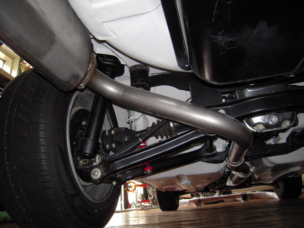

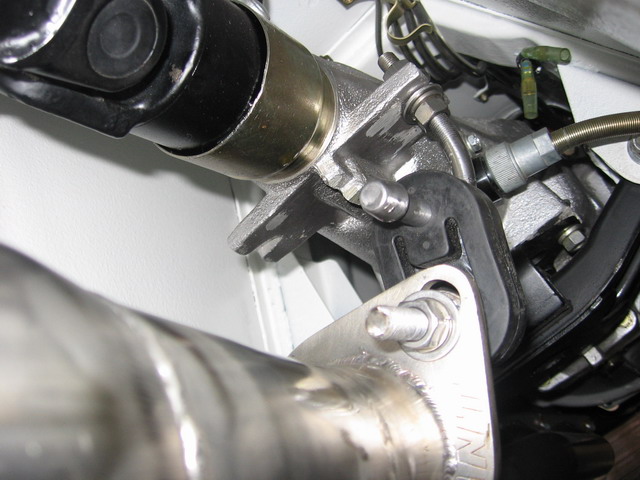

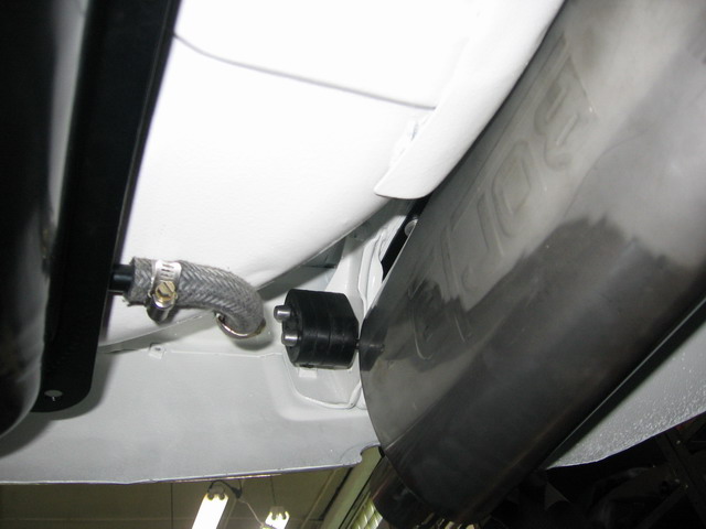

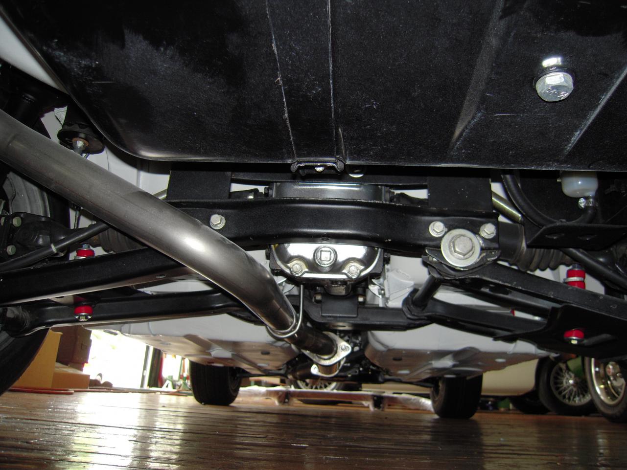

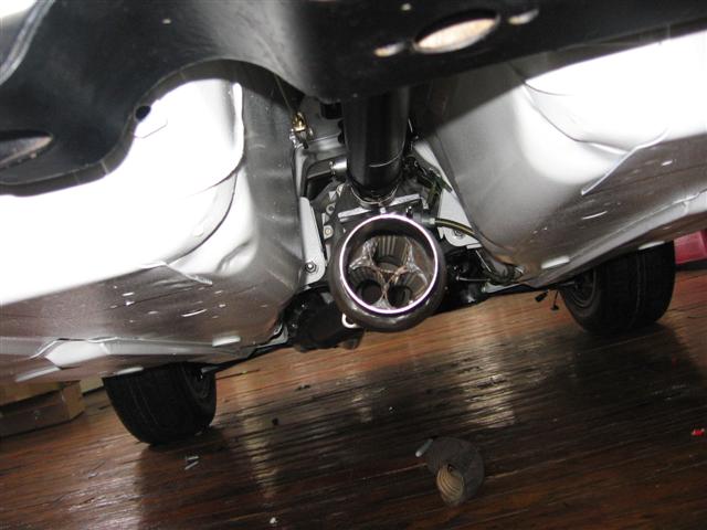

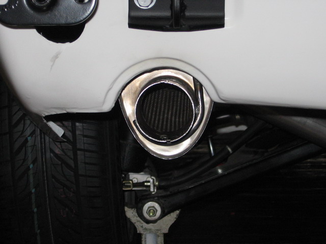

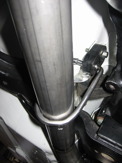

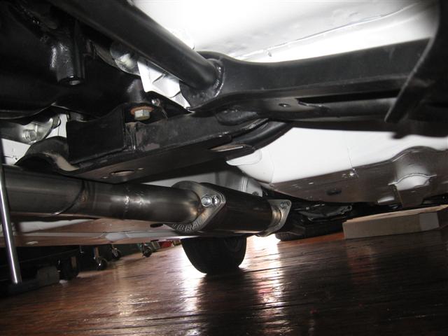

Since I could not find a stainless steel exhaust system, I sourced the parts and had a system fabricated for this early '74 260Z. The system under construction is shown in the attached photos. The muffler, resonator and pipes are from Borla. Flanges are from Vibrant. Two rubber hangers are used per hanger rod. The fabricator used by MSA mandrel bent the "S" pipe for me. System diameter is 2.25". The muffler tip will be added after the bumper is installed.
The parts can also be obtained in 2.5" diameter.
Regards,
Fixitman
The attachments show the individula parts and part numbers. The resonator is actually a Borla XR1 bullet muffler. It has the same construction as their complete system resonators, which cannot be purchased separately. A transition obtained from Burns Stainless (part no. RD-225-300-16-304-L) was welded to the outlet side of the XR1 to connect to the exhaust pipe. I believe the 2.25" dia. XR1 is no longer available but the 2.5" dia. can still be purchased.
I also tried Borla muffler 40652 but it was a little tight. Muffler 40658 mounts higher and has a little more room around it.
If you would like more info, let me know.
Fixitman

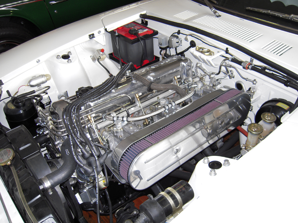

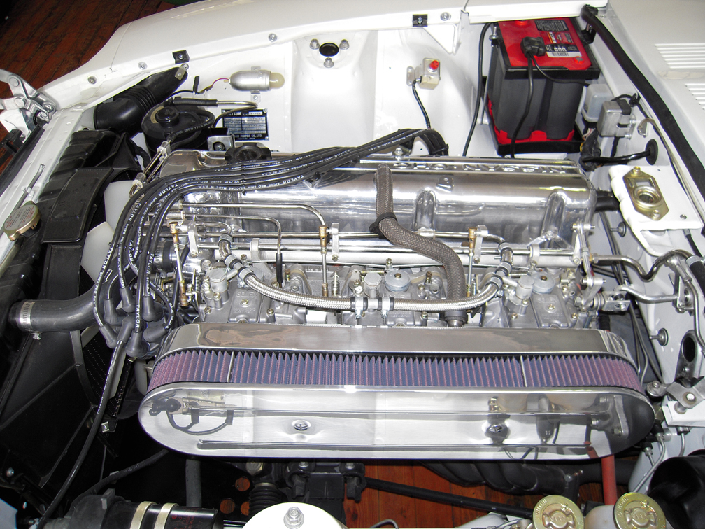

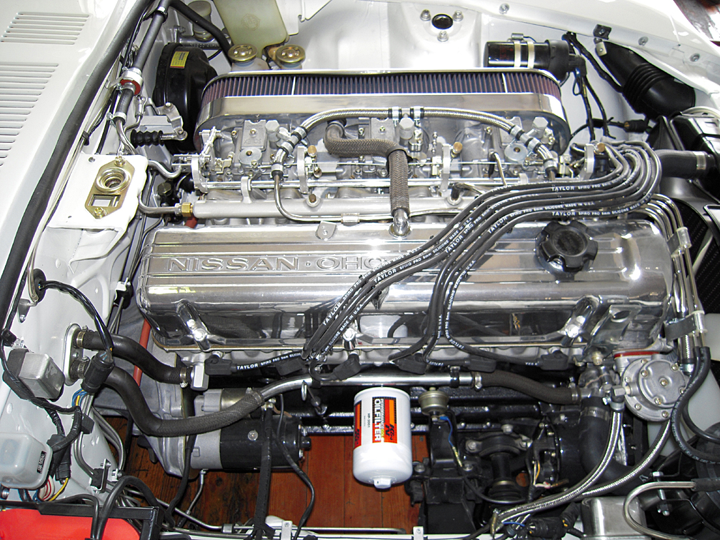

That is a very nice looking engine bay as well!
