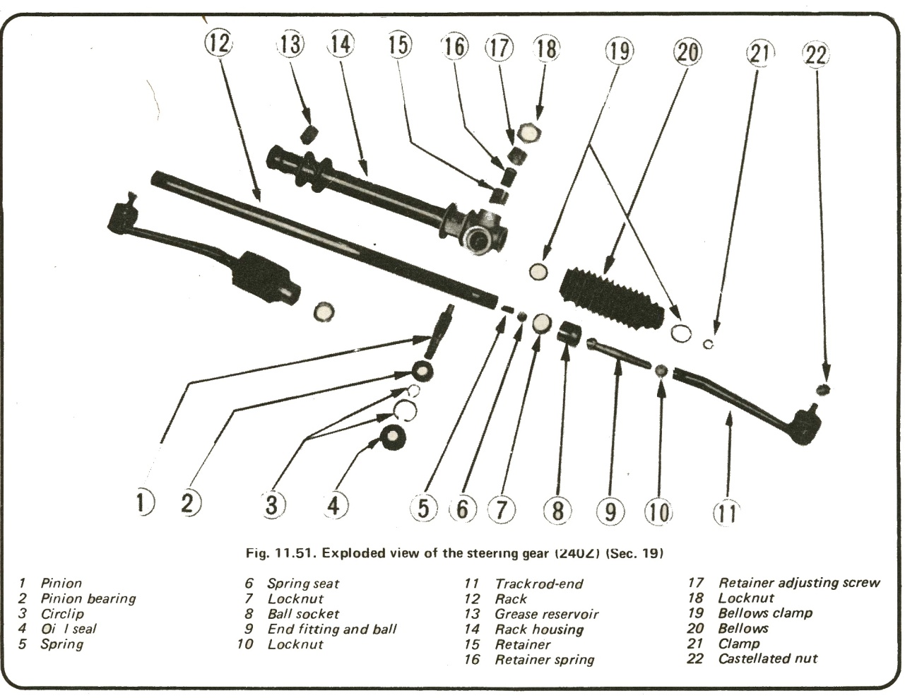

Posted August 1, 200816 yr comment_255065 So I need to know if anyone has developed a trick to removing the steering pinion without causing any damage to it. According to the FSM it says to "Draw steering pinion assembly out" but this pinion is really in there. So if anyone has a method to ease the pain in removing one of these please let me know, I really do not want to damage this. 77 280Z http://s38.photobucket.com/albums/e106/babry27/77%20Datsun%20Restoration/?start=all&mediafilter=images Link to comment https://www.classiczcars.com/forums/topic/28890-removing-the-steering-pinion-assembly/ Share on other sites More sharing options...
August 1, 200816 yr comment_255089 I assume that you have removed the adjusting nut and the spring and the bronze rack retainer? These apply pressure on the rack which side loads the pinion shaft. The pinion shaft bearings are a “light†press fit into the housing. I’ve never had a problem removing the pinion shaft on the three racks I’ve re-built. Link to comment https://www.classiczcars.com/forums/topic/28890-removing-the-steering-pinion-assembly/#findComment-255089 Share on other sites More sharing options...
August 2, 200816 yr comment_255134 I have found if you clamp a pair of vice grips to the pinion shaft splines you can then lever the pinion and bearing out with a pair of flat bladed screwdrivers bearing on the underside of the vice grips. If you are careful and lever from opposite sides simultaneously, you won't damage anything. All the above requires that you have already removed any retaining clips from the relevant parts:paranoid: Link to comment https://www.classiczcars.com/forums/topic/28890-removing-the-steering-pinion-assembly/#findComment-255134 Share on other sites More sharing options...
August 3, 200816 yr Author comment_255271 I put the steering joint back on and used that as a way to put a 18" crescent wrench against and then used a 18" large standard screwdriver and it came out but really fast and then all of the bearings went flying all over. Thanks for the tip.77 280Zhttp://s38.photobucket.com/albums/e106/babry27/77%20Datsun%20Restoration/?start=all&mediafilter=images Link to comment https://www.classiczcars.com/forums/topic/28890-removing-the-steering-pinion-assembly/#findComment-255271 Share on other sites More sharing options...
