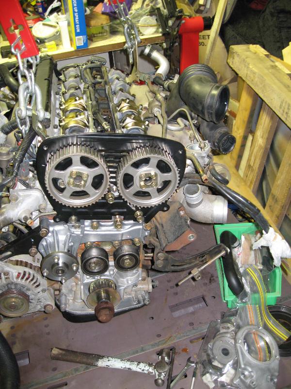

replaced Belts, idler and tensioner bearings, water pump
Installed R33 RB26DETT N1 Camshafts

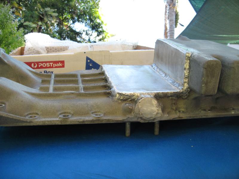

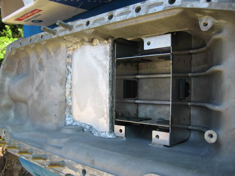

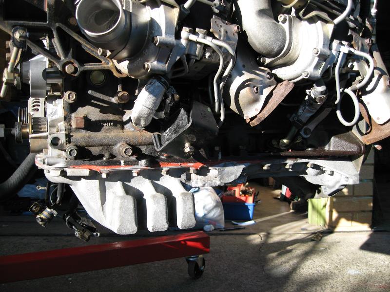

removed Front Diff from sump, cut up to clear the 240K, and had the hole rewelded in Aluminimum

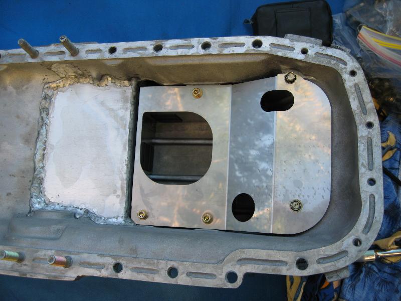

Installed Trust sump baffle (had to trim to fit)

waiting for an ATI balancer and HKS adjustable cam gears to turn up

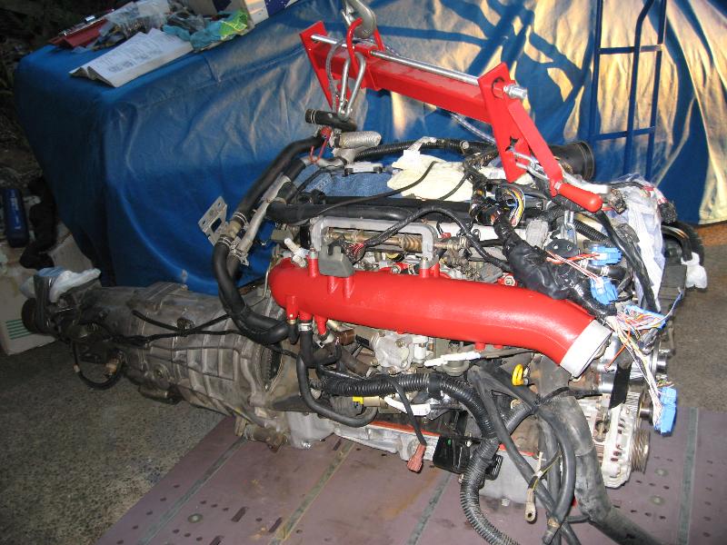

here are a few pics (and a hint as to the colour scheme of the engine, which i can hopefully reveal next weekend)

Unfortunately it is taking me a lot longer than expected to get the engine covers painted :(
My powdercoater originally had trouble matching the colour on all the panels, then his gun broke.. hopefully next weekend i will get them back and be able to show it off :)
on a happier note, i successfully repaired my crushed ECU plug with one off a spare RB25DET loom (the connectors are the same)
here's a bit of a teaser
