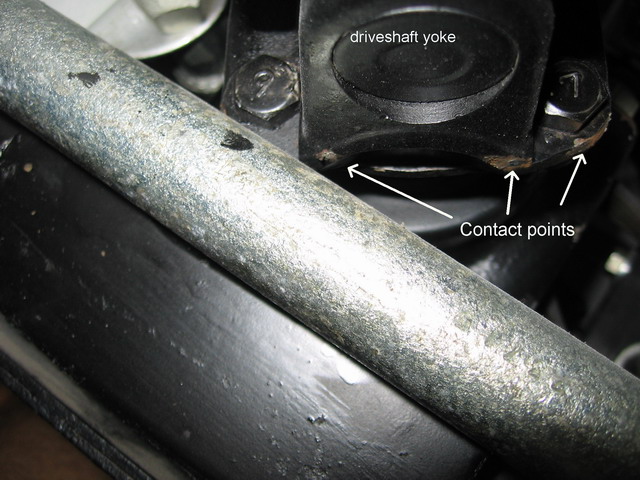

The restoration show reports that the driveshaft yoke is contacting the swaybar and making nasty noises. Could the problem be related to the drive shaft alignment caused by a high ride height (Euro springs plus Bilsteins)?
What is the purpose of the rear mounting damper plate? Is it needed?
Thanks,
Fixitman
No, neither the location of the differential or that part of the sway bar are significantly affected by ride height.
