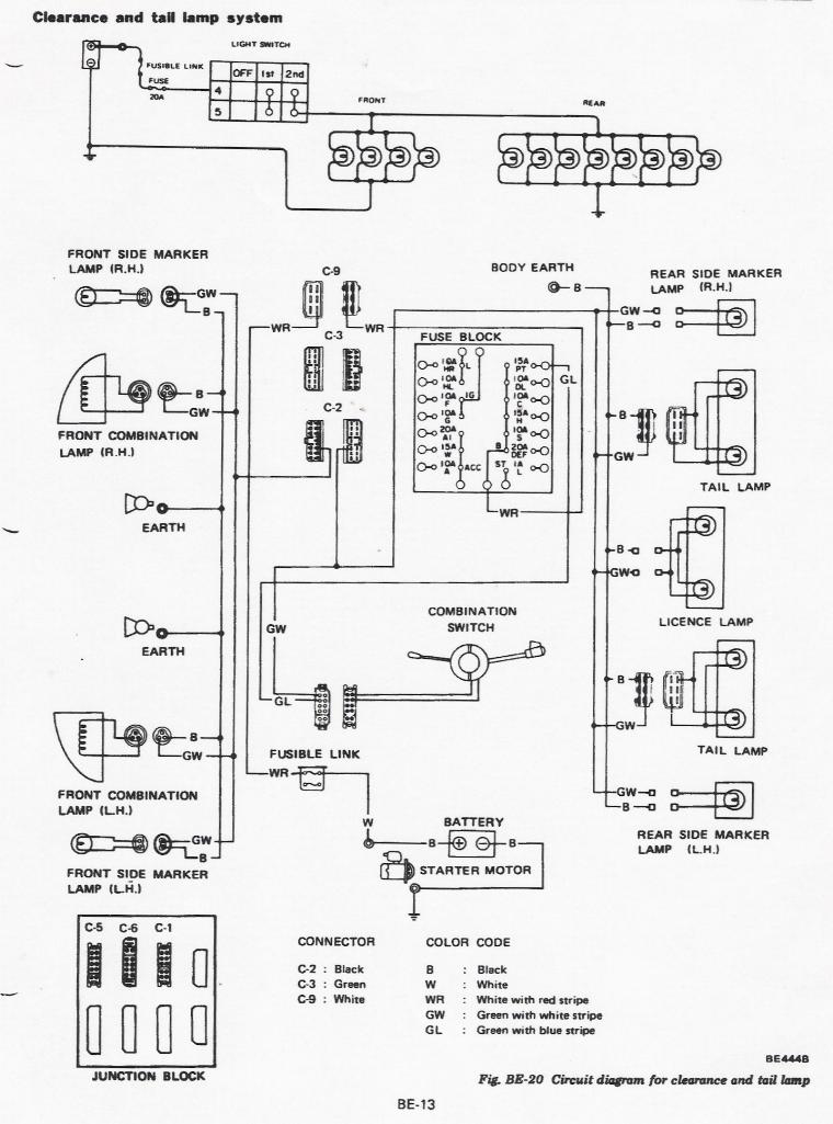

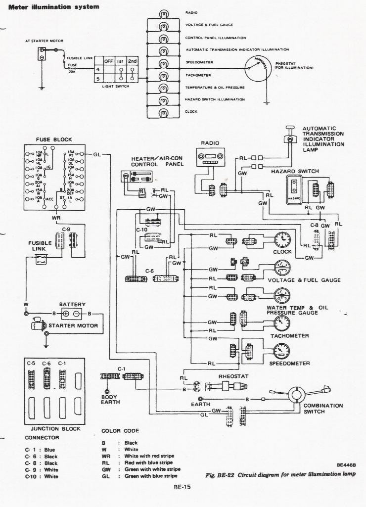

My thinking is this on my problem (I'm not trying to hijack this thread) That the Turn signal Lights and brake lights also function as the running lights, and these function normally meaning if I hit the brakes or signal they function, however when I put on my head lights the dash lights do not function nor do I have external running lights. So I can safely assume that my problem lies in my dash lighting system. correct?

If your T/S and Brake lights were the same as your running lights (Park Lights), then in the Park Light AND the Headlight position (in normal operation) the extra brightness would be caused by extra voltage (not happening) or extra current (plasible but doubtful and intrinsically prone to failure, i.e. designed to fail). It would also mean that at night, one side of your car would be totally dark while the T/S "blinked" on and off. Additionally, your side markers both front and rear would be tied in. Brake lights are not visible from the front.
The T/S and Brake lights are interwoven, both get routed through the combination switch and through the Hazard Switch.
The Dash lights and the Park Lights (secondary filament in the front and rear lamp housings AND the side markers), are part of a secondary circuit INDEPENDENT of the T/S and Brake.
Look at the wiring diagrams available, the colors of the EZ harness may not match the diagram, but the function must be there or it would have required a complete overhaul revision of the light system. The car is designed with dual filaments in the lamp housings and single filaments in the side markers.

Thanks for all the suggustions. I found the green/yellow wire that was and is agian sodtered(spelling) on top of the headlight switch. Thanks ken
Do you mean green/white? I guess that can look like yellow after 30 years.:classic:
