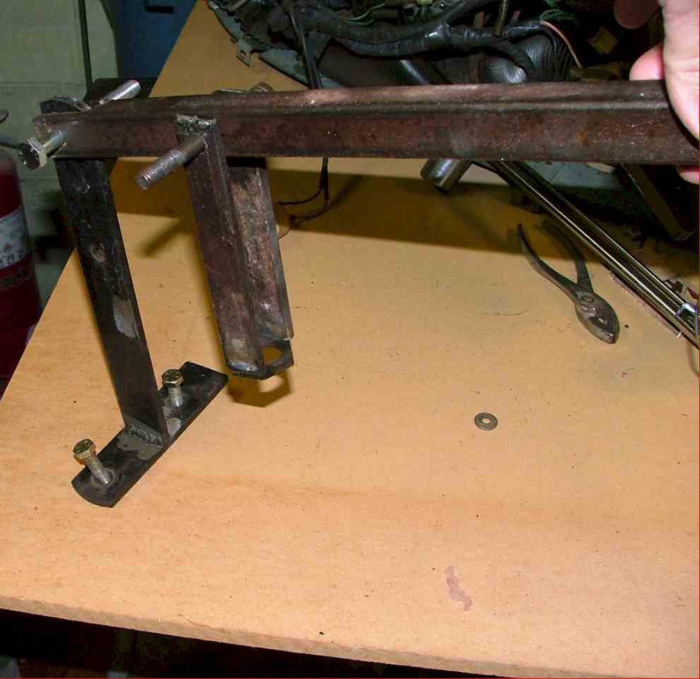

You can make a cheap valve spring compressor which bolts to your bench. Using a little ingenuity you could even make one without welding.
http://www.classiczcars.com/forums/showthread.php?t=24524&highlight=valve+spring+compressor
