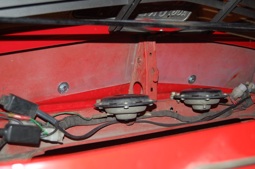

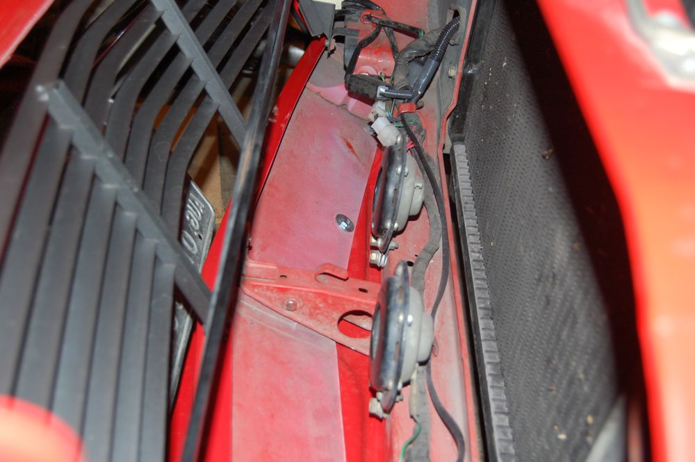

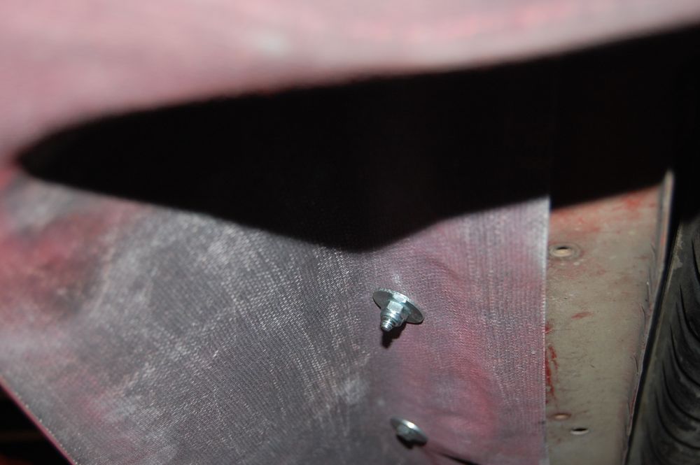

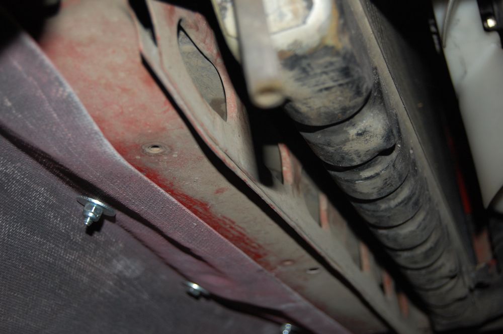

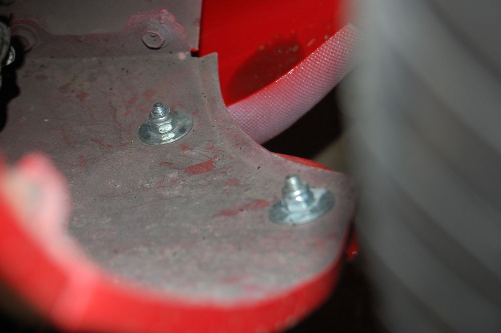

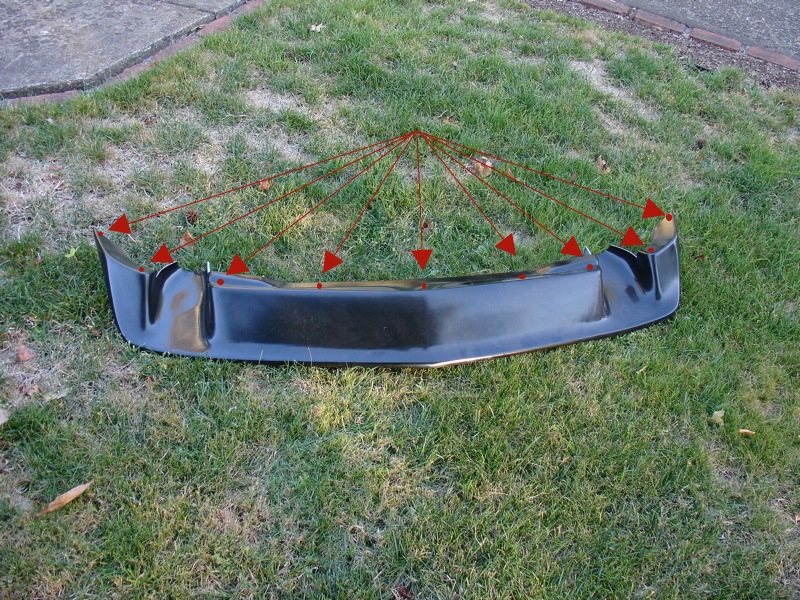

Here's what I did, others are welcome to chime in if they did something different.
I ended up with 9 stainless bolts across the front. Each bolt has a large fender washer both above and below, to distribute the stress. The first picture shows where I drilled the holes.
Edited by Arne
I'll add one detail, that I forgot the last time we posted on mounting the airdam.
I ran three beads of black seam sealer on the contact area before tightening the bolts, to keep the fiberglass from ever squeeking, and the valence from rusting because of vibration wearing through the paint/gelcoat to leave raw fiberglass and raw metal in contact(that had obviously happened on the POs installation(granted he used only five bolts for mounting), but in the interest of keeping the car for my sons to enjoy, an ounce of prevention hopefully will mean they don't have to mess with it.

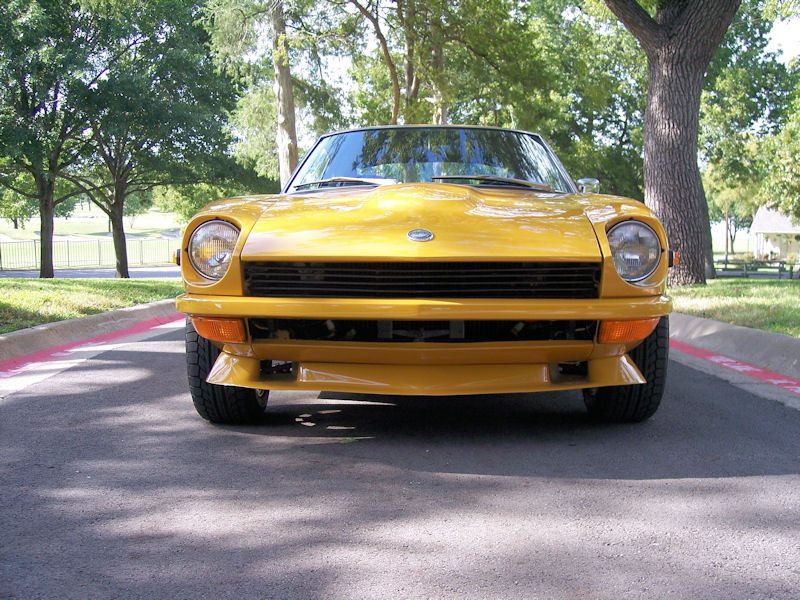

Stephan,
My Spook is a 1st-gen BRE model, used only in the 1970 SCCA competition. The design was revised to your model beginning with the 1971 season. If you have any doubts on the authenticity of my Spook, check out the vintage photos for sale on the BRE site. The John Morton car for 1970 has my model on it. I suspect the 1st-gen version did not generate adequate downforce and was more of an air dam, thus the revised version.
