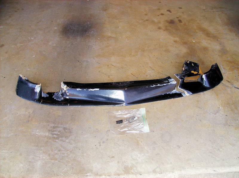

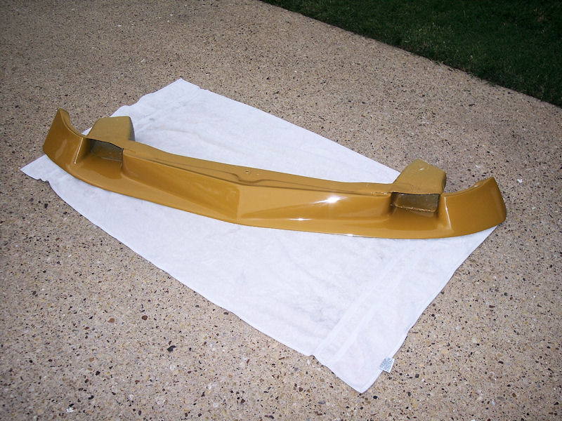

This is what happens when a spook on a lowered car encounters water in a flooded intersection. Years ago, it was ripped from the car and I recovered it after the water was gone. The right side duct was lost and a significant shatter at that point, a complete break at the left side duct, and all mount points were damaged. I removed the left duct and used it to model a foam form for the right side replacement, then did extensive glass layup to repair everything. A successful Humpty Dumpty story. :love:

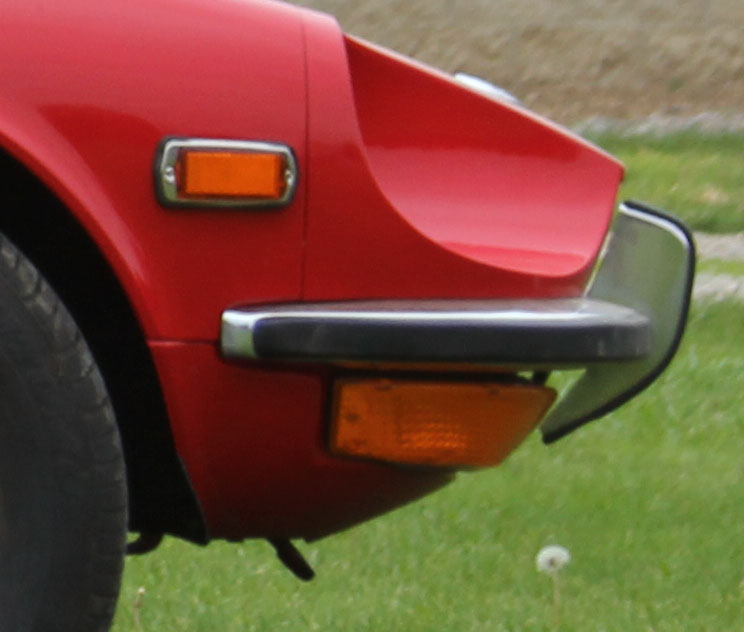

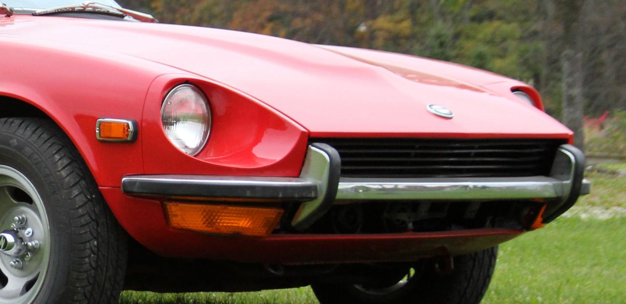

In a slightly related note; I want to get rid of the front spoiler on my car and go to the spook but I am having trouble finding worthwhile front valence sheet metal. Has anyone reproduced these in fiberglass or carbon fiber or is there a source I don't know about?
This is what I am getting rid of. I want more of a vintage look.
Les at CDM also has a fiberglass, one-piece stock replacement valance available. Had it been available when I bought my spook, I'd have bought one rather than drill holes in my stock valance.
