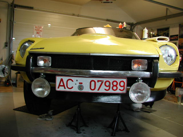

Dear god, the first picture is scary, like a pretty girl with a mouth full of crooked teeth and braces. LOL
Got enough lights there Doehring? live in the black forrest do ya?ROFL
