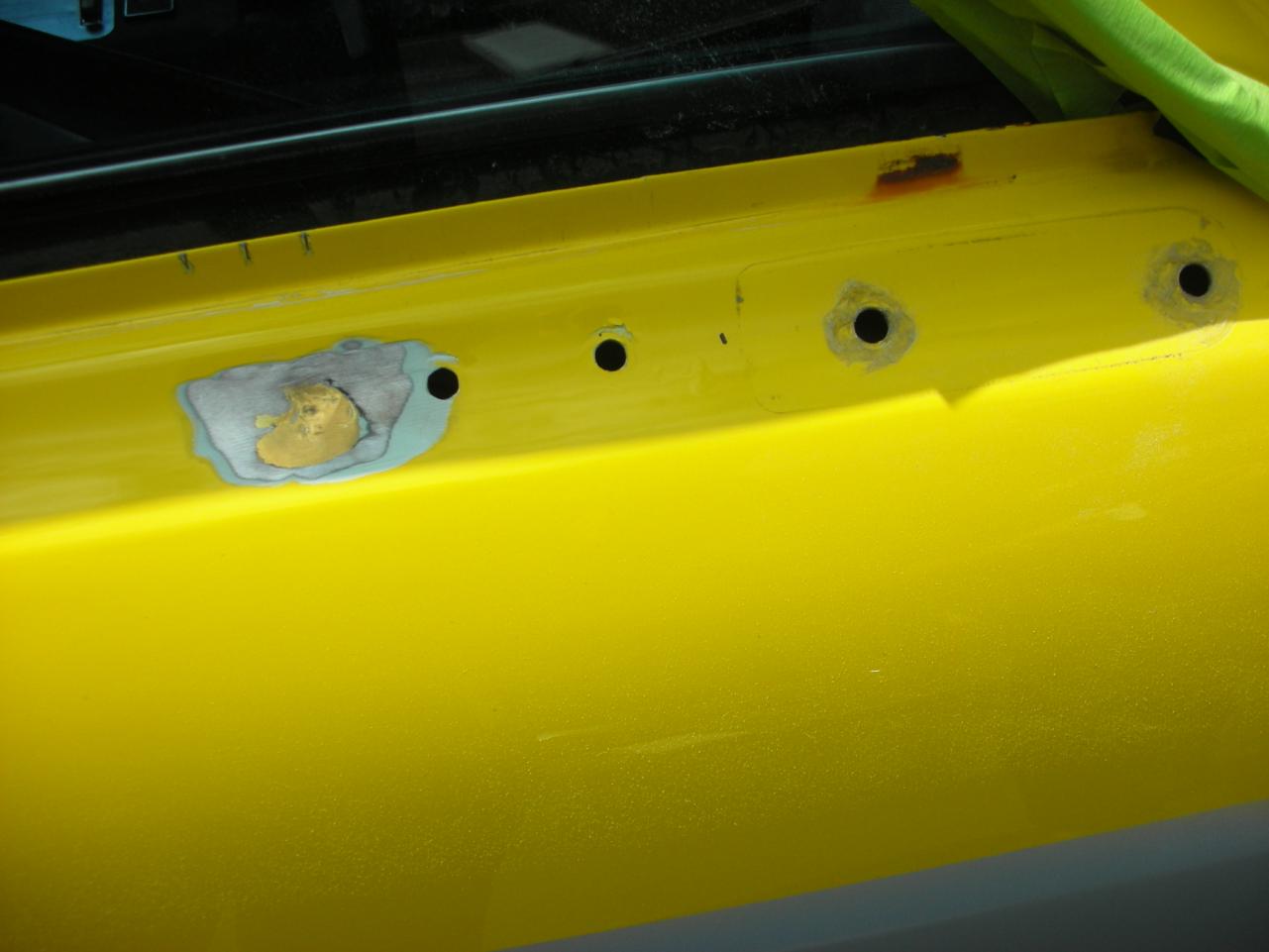

The first photo shows where the PO filled in the holes from the old mirror, and the filler he put over it did not adhere to the metal and had a bubble (as well as the new holes for the new mirror (the 2 farthest back ones)

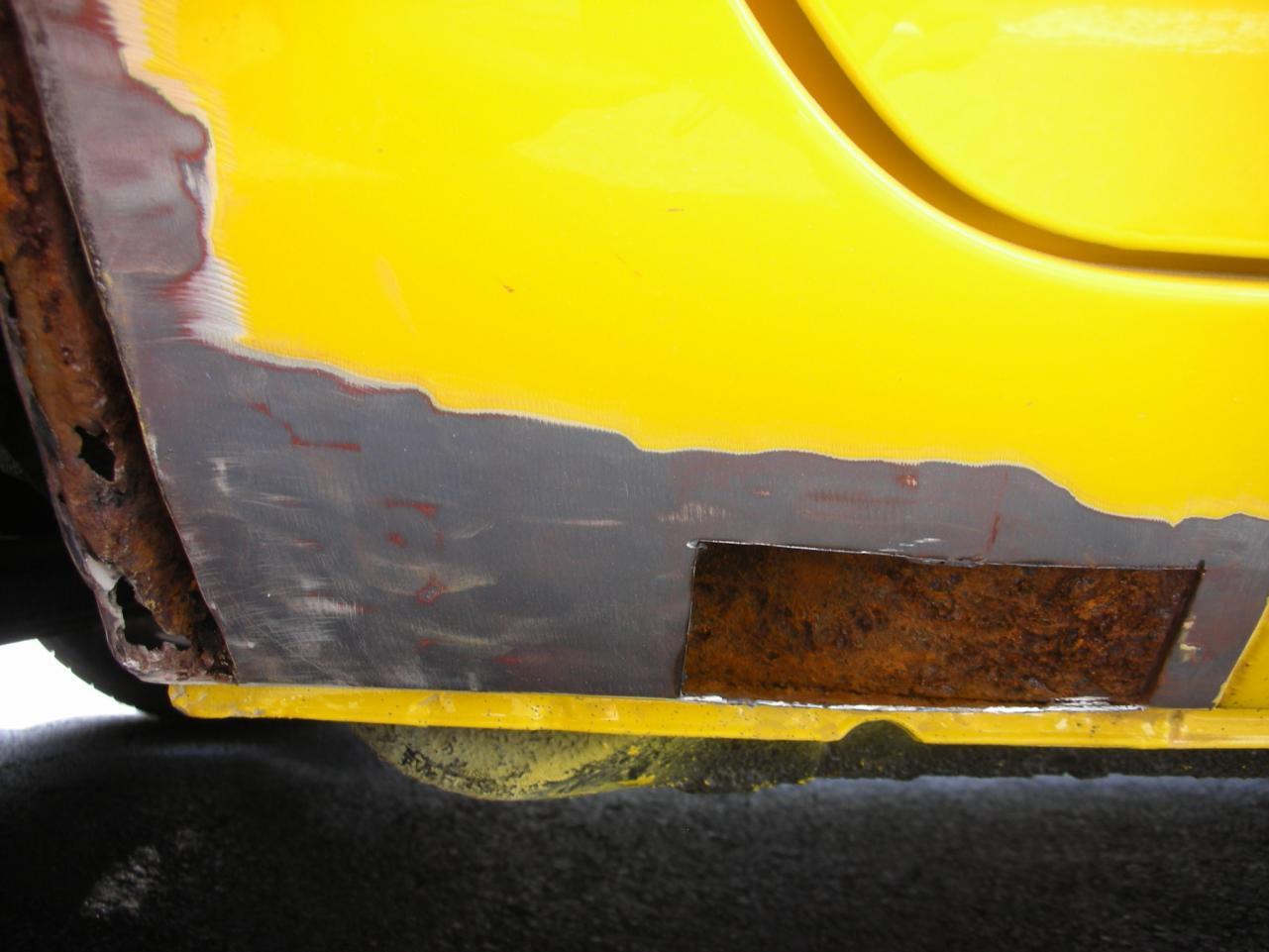

The second photo shows the surface rust behind the dogleg (looks worse that it really was) - fortunately it was still solid!

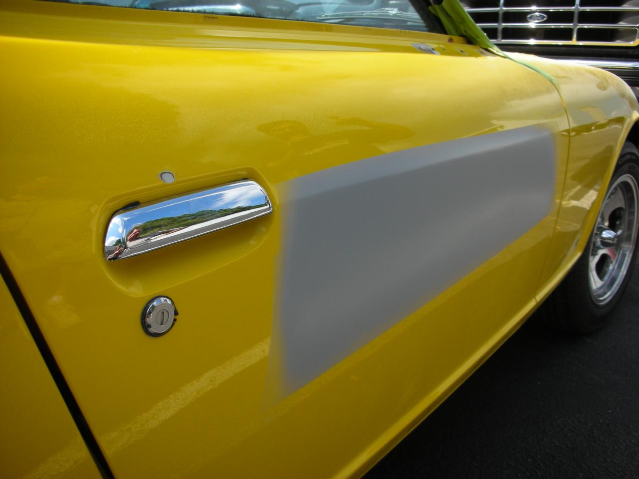

The third photo shows the door crease already repaired.

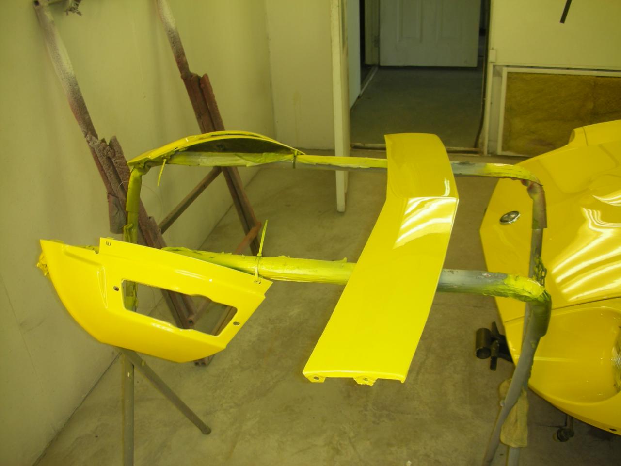

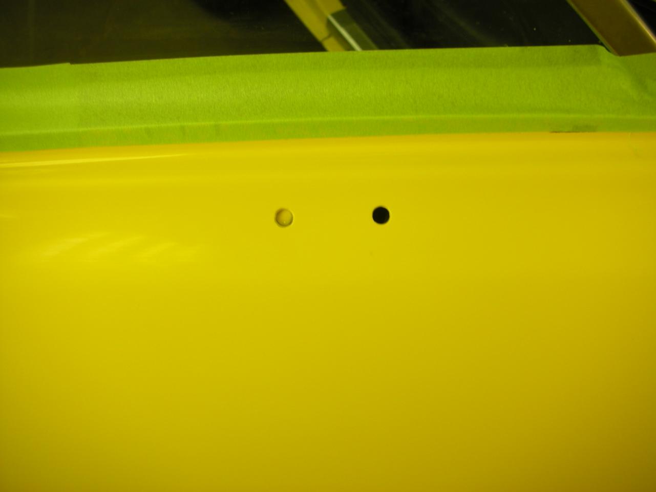

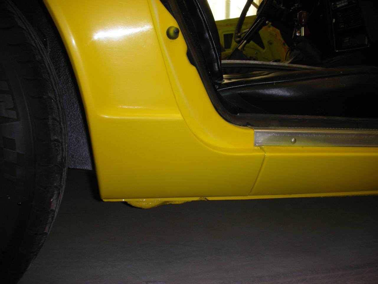

Ok, here are some more photos. It seems they painted the car, but according to them, the color was just slightly off in certain lighting conditions, so they've sanded it back and are about to put the "correct" color on the car. I think it was a good sign that they were redoing the paint before I could even see it to make sure it was perfect. Looks like it should be done early next week!
