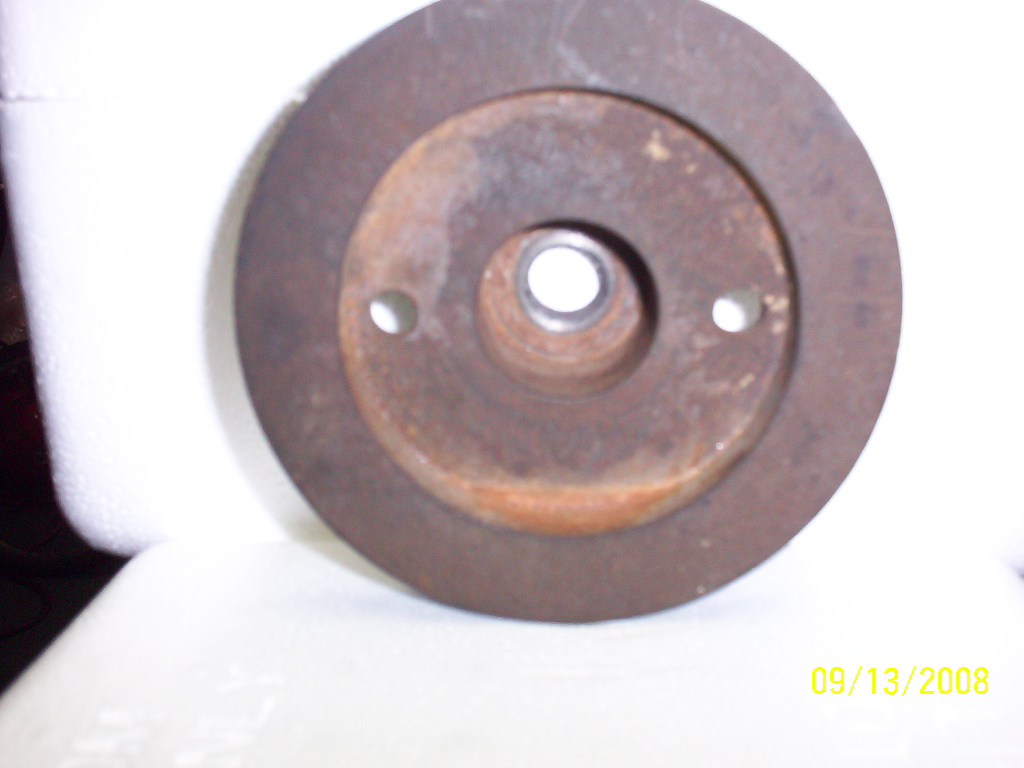

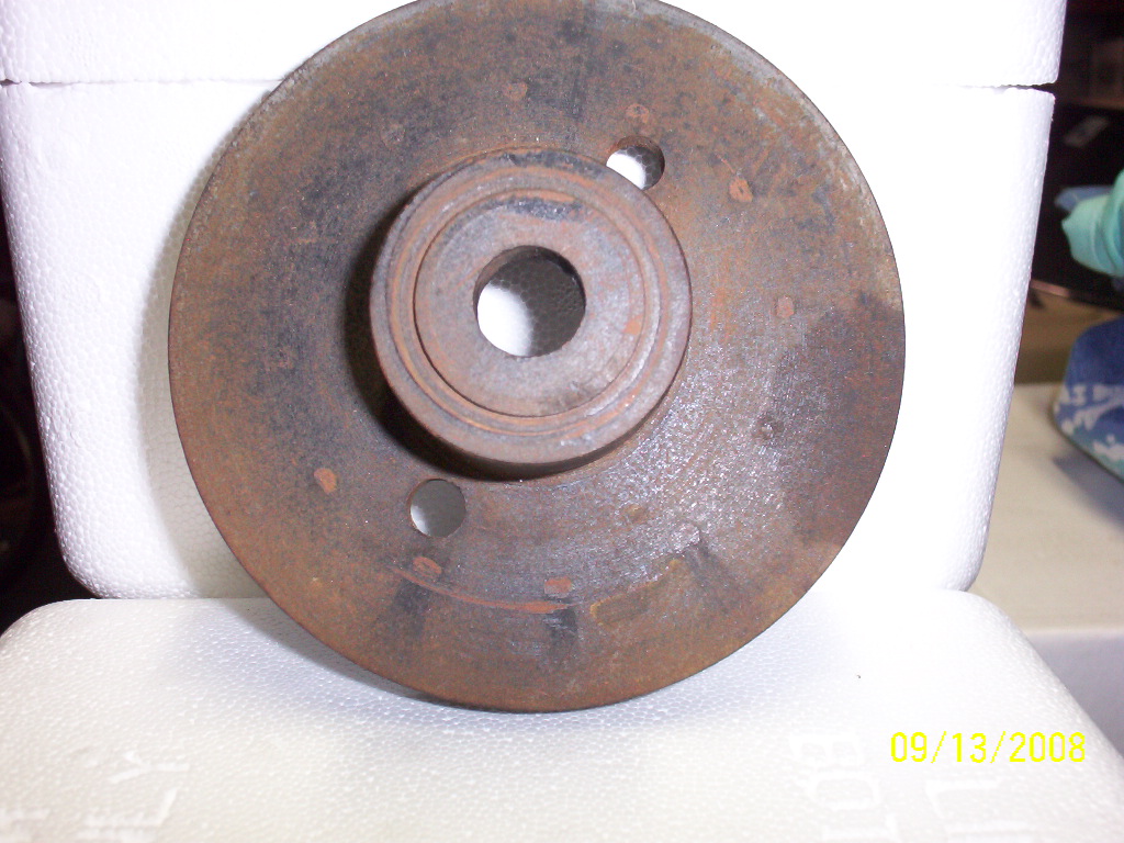

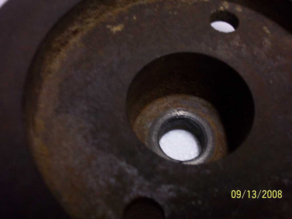

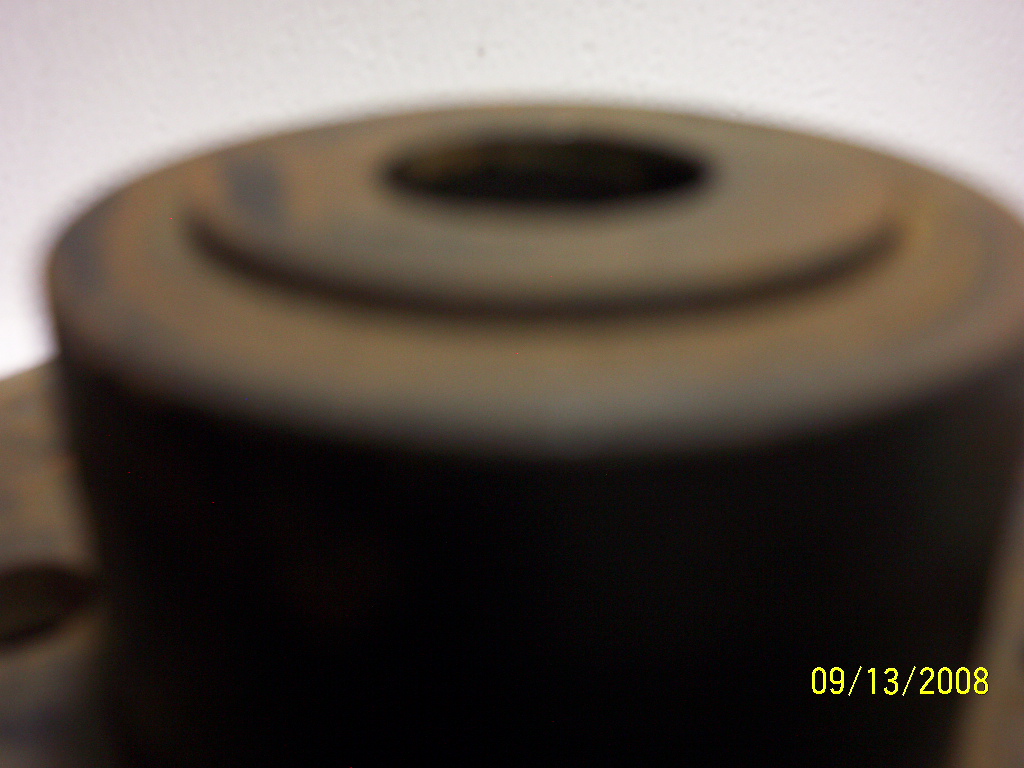

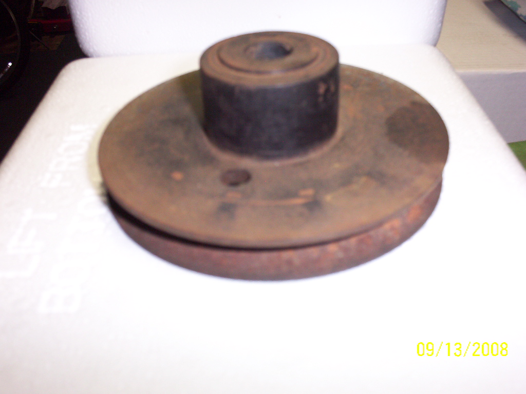

September 14, 200816 yr comment_260327 I have removed my front section. I had to fill up the space in the remaining pulley with two steel washers, one 1.35" OD., the other somewhat larger, about 1.95", with an ID of .65". The smaller washer needs to be fairly thin. The goal is to duplicate the surface that the bolt bears on with the original configuration, so that the proper torque can be achieved. Nominal thickness should be .45" The two sheave balancer is the ideal solution, but I believe they are hard to come by. ( correct me if I'm wrong) I have enclosed pics of the front pulley so you can see what you are up against. Link to comment https://www.classiczcars.com/forums/topic/29363-crankshaft-pulley/#findComment-260327 Share on other sites More sharing options...

September 14, 200816 yr Author comment_260352 Perfect. Thanks for the pics. I'll be sure to check that the original bolt isn't too long before I put it together. Nothing like taking 1/2 pound off the crank for free.Ted. Link to comment https://www.classiczcars.com/forums/topic/29363-crankshaft-pulley/#findComment-260352 Share on other sites More sharing options...
