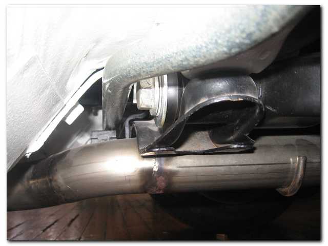

Does any one have a photo which shows an installed differential damper? The shop tells me the rear sway bar is hitting it as it rotates. I want to make sure the damper, as shown in this photo, is properly installed .

I'm not sure I understand your comment. Depending on which way it's rotating, the swaybar is either hitting the drive shaft yoke or the differential damper as the rear suspension travels up or down. I was wondering if the damper should/could be rotated 180 degrees, so that the vertical section is behind the differential cross member.
The shop replaced the Euro Stage 1 springs with the original factory springs this week. The rear ride height came down to factory specs with a full tank of gas. So ride height isn't an issue now.
Your thoughts?

First of all, your damper is mounted backwards. The rubber part goes toward the rear of the car. Secondly, I also think your sway bar is upside down as the curved part is there to allow for clearance between the bar and the driveshaft/yoke. That must be and aftermarket bar. The stock bar is straight so it clears without hitting anything.

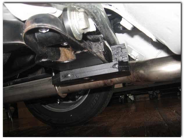

The bar is by Quickor, 7/8" dia. What rubber part are you referring to? Do you mean the stacked metal plates of the damper? The attached photo shows the sway bar from the other side.

The stacked metal plates are referred to as a vibration dampener (correct spelling for search purposes). There are a few different designs, put together by the dealerships, on a customer complaint basis. There are some posts here covering them. Have you tried removing it to see if it's even needed?
