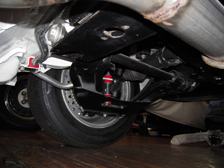

September 19, 200816 yr comment_260895 You really don't have a good enough picture to determine if yours is right side up or not. The stock one in my pic is orientated so you would only need to raise it up and mount it. You can see on mine where it has a slight bow in it from constantly bottoming out on it. So there wasn't enough rotational clearance on this one either. Another 2" of link will only gain about 1/4" additional clearance. It's only a half hour job to flip it if need be. I'm sure you will have this worked out in short order and when you do, be sure to post a pic or two of the correct mounting here for future reference, Good Luck. Link to comment https://www.classiczcars.com/forums/topic/29405-differential-damper/?&page=3#findComment-260895 Share on other sites More sharing options...
September 19, 200816 yr comment_260907 all this talk about the 'boat-anchor-heavy' damper...just get rid of it...you'll never know the 'diff'-rence. i think mine is mooring a lobster boat out in the bay somewhere....$0.02 Edited September 19, 200816 yr by 7277 Link to comment https://www.classiczcars.com/forums/topic/29405-differential-damper/?&page=3#findComment-260907 Share on other sites More sharing options...

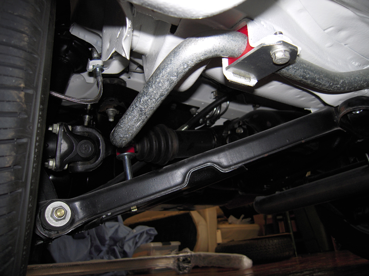

September 19, 200816 yr Author comment_260909 Geezer, perhaps these photos will provide a clearer view of the sway bar installation. Since the arms bend up at the links, just like the factory bar, I think it is installed correctly. Do you agree? Fixitman Link to comment https://www.classiczcars.com/forums/topic/29405-differential-damper/?&page=3#findComment-260909 Share on other sites More sharing options...
September 19, 200816 yr comment_260924 Geezer, perhaps these photos will provide a clearer view of the sway bar installation. Since the arms bend up at the links, just like the factory bar, I think it is installed correctly.Do you agree?FixitmanI do agree, I don't think it would even be possible to get the bar mounted upside down. Those pics show it very well. Link to comment https://www.classiczcars.com/forums/topic/29405-differential-damper/?&page=3#findComment-260924 Share on other sites More sharing options...
September 19, 200816 yr Author comment_260969 The link spacers worked. The interference is gone.Thanks to all for your input and help.Fixitman Link to comment https://www.classiczcars.com/forums/topic/29405-differential-damper/?&page=3#findComment-260969 Share on other sites More sharing options...
