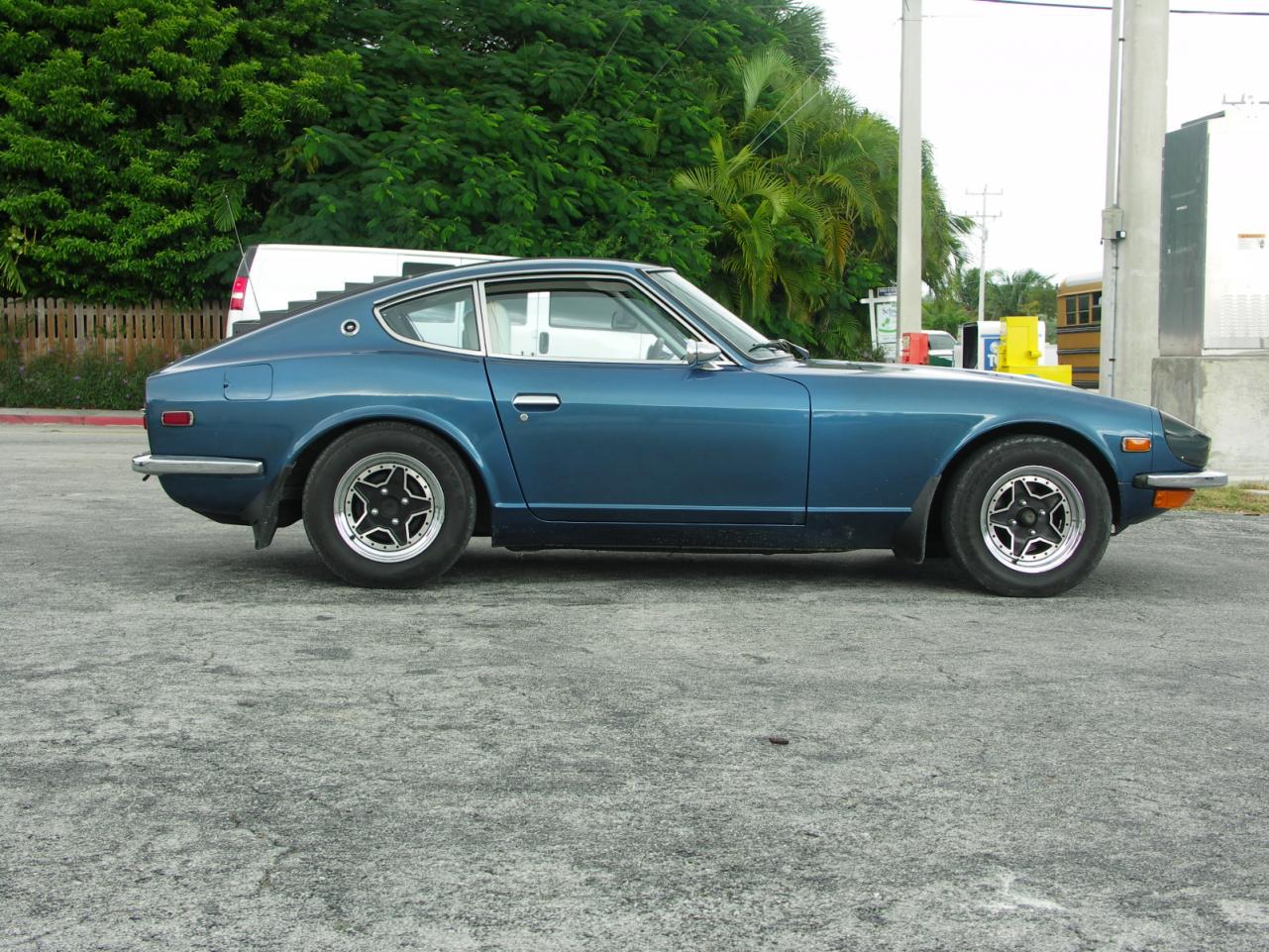

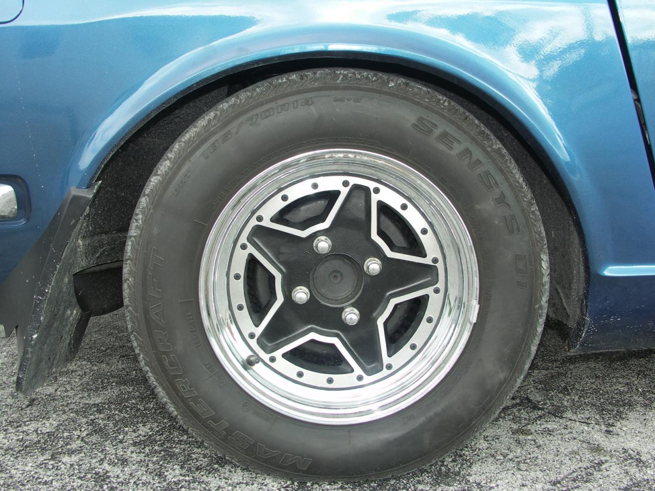

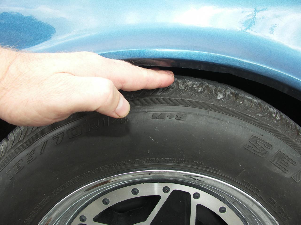

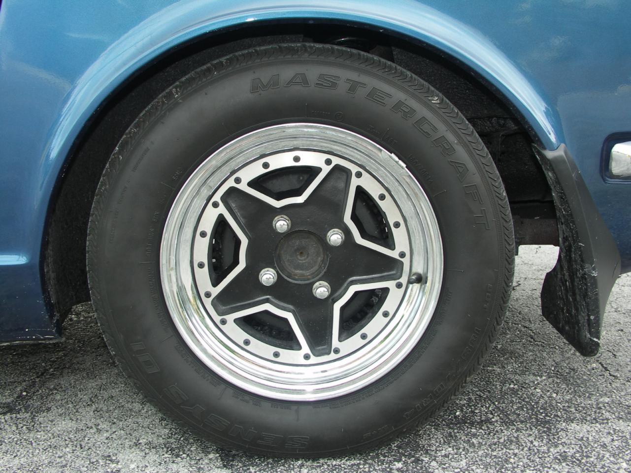

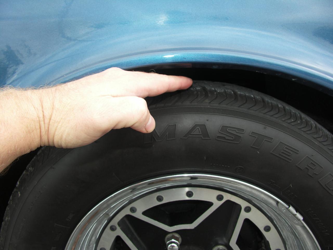

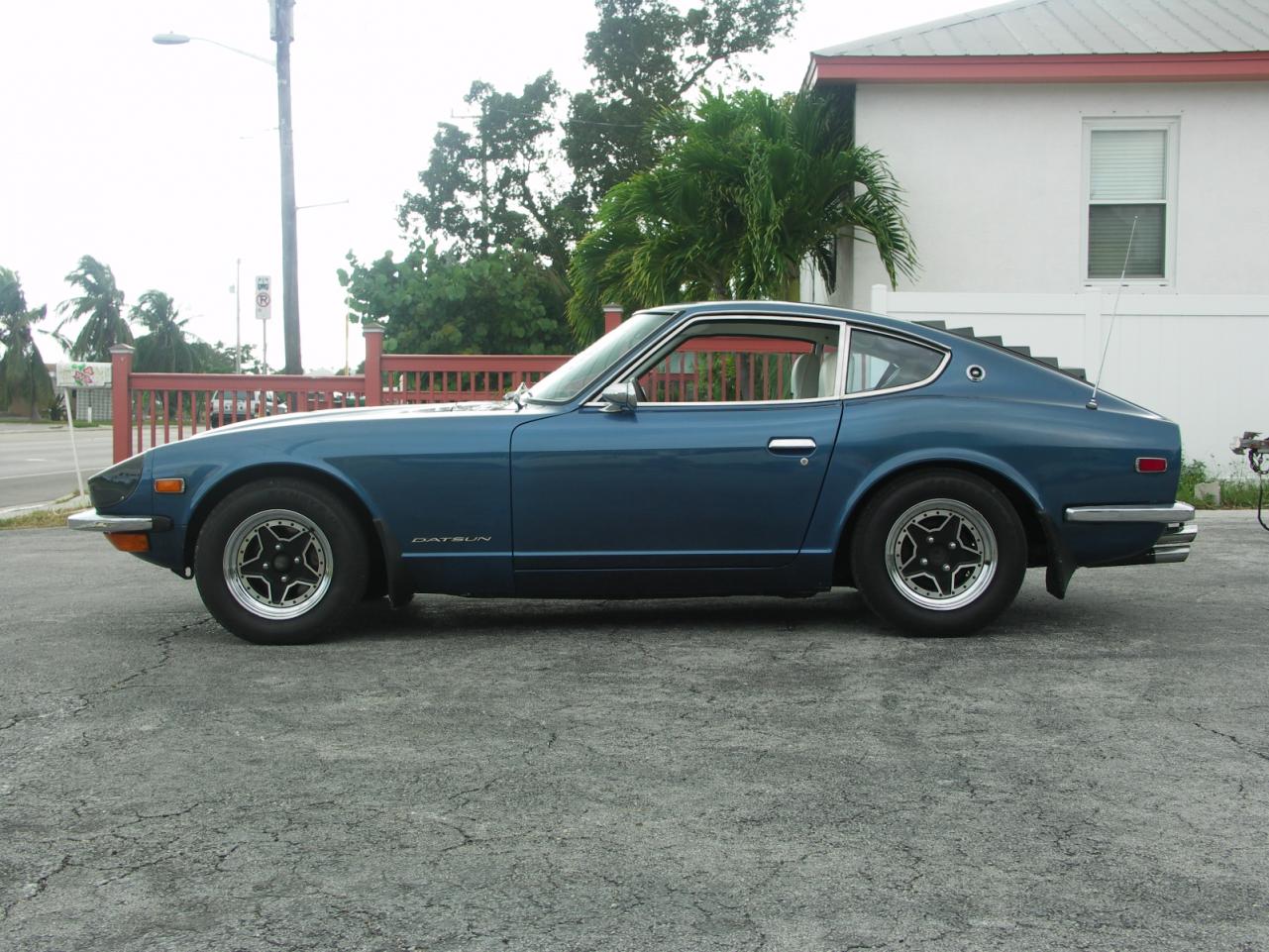

November 12, 200915 yr comment_300186 The attached explain what I'm talking about. How normal is this? Admittedly, the difference between the height of the left rear and right rear isn't much, but the right rear is definitely lower than the left rear. Maybe I'm being too picky, but I'd like the car to be level. I will say that it now rides a lot better. The old strut inserts were so worn out that I could push the piston in with one finger, and it then won't come back out on its own! The car now feels more sure of itself accelerating through corners, and it the struts don't bottom out any more. It is now obvious how bad the tires are. Gotta make a decision on keeping the wheels, first. That'll be another thread subject. Edited November 12, 200915 yr by ConchZ Link to comment https://www.classiczcars.com/forums/topic/29421-a-little-eibaching-help-please/?&page=3#findComment-300186 Share on other sites More sharing options...

November 13, 200915 yr comment_300223 The attached explain what I'm talking about. How normal is this? Admittedly, the difference between the height of the left rear and right rear isn't much, but the right rear is definitely lower than the left rear. Maybe I'm being too picky, but I'd like the car to be level.I will say that it now rides a lot better. The old strut inserts were so worn out that I could push the piston in with one finger, and it then won't come back out on its own! The car now feels more sure of itself accelerating through corners, and it the struts don't bottom out any more. It is now obvious how bad the tires are. Gotta make a decision on keeping the wheels, first. That'll be another thread subject.Wish I could help with the ride height. Pure speculation but maybe one of the insulators settled more than the other side? Maybe the springs need to settle some more? The car is looking really good!I am diggin the 14s! Those are definitely old school cool. I have 205/60R14 on my car. If I can swing it, I'll be getting a set of 16" Fortran wheels. They are total old school Japanese wheels and pretty hard to find. Link to comment https://www.classiczcars.com/forums/topic/29421-a-little-eibaching-help-please/?&page=3#findComment-300223 Share on other sites More sharing options...
November 14, 200915 yr comment_300313 If it isn't rubbing, my guess is the left side settles to the right side height after a while. Link to comment https://www.classiczcars.com/forums/topic/29421-a-little-eibaching-help-please/?&page=3#findComment-300313 Share on other sites More sharing options...
November 14, 200915 yr comment_300342 Did you actually measure both sides at the bottom of the rockerpanel? Maybe it's not the height of the car that is off... Link to comment https://www.classiczcars.com/forums/topic/29421-a-little-eibaching-help-please/?&page=3#findComment-300342 Share on other sites More sharing options...
