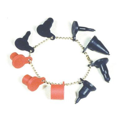

you can clamp the softer hose and buy a brake line stopper from a specialty shop. It has 2 metal fingers that go on the hardline and has a rubber stopper that goes into the line to stop air from bleeding into the system and fluid from coming out. It'll make bleeding a little easier.
Or there is this one from Matco Tools.....
You can also get a stick and wedge it between the steering wheel and brake pedal or seat and brake pedal to push the pedal down 1/2 way. This is like putting your finger on the straw and pulling it out of the liquid. Air can't get in from the top so brake fluid won't drain out the bottom. Still need to bleed the brakes after, but there won't be as much air as there would if you just left the lines open.
