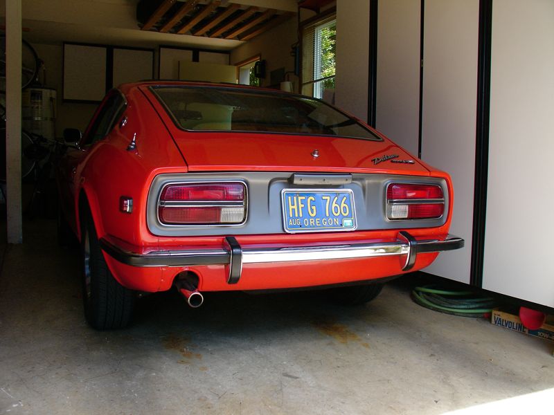

I just got mine out of the body shop (it was in for 400 days). I purchased two cans of rear tail light finisher from Les at Classic Datsun. I took one to my paint tech that painted the car and he mixed the color based on the PPG computer. The final was a very nice color and I though the match was extremly close, if not on the money. Let me know if you are interested and I can get the PPG paint code and share it. Les charges 27.00 per spray can + shipping. I'm sure the PPG paint will last longer and handle the UV rays better than a rattle can. If you need a spray can I can sell you the one I have (unused) for less than the cost of a new one.

Les' paint is not normal rattle can paint. It is custom mixed auto paint loaded into aerosol cans. Not Krylon or similar. I've done this in the past myself, having a local paint shop load Dupont Centari into rattle cans. I can't remember what brand paint Les told me he has mixed up before he loads it into the spray cans, but it was a familiar name and may have even been PPG.
Les' paint on my car's tail trim panels is almost two years old now, with no signs of any fading or degradation.

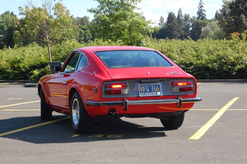

We shot the rear of my dads 72 lime car b/c the PO had done it in gloss. We used a gunmetal grey color that we closely matched and then sprayed PPG clear coat with flatener added using an HVLP gun.
From what I can tell looking at pictures, some of the cars had grey rear sections and some had black depending on the exterior color.
It may be an optical illusion but it appears Kats cars have the two different color rears. Maybe he can elaborate.

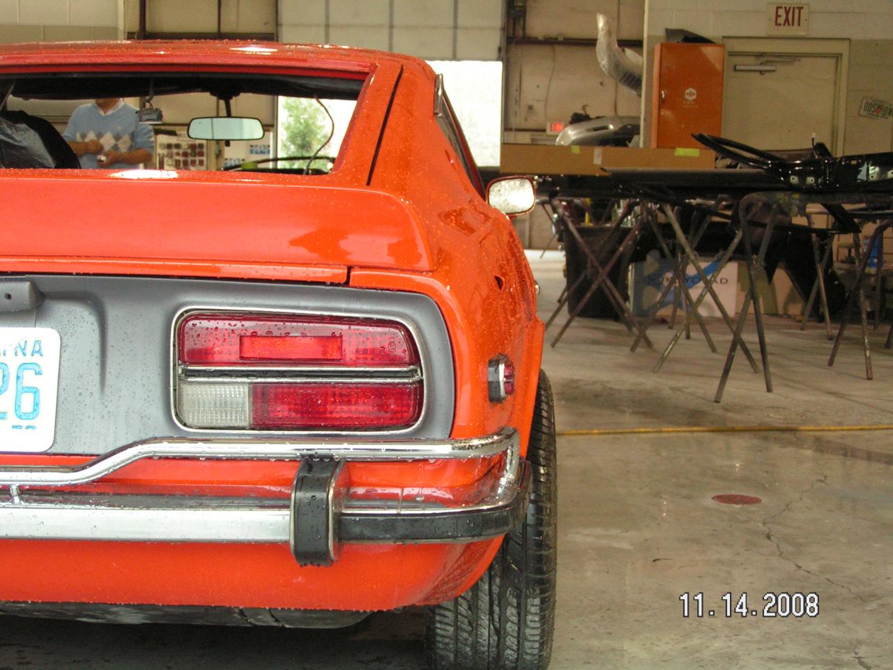

Nice job! Thanx for the offer on the paint. I believe my paint man has already painted it. He said he had used a satin finish on it. I might have misinterpreted what he said. If I did I will probably contact you. From what you guys have been saying, I take it that the finisher is Plastic??? Amazingly enough, I don't think I really ever looked at it in the 2 years I've been working on her. I've been so busy running down all of the other demons in, on and under her:stupid:
