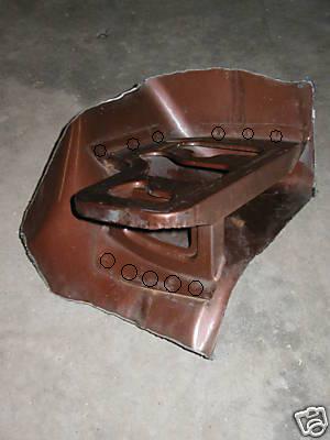

From the picture on the eBay auction, I outlined the spot welds I could discern and guesstimated the location of the others.
Those are what you would drill out with the tool Arne located for you.

E, thanks for the locations on the picture, I'll go look again in the daylight.

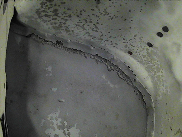

I recently had to remove the tray from my '72 before it went to sandblasting. The first thing to note is that you have to locate all the spot welds from inside the RH fender well. Thus, you need to remove whatever undercoating is in that region. Assuming you do a good job, you'll be able to see the numerous weld indentations.
You now have two choices. You can (1) use a punch tool to mark the center of each spot weld and then eventually place the self-centering point of the spot weld cutter on those locations or (2) use an 1/8" drill bit to drill through the spot welds (and likely the tray metal too) and these will serve to center the spot weld cutter later on. Either way, there will be holes that eventualy will need to be welded shut. Your choice.
After you use the cutter, you will have a fender well that looks somewhat like the attached picture of my car (looking back and upward at the firewall/wheel well intersection). The holes don't look pretty, but the tray is out and R&R can begin.
