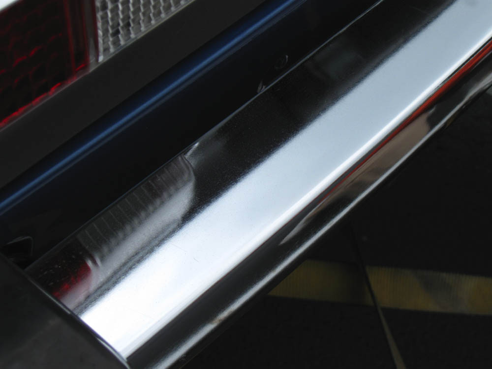

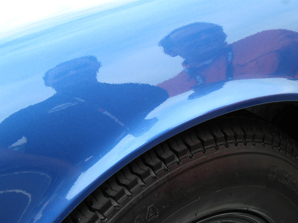

October 9, 200816 yr comment_262837 Dan, Cleveland was my first "digital" automotive outing. I bought a little Canon powershot A590 and didn't lug the film camera equipment this year. I wasn't real sure how to use the buttons and features completely. Sorry I didn't take any pictures of the fasteners. I did manage to take some shots during a conversation we were having about original finishes and I think they turned out nicely. These two unruley characters were examining the paint and chrome finish on the 1973 240Z. Notice the very faint orange peel finish and the plating quality of the chrome bumper. These "as original" finishes are not so common. Re-chrome work today is highly polished with few, if any, undersurface blemishes. In comparison to the blue paint on this example, there was a black 240Z at the show that had the most remarkable mirror quality paint finish. Link to comment https://www.classiczcars.com/forums/topic/29483-finish-on-inspection-door-machine-screws/#findComment-262837 Share on other sites More sharing options...
October 10, 200816 yr Author comment_262964 Dan,I did manage to take some shots during a conversation we were having about original finishes and I think they turned out nicely. These two unruley characters were examining the paint and chrome finish on the 1973 240Z. Notice the very faint orange peel finish and the plating quality of the chrome bumper. These "as original" finishes are not so common. Re-chrome work today is highly polished with few, if any, undersurface blemishes. In comparison to the blue paint on this example, there was a black 240Z at the show that had the most remarkable mirror quality paint finish.Well, I'll cut these characters, along with you, Chris, a little slack and assume they may know a little something about these early car's subtle nuances.I've seen some NOS bumpers, and, as has been observed in past threads, the chrome has what appears to be brush wheel marks under the chrome and not nearly the depth or luster as new, three strike chrome.But, they are NOS perfect inside and out and I am thinking for total originality, they would be more highly prized by the restorer, as would be the single stage paint with the factory orange peel appearance.Any thoughts on original vs. restored on NOS parts and finishes as seen through the eyes of a collector's or restorer's preferance? I am thinking of hanging all NOS chrome bumpers and overriders and would like opinions. Thanks for the great pics, Chris. More, please, with all the little details. Dan Link to comment https://www.classiczcars.com/forums/topic/29483-finish-on-inspection-door-machine-screws/#findComment-262964 Share on other sites More sharing options...
