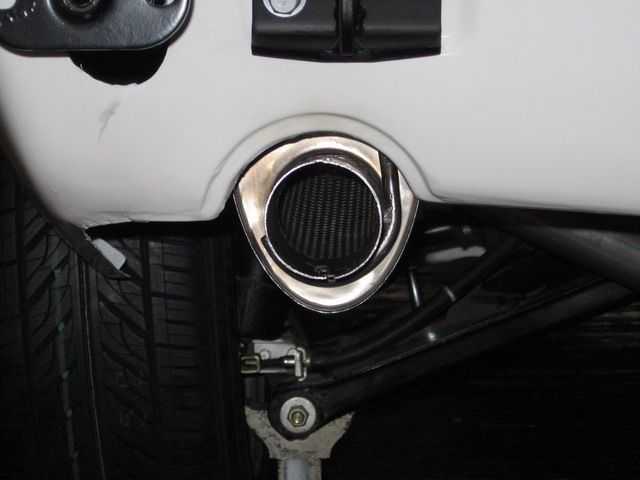

September 27, 200816 yr comment_261810 You might consider Borla muffler no. 40659. I have the 2.25" diameter model on my car. The body dimensions are identical for the 2.5" diameter model. As shown in the attached photos, it does not hang very far below the fender. This muffler might be a little longer than the MSA muffler but the "S" pipe can probably be trimmed as needed. I suggest doing a web search for the best price. Summit Racing had all the parts I needed in stock and would price match. Good luck. Fixitman Borla-Muffler40658.pdf DatsunZ-BorlaMuffler.pdf Link to comment https://www.classiczcars.com/forums/topic/29506-msa-muffler/#findComment-261810 Share on other sites More sharing options...

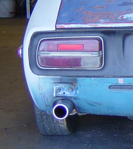

September 27, 200816 yr comment_261834 Hmmm. I was able to turn the Dynomax muffler that came with my 2.5" MSA system up and tuck it in close to the body (w/o touching). My car is a '72 with an MSA 6-1 header. I would assume that the mufflers are the same, but that could be an erroneous assumption. I'll include a picture of mine for reference in case you wanted to try my approach. Link to comment https://www.classiczcars.com/forums/topic/29506-msa-muffler/#findComment-261834 Share on other sites More sharing options...

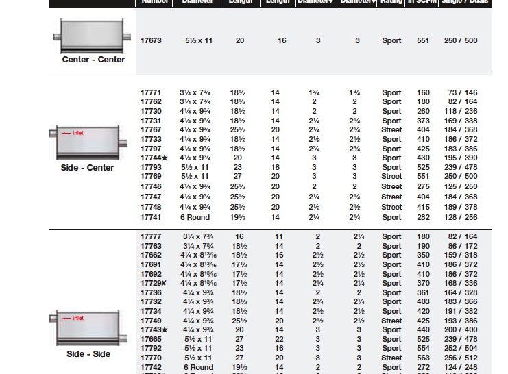

September 29, 200816 yr comment_262013 You guys are right on the install of the muffler. I've also got the MSA exhaust system on my 1970 and it's a simple matter of correct muffler positioning. If installed incorrectly, the muffler will hang down....when install correctly, the muffler is tucked upward and doesn't hang down. They are probably installing it wrong. If I remember, it is center in, offset out.I figured as much, but couldn't figure out why so many people would all install it wrong. But now I see. If 'center in, offset out' is the way it fits properly, then when it fits correctly the muffler itself is technically backwards. Because the Dynomax documentation shows that the inlet is supposed to be the offset. Link to comment https://www.classiczcars.com/forums/topic/29506-msa-muffler/#findComment-262013 Share on other sites More sharing options...
September 30, 200816 yr comment_262017 It seems to work just fine installed backwards. MSA should probably get some better documentation though. I remember when I installed mine and I had to trial fit it several different times to see which way would be best. It doesn't hang down overly much. Greg Link to comment https://www.classiczcars.com/forums/topic/29506-msa-muffler/#findComment-262017 Share on other sites More sharing options...
September 30, 200816 yr comment_262024 Sound doesn't know inlet from outlet. Turbo mufflers are basicly a straight thru angled design. The attenuation and pressure loss are the same either way it could be installed.Fixitman Link to comment https://www.classiczcars.com/forums/topic/29506-msa-muffler/#findComment-262024 Share on other sites More sharing options...
