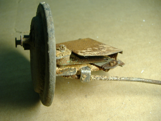

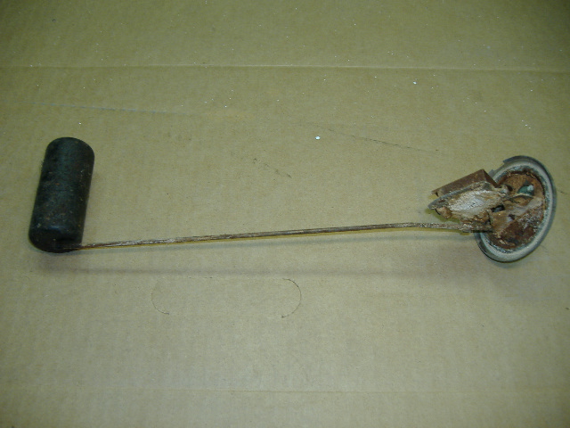

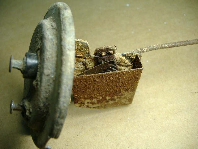

According to your description you did install it correctly. I got my old one out and photographed it in the position it needs to be in. (Kneeling at passenger rear tire removed)
When mine was removed after sitting 26 years I knew a new one was going back in, just look at the rust and build up. There are a series of wires in the center that the arm is attached to that measure resistance for the guage to function. Corrosion could be giving mis-readings. Just a thought.
What did yours look like when it was out? (getting tank cleaned) Any cleaning before reinstall?

No idea on the resistance thing, I have a hard time with electrical, but thought these photos could be helpful.
The first photo shows the float arm in the full position, this is where the wire wrapings are at the narrowest, approx 6mm. The other photo is when the float arm is in the empty position, wire wrapings at the widest, approx 14mm. This float travels a full 10 inches, the contact arm in the unit travels about 1 1/4 inches, full to empty, and is from a 73.
