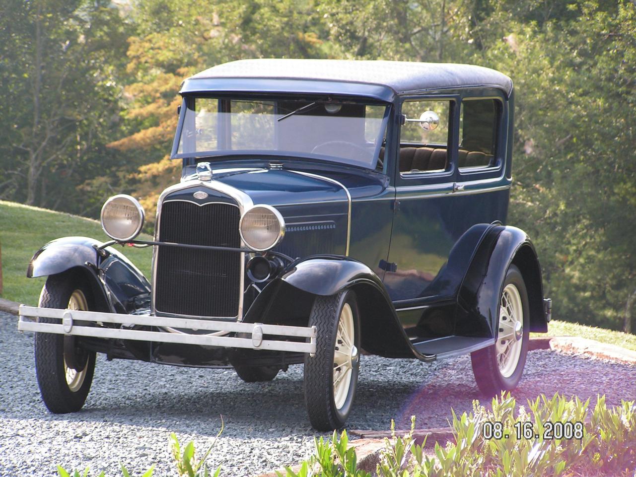

I own a 1930 Model A Tudor and when I first got it I had a similar problem. My Model A mechanic told me to do the same as Arne had mentioned but change the oil and replace one full quart with Marvel Mystery Oil. I am still running that "oil blend" and it has cleaned and helped my challange a lot. After 500 miles (and 500 miles is a lot for a Model A) I will change it out and replace. That Marvel Mystery Oil seems to have done its job, no more smoke and the engine sounds better as well, I'm sure things were sticking in there. I don't average 500 miles per year on that car (summer driving and parades mostly).
