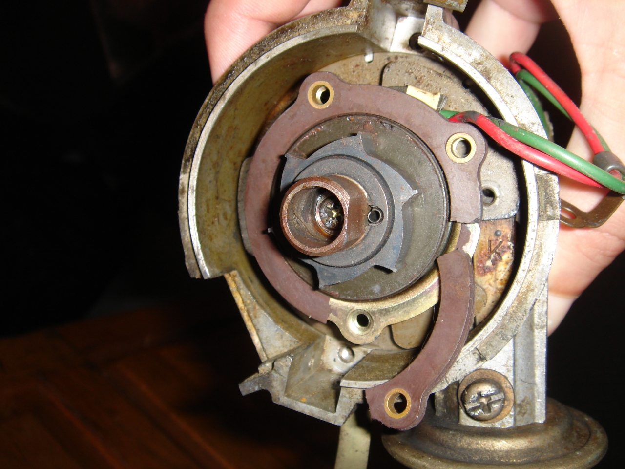

I think I'd want to disassemble it for cleaning and lubing, and also to make certain that the bearings under the base plate are still good. Other than that, it should be OK.
Just be sure to use care when disassembling the dizzy-the magnetic ring (pictured) is fragile.
Also, if it's been sitting for a while, don't plan on just opening it up. You will most likely have to hit it with penetrating fluid and let it work for a bit...
