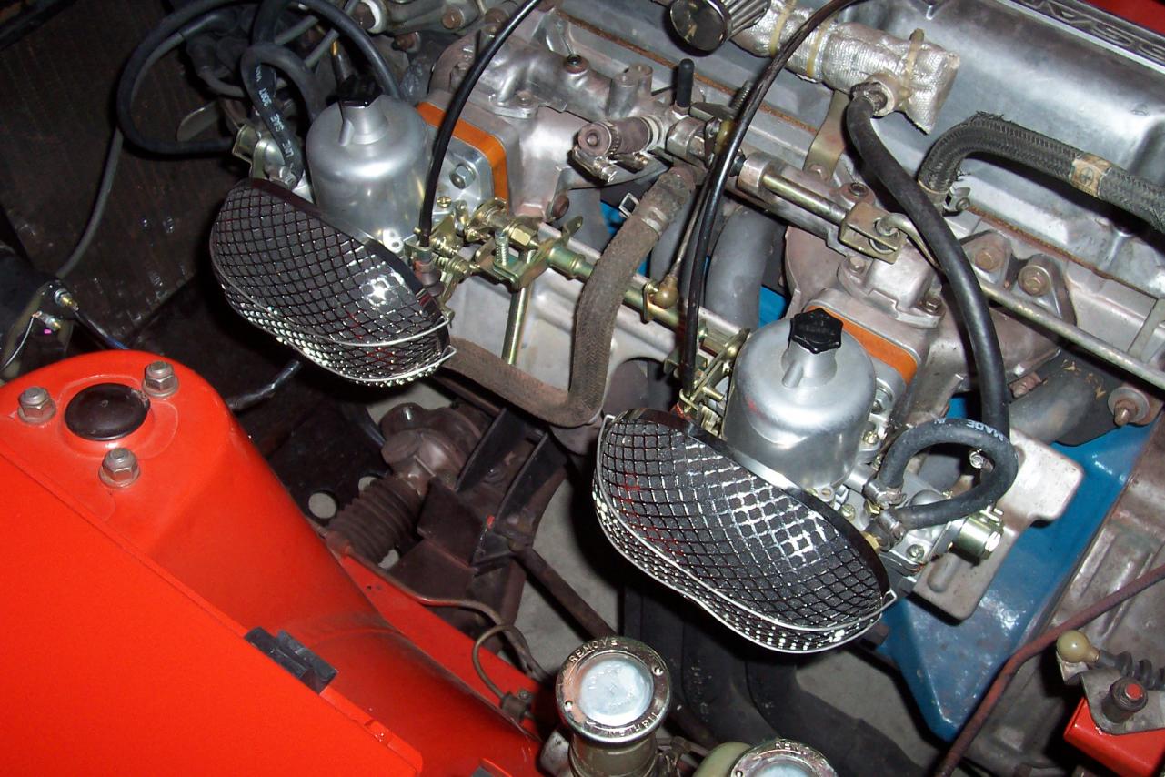

I took off the air pump, and all the stuff on the balancing tube. When I first got the car running, I had on all the balancing tube stuff on, including the throttle delay. When I took it all off, I didn't notice any difference at all in how the car ran. I run new ZTherapy 3-screws. Heres a pic of the carbs/balancing tube with it all removed. I still need to permanently close off some holes on the balancing tube, it looks kinda hacked right now.
I agree, the rudimentary emissions systems on a 240Z (pre-73) have almost no effect on power or drivability at all, as long as they are maintained and in good operating condition. If more power or better drivability is the goal, might as well leave them alone.

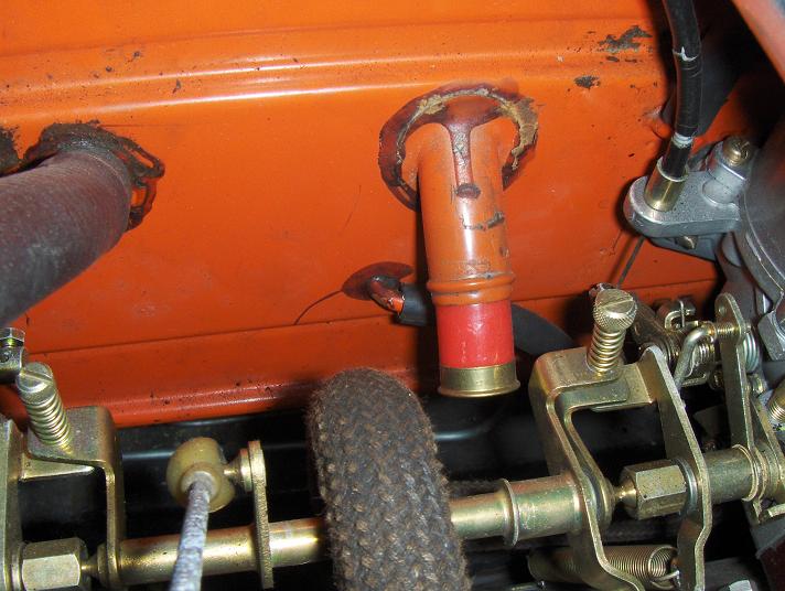

But one note, if you remove the air pump there is an opening in the back side of the air cleaner that I assume was originally the clean air inlet for the pump. If you don't block that port, unfiltered air will bypass the filter element. It is a fairly large opening, around 18mm. I did manage to find an economical plug. In fact I had boxes full of them just laying around the house. (See picture below.)
But I strongly recommend that if you use this type of plug, CHOOSE ONE THAT ISN'T LOADED! :cheeky:

Could make an interesting "booster", otherwise! Is that a 12GA? If so, I've got some 'full' brass ones around here somewhere if you want to dress it up.... they are really pretty when polished.....

You got a CCW permit? I think you may be getting a visit from the BATF. :laugh:

walter moore: love the shotgun shell :)!!!
