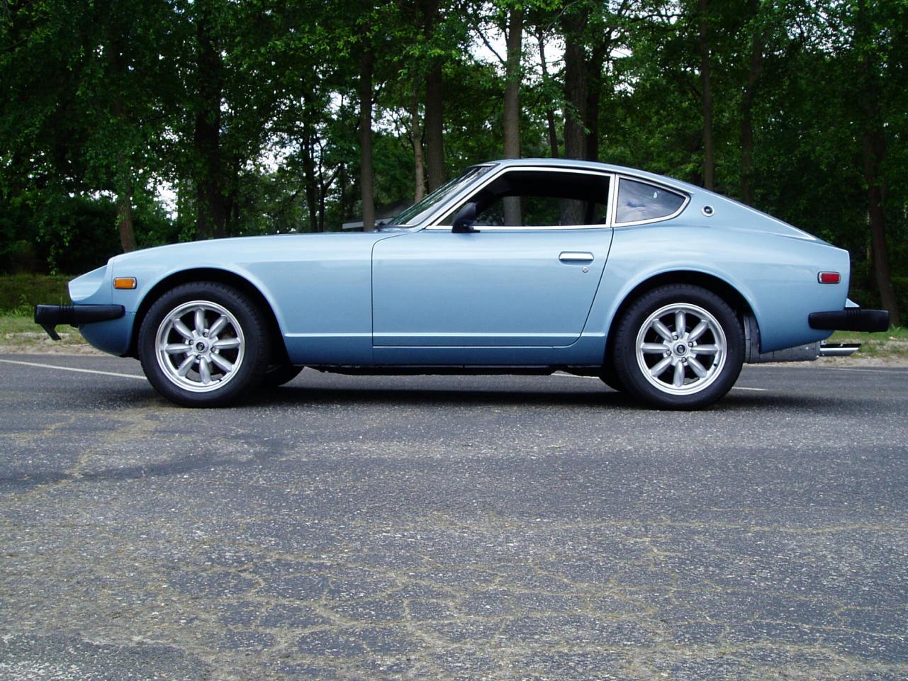

here they are on a 77Z, stock suspension
16" +4 offset Rota RB's w/ 225/50...they were a little tight for clearance up front during turning. if i'd do it again i'd go with 225/45 on a 77Z.
*****keep in mind that a 77 sits higher than a 240. you'll probably be ok with 215/50, 215/45....ish
better off taking the new wheels to a tire store and have them test fit a set or two, rather than buying the tires through a catalog

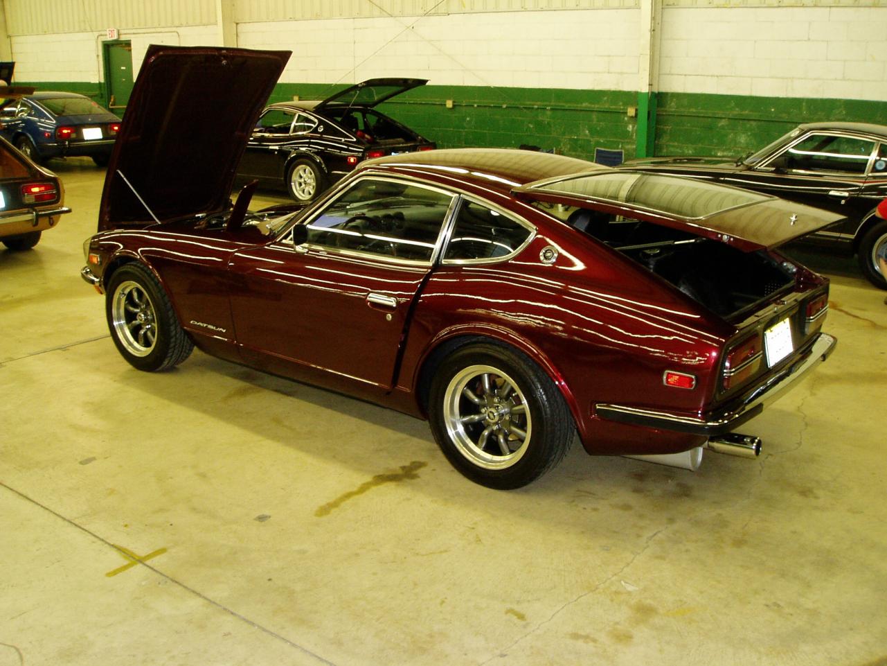

hey tom, i agree....they (Z's in general) definitely look better lowered. however, i sold my light blue '77 in favor of keeping just my 240 (pic). i had enough of maintaining 2 Z's. my 240 is lowered with 5way tockico shocks and just about every other MSA performance part out there...:) the 240 has 15" Konig rewinds w/ 225/50's
Edited by 7277
Here is a quick pic of the Scarab. She is a 1971 with Tokico springs and Illumina struts. Whees are Panasports from Motorsports with 225-50-16 Dunlops. They rub in the rear due to the rear end setting in the more "forward" position. Additionally the zero offset wheel was not correct for the cars with the rear wheels in the forward position. Motorsports and Panasport corrected this issue by making newer wheels with a +4 spacing to bring the wheel a bit more inboard. My solution to the problem was to lightly grind the inner fender lip down and then massage it gently with a hammer until it was clearanced for the tire. Works ok but could use a bit more. I didn't want to get carried away. No issues in the front what so ever.
