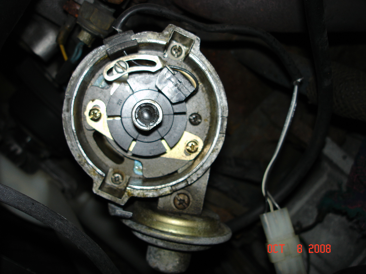

I am trying to get my XR3000 and coil hooked up and running. I have the 260Z distributor which is as far as I know the stock one. This is an electronic distributor and looking at the diagram hookups I have found around the forums it always shows three wires coming out of the distributor and then going into a molex connector before the XR3000.
The problem is that my dizzy only has two wires coming out of it, not three. That is the part that is throwing me off. I can get a picture tonight if it helps but I was curious if any other 260 owners have found an answer.

I guess that's the part I am thrown by. I see two wires coming out of the distributor. These are the only two I see. That's why connecting them to the molex it looks like I am one short. I will double check tonight and try to get a picture to make sure that I am looking at it right. Do all three of your wires come pretty much from the same location, out the upper side of the distributor?
Do you have this peice in your Dizzy? If you do, and it only has 2 wires, then something is seriously wrong or you got robbed. The picture shows the optical set-up inside a converted dizzy.
Take a picture of the inside of your dizzy and the rest of your set-up,

It is very possible I used the term optical incorrectly. Maybe it is just electronic? Here are some pictures I took:

That looks like an electronic ignition but difinately not an XR3000 set-up.
Where did you get the xr3000? was it new in the box, get it from a friend, what? As far as I know, the XR 3000 is a complete kit that comes with the Fireball coil, ignition box (w/connectors, labels and directions) and 1 Optical insert that replaces your current (points or electronic) set-up.
I think you're missing something.

The distributor on your photo shows an inductive magnetic pickup, you can see the reluctor with a protruding nose for each cylinder and the pickup assembly to the right with a black and green cable.
The XR3000 unfortunately only supports optical pickups, so you either need to convert the distributor to the Crane optical pickup as mentioned by Zs-ondabrain, or use a different ignition (Crane Hi-6, MSD6) which supports magnetic pickups. Your later photos both show the optical pickup and the correct optical blade with six slots, so you should have all required parts.
