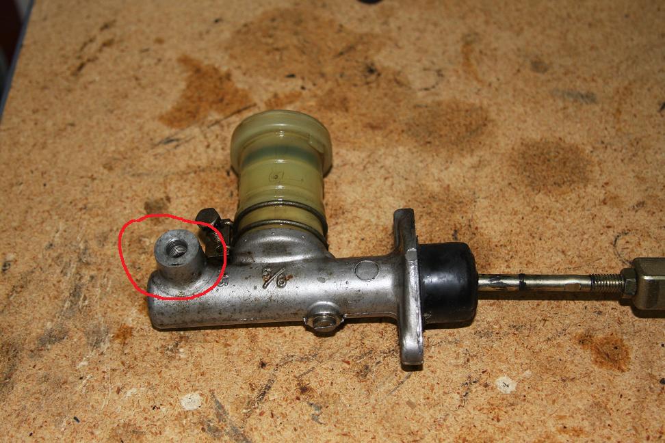

October 8, 200816 yr Author comment_262798 Thanks guys, I got the master cylinder off and ordered a new one. I filled the old one up after it was off and pressed the piston....got a few squirts but nothing steady. I put my finger over the hole that feeds the line to the slave and again pumped the piston and noticed it did provide suction on my finger and then would give a pretty good squirt for one or two pumps, then nothing. Does it sound like its bad? I have no idea, but since it will soon have a new master cyl and slave cyl surely it will work then. Here's a picture showing what I covered up in Red, it seemed to pump ok but I guess there is no way of testing the old one??....maybe the pistons inside are bad. Link to comment https://www.classiczcars.com/forums/topic/29617-new-slaveno-result/#findComment-262798 Share on other sites More sharing options...

October 8, 200816 yr comment_262802 I put both a new slave and master cylinder in my 70 and there is very little resistance on the pedal. The good news is it operates. I am going to put the return spring back on mine that was on the early cars. Talking with Arne his car has low pressure also. Link to comment https://www.classiczcars.com/forums/topic/29617-new-slaveno-result/#findComment-262802 Share on other sites More sharing options...
October 8, 200816 yr comment_262803 When you get the new master check that the rod is the same as your old one. I recently bought a new one and the rod was about a 3/4 inch too short so I had to to use the old rod. Steve Link to comment https://www.classiczcars.com/forums/topic/29617-new-slaveno-result/#findComment-262803 Share on other sites More sharing options...
October 9, 200816 yr comment_262805 When you get the new master check that the rod is the same as your old one. I recently bought a new one and the rod was about a 3/4 inch too short so I had to to use the old rod. SteveI also had to use the old rod. The replacement was too short. I still do not understand the lack of pressure. The rod moves about an inch. Link to comment https://www.classiczcars.com/forums/topic/29617-new-slaveno-result/#findComment-262805 Share on other sites More sharing options...
