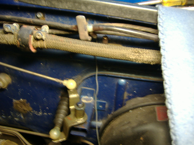

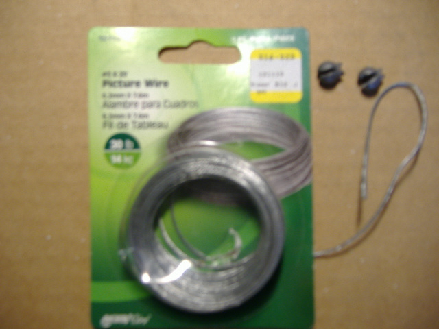

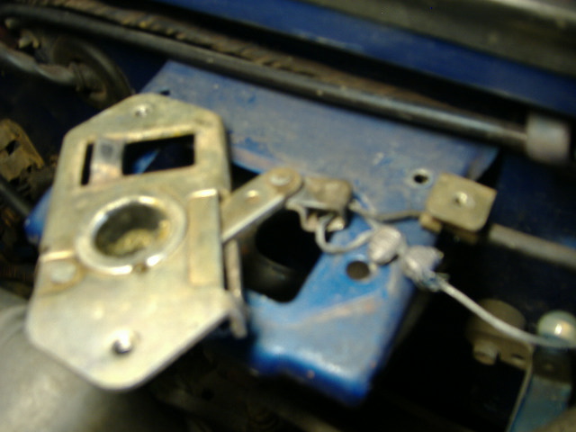

October 11, 200816 yr comment_263060 One of the very first threads I ever read about a Z-car was about this very subject. I knew I never wanted it to happen to me so this is what I did. :bulb: I got a peice of steel cable (picture frame wire) about 3 foot long and two split shot fishing sinkers. Took the hood latch off its mount and ran a loop of cable through the pulling lever and secured it with the split shot sinkers. Then ran the cable across the firewall, over the brake booster valve and the wire loom holder (bendable metal tab) then at a right angle straight down to the bendable metal tab that holds the spedo cable and wrapped the excess around it. If my hood release cable ever breaks I just find the end of the spare cable at the spedo cable holder and pull. It pays for itself when used just once. The only visible part of it is where the cable goes down the firewall. Nothing shows where the latch and mount are. This fix was less than $1.50 and about 15 minutes to install. No lift or long armed 'monkey boy' to get the hood open now. Bonzi Lon Link to comment https://www.classiczcars.com/forums/topic/29633-this-could-happen-to-you/#findComment-263060 Share on other sites More sharing options...

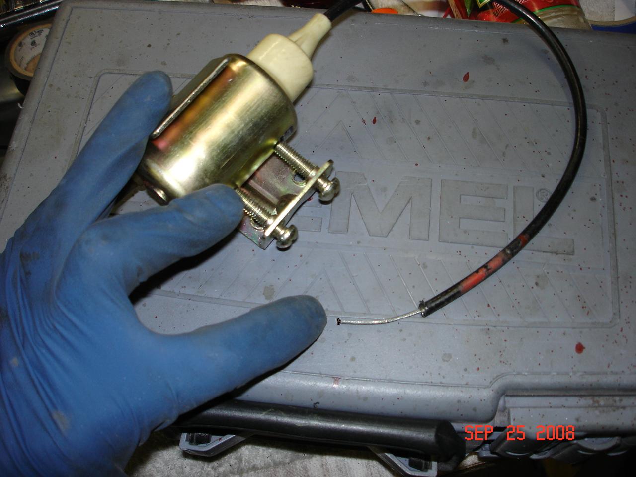

October 12, 200816 yr comment_263099 Although this is in the "Engine and Drivetrain" section My adding to the thread is relavent. I plan on doing something similar to the 260Z. I've found that most hood cables bind at some point or another as well as rust and slowly fall apart. This is obviously a problem when it's the only way to open the hood. I plan on using a 15LB Solenoid, placed in the cowl area (towards the drivers side of the wiper motor) and the cable will go thru the firewall, 6" from the hood release mechanism. I'll also attach a Loop into the cable so that a "secondary" cable can be attached and ran to a hidden yet accessible area for emergencies. And the release button will replace the release handle, most likely in the same area. Having the hood release electronic also allows for the accessory channel on a keyless entry or alarm system to "Pop" the hood via the remote. Pretty cool huh? Dave. Link to comment https://www.classiczcars.com/forums/topic/29633-this-could-happen-to-you/#findComment-263099 Share on other sites More sharing options...
