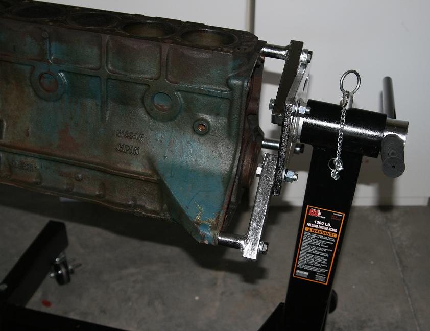

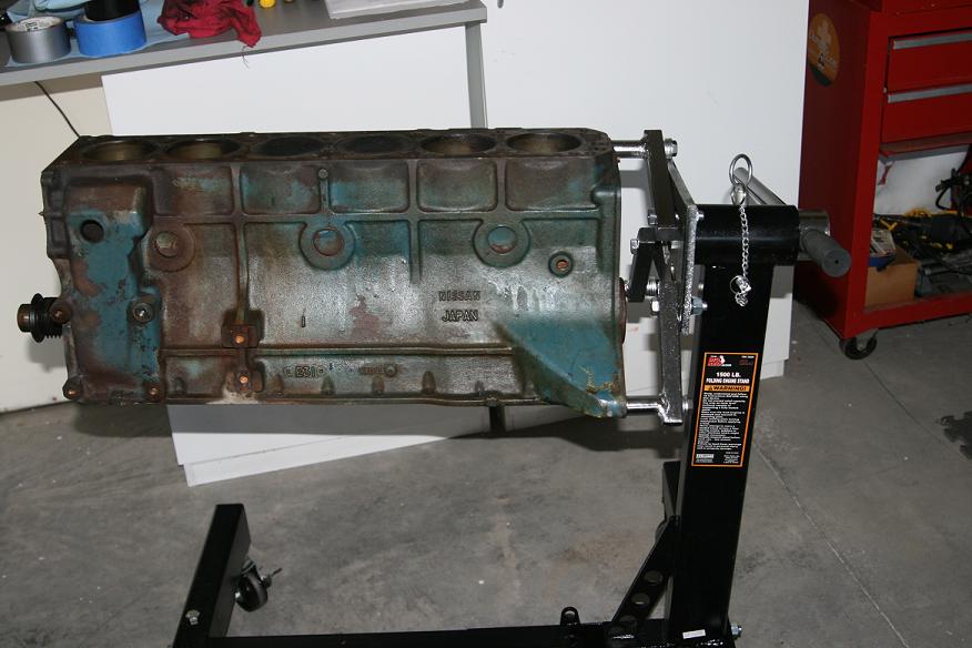

Thanks for the heads up, I went ahead and got both 10mm and 12mm last weekend. I used spacers with the 10mm but could only attach three of the four arms to the block, do you think that will be ok? I tried various configurations but could only get three to work.
Let me know if you would change something.
Oh, yea......now that I got it on this stand what am I suppossed to do...:stupid: I think first I'll give it some paint.
The hole in the arm is to far away to mount it that way, I can get it to work if I move one arm to the lower bracket but wasnt sure if you should have two arms in one bracket hole. Does that makes sense? If I could drill an extra hole in the arm I could mount it like yours.
Do you think it's ok to use just three arms, or would you move one to the lower bracket.
