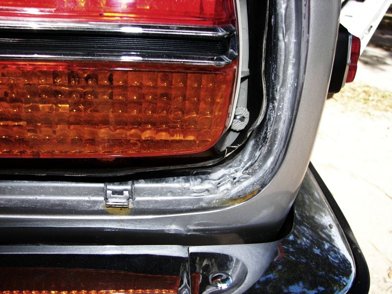

I received the 240Z as advertised on E-bay:

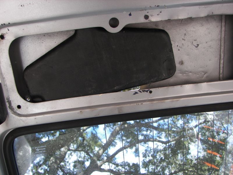

The added paint job was awful. Paint drops were on the hood. The blue original color was showing thru.

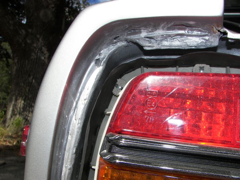

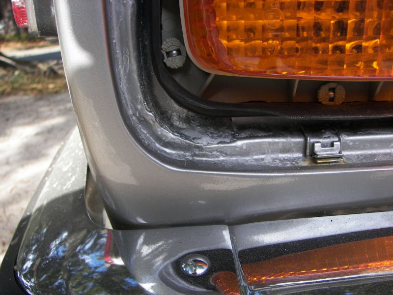

1)Larrys car has had the springs corrected( the ones on it were short to the point the rear suspension was resting on the bump stops and the springs rattleing anytime the car went over a bump-from no longer being under tension),
2) One caliper replaced, as one was frozen, and there is still an issue with the car pulling hard to one side when braking-the pads will be replaced, they appear to be mismatched left to right(one pair of high performance-one set of run of the mill)
3)Four proper sized tires put on it-the ones on it were too small-put there to allow more clearance to address the clearance issues from the severe lowering of the car.
4) the Muffler was reinstalled(Al had put it on upside down and backwards),
5)the check valve for the mastervac was re-installed correctly(it was installed backwards-meaning the car had no vacuum to power brake booster-and thereby no power brakes)
6) There is still a shimmy in the front end, meaning the rack probably needs to be

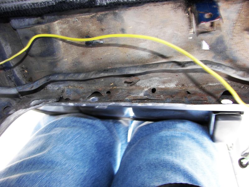

7) serious Dents in the floor from jacking the car in the wrong place to replace the wheels have been removed.
Most of the issues left to correct are:
a) restore the steering wheel,
B) clam shell,
c) restore/replace the turnsignal switch-only works one way,
d) restore the hazzard switch and its hardware,
e) Restore the original radio(completly dead, worn and broken face plate),
f) correct the after market radio -lights up but no sound)
g) Restore the scratched shifter, replace the torn shifter boot,
h) restore the worn/missing/broken hardware for the ps door, seats, visors, mirror and seatbelts
i) restore crazed/worn/broken console,
j) cracked rear trims(all but one),
k) cut shock tower upholstery,
l) worn tunnel upholstery,
m) scratched up gage lenses,
n) cracked knob(s) on HCP,
o) replace the mismatched fasteners through out the car,
p) no key to the doors(ign Key only),
q) several dash lights are out,
r) replate the engine hardware that was painted instead of replated
s) correct Fit of the PS headlight cover that was installed improperly(3/4" off)

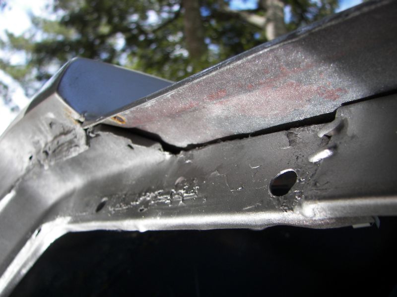

t) correct the core support damage

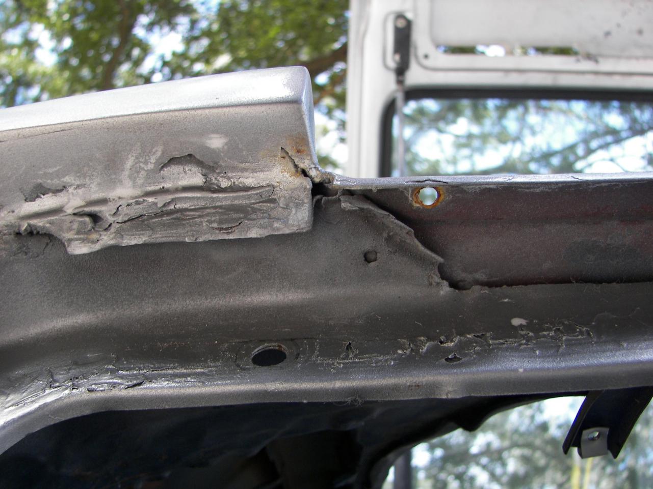

u) Remove the dents in the car that was said to be ready for a concours paint job he was paid extra(exactly the amount he asked for) to do and did not.

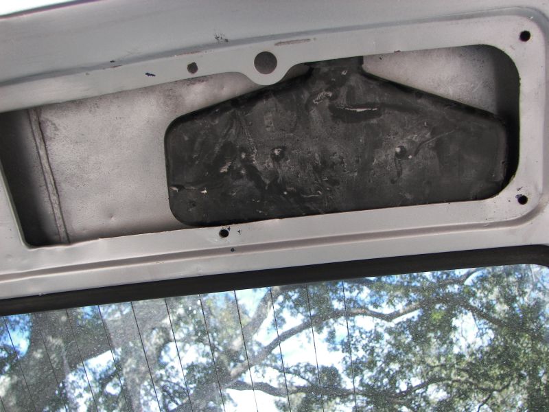

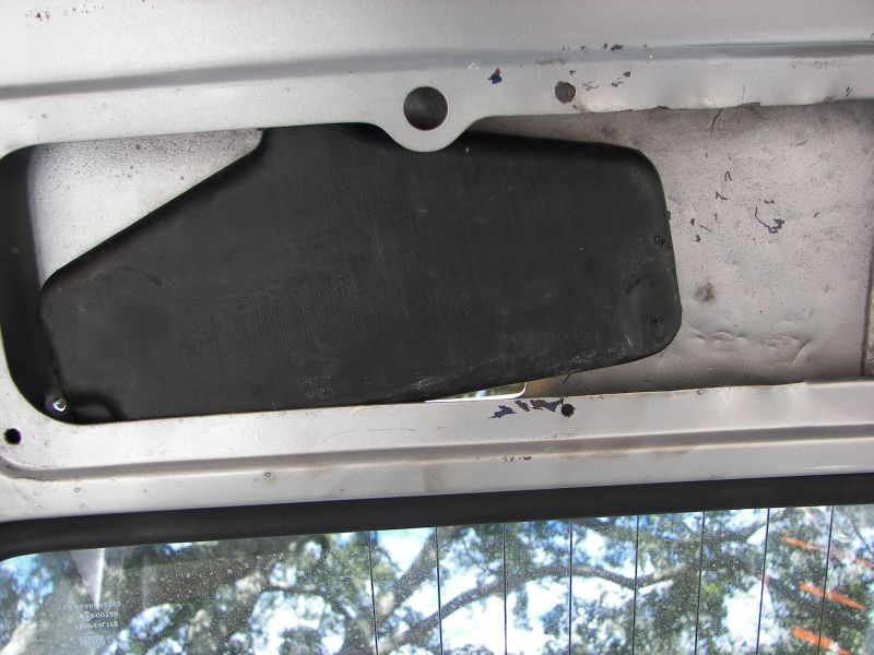

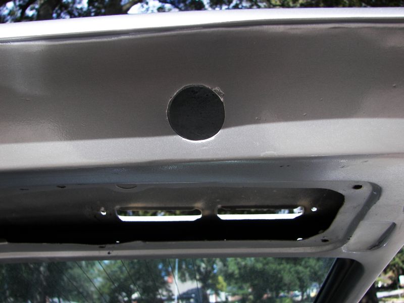

v) replacement of the hatch(raw bondo squished in all over the inside)
w) replacement of the hood
x) hatch shelf/corner replacement (slathered filler all over the swiss cheese)
y) Strip the car, professionally repaint(Al was paid what he asked to remove the glass and paint the car properly-he did not)
Z) Put the car back together in the condition AL chose to advertise it as being in-even though it was no where close:

I picked up the car from Asian Automotive/Carter Racing this morning. I spent the day with the car and drove it in all kinds of dry conditions while getting estimates for correcting Als version of award winning bodywork and Concourse paint(Every estimate included a replacement hood and a replacement hatch-those on the car were too full of poorly done previous repairs, filler and rust to economically repair at $44/hour. The lowest bid to correct the work so far is $4270.11 with the provision that hidden poor repairs will add to the cost of those that were exposed when the back sides of several repairs were examined(anyone know how to take a photo through a non-camera ready borescope?).
1) Even though the car ran strong when I drove it before, it turns out Al tuned the car for idle-IDLE! The carbs were neither balanced nor adjusted for performance. Now that they are tuned really well, the muffler installed properly, the ride height corrected, proper tires installed, and the brakes functioning properly the car is still seriously too loud at and about 2000 rpm, but at least now it is a blast to drive-it is night and day different than the last time I drove it. At 4k you can feel the aftermarket cam come into its sweet spot.

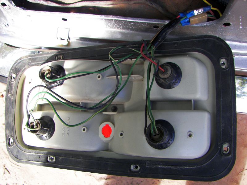

2) Only the headlights and one side of the emergency flashers work. No other lights(other than the one on the new Kenwood radio that AL installed so as to make no noise at all) actually light up! No turn signals, no markers, no running lights, map light dash light or engine light. Replacing the fuses-all of them-made no change!
3) At any speed the exhaust fumes in the car are so bad that the only way it can be driven is with the windows up-since the AC was wired to be on if the car is on(NO THERMOSTATIC CONTROL), it is on all the time, but there is very little airflow through the car, and even less cooling-it was in the 50s here in Savannah today, and with the AC running full blast all the time it was still colder outside than in the car-almost no airflow through the system, and inoperative controls! A fine example of Als HVAC ability-he was paid extra to install a WORKING a/c unit! On a 50 degree afternoon holding any speed up to 70 miles per hour with the Ac blower on full blast and the compressor on continuously, the AC Al installed can't keep up...
What about the heat you ask- the AC was wired to be on all the time!

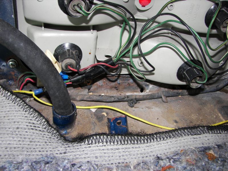

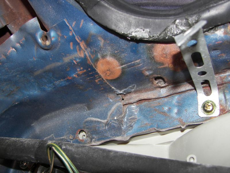

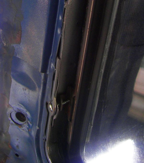

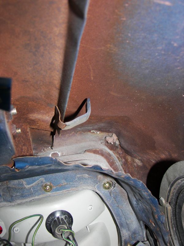

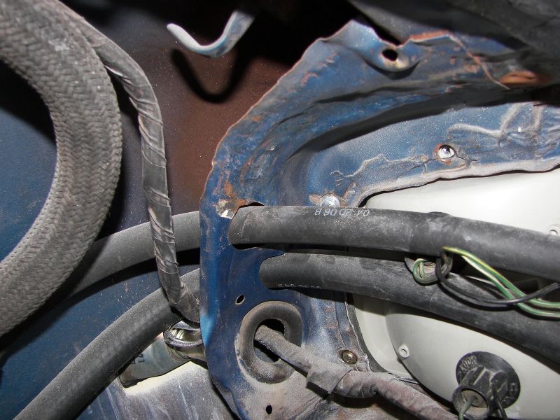

Out of 87 fasteners removed today 78 were coarse self-tapping sheetmetal screws-of those 64 were forced into locations with pre-cut threads. Six fasteners were correctly reused, and the balance were 10/24 threaded into metric threads.
There were eighteen missing fasteners including the passenger side seat rear retainers-meaning the rear of the passenger seat was not bolted down-though the studs had been replaced.
The door panels have cut lines and damage underneath, meaning they were probably not NOS, but a recovered set-though nicely done.

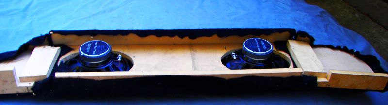

The radio install included a dead Kicker Amp under the seat-not secured at all, and grounded with a self-drilling sheetmetal screw through the floor-it appears that the improperly prepared frayed ends of the 8g wires used shorted against the case blowing the underhood fuse, and the amp.
For the fuel and vapor hoses in the back Al used heater hose, and made no attempt to seal the hoses where they passed through the floor. There are also several welding burn throughs at the back of the car-meaning more holes to the outside for fumes to pull through. Pictures will be posted later.

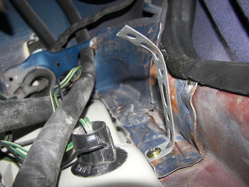

Have a look at the speaker box-yes it is sagging when upside down.
It was attatched at the bottom with a single self drilling sheet metal screw through the floor-right on top of the gas tank.

and more...

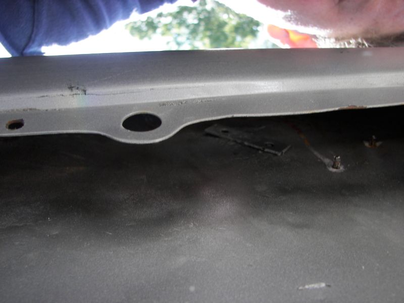

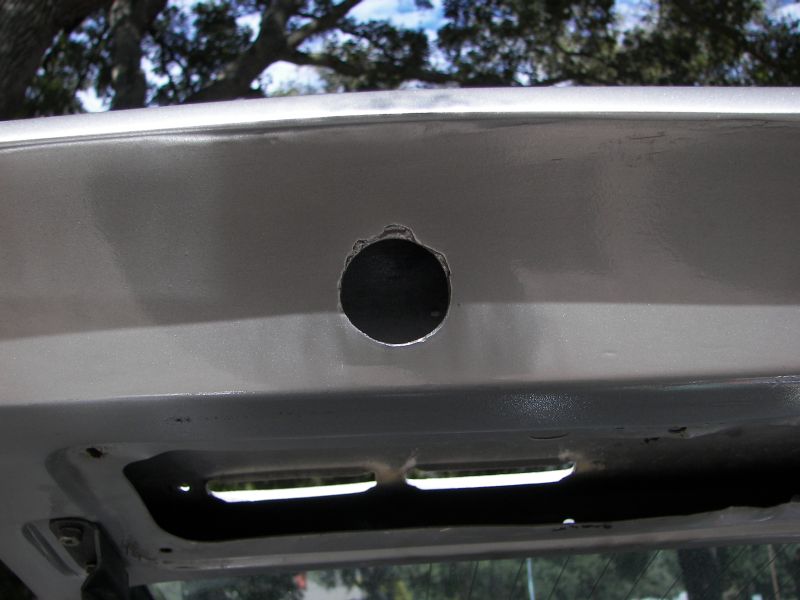

No pins on the vent grills-the pins align and secure the inner plenums-meaning without the pins they slide around with each turn of the car-installation hole filled-and not opened up before installation means the grills pins were broken before installation.
Lots of openings in the rear of the car, incomplete and miss-aligned repairs, untreated rust...

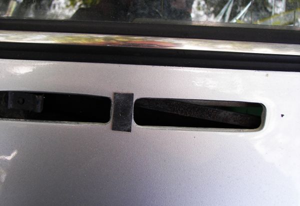

The Passenger door is a filler piece too, but because it is painted silver, I could not get the pictures to show the dents inside...

The aftermarket Kenwood radio was installed with all of the speaker wires cut off-using only the rca outs. In reviewing the proper owners/install manual downloaded from Kenwoods web site for the unit-this option is not listed at all-leading me to believe(not tested yet) that the amplifier in the radio was(is) probably dead when the unit was installed. Have a peek at the wiring on the license lamp-indicative of the radio install. Several cut wires(B+) cut not wrapped.
