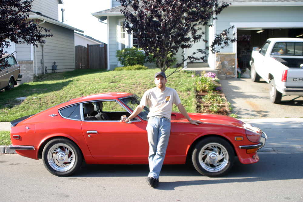

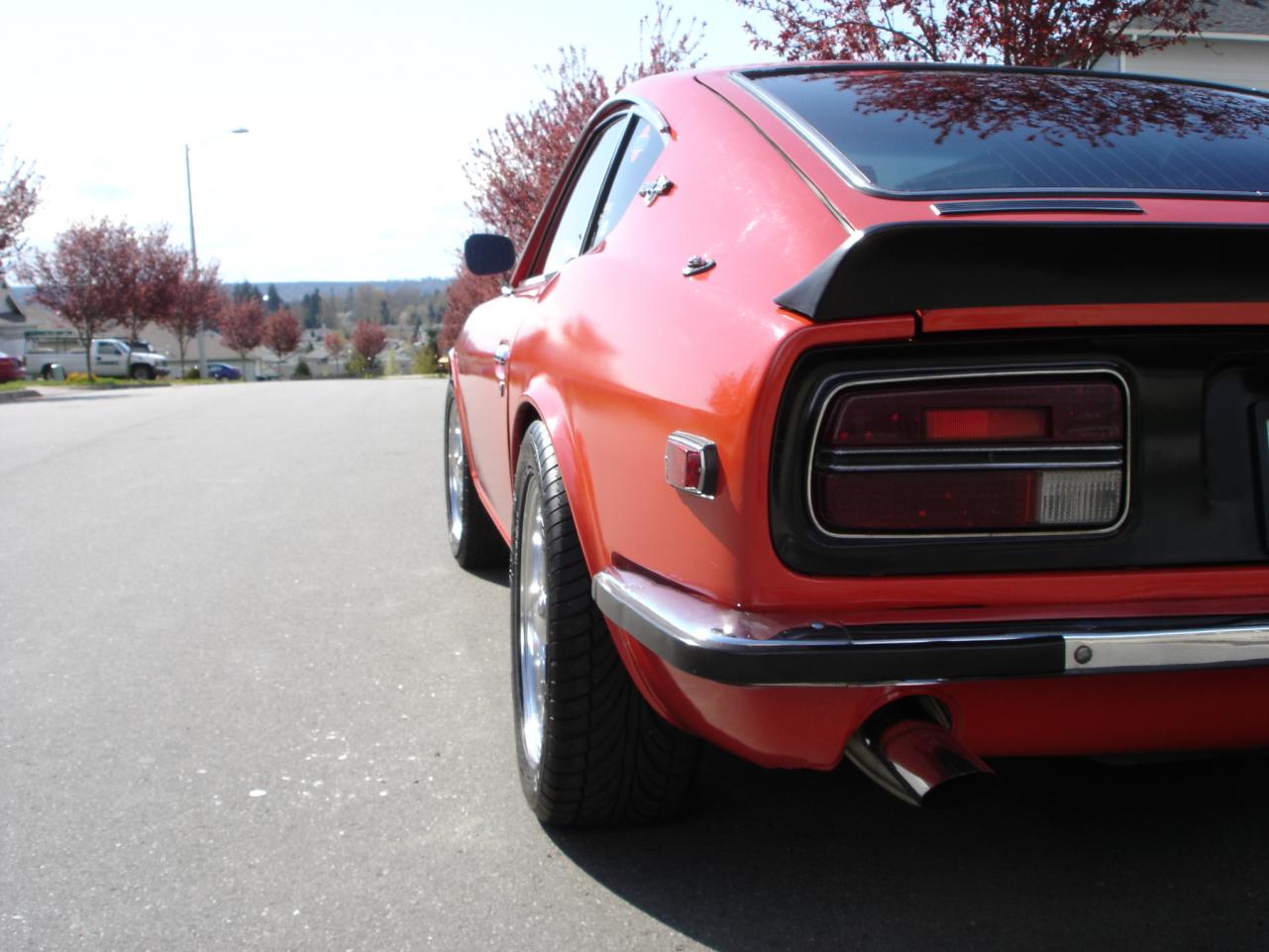

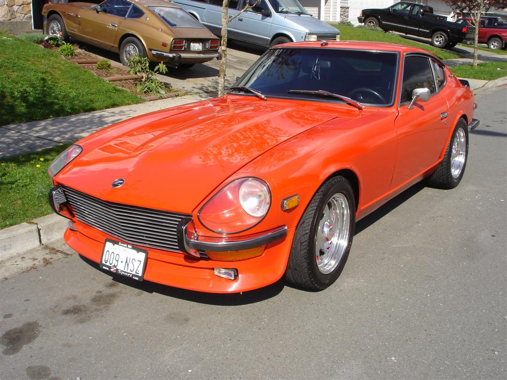

I went from 14" slotted mags (you all know the kind) and moved up to a 16"X7" then loaded them with 205/40R16's but the ride was too harsh. So I went with a 225/50ZR16 and the ride is very comfortable yet agressive. The tires are Riken Raptors and the price is awesome. I only paid $75 each at Discount Tire. They fill the wheel well beautifully and don't rub, even with the car being lowered 1.5"s all the way around.

Dave Zs-ondabrain,
I also have the 70's type Appliance slotted mags and am thinking of upgrading.
Your 16" x 7" rims look awesome.
Can you share what they are, where you bought them, cost, polished aluminum?

Good to hear about the harness's.
The wheels are polished aluminum (American) Eagle Alloys 16"x7" wheels w/ a 0.0 offset. I checked with the manufacturer and they are NLA in 16". Only 15" I think. The tires are 225/50ZR16 Riken Raptors ($75 each when on sale) They're now $92 each
http://aewheel.com/eagle_alloy_wheels.cfm?id=10 The wheel
http://aewheel.com/wheels_detail_specs.cfm?id=10 The specs
Mine were bought a few years ago and they have the dual size holes under the cap (holes for datsun and 1 size up. 8 holes)
