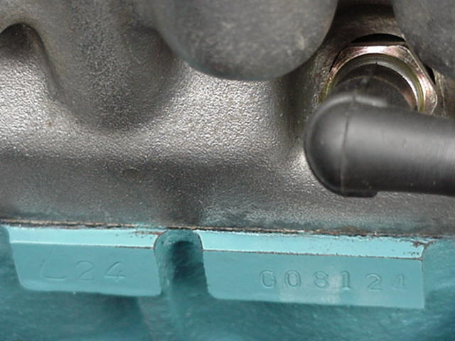

If you look at the picture I Posted - You will see that the two flat pads cast into the engine block have numbers stamped into them. The first one says L24 and the second has a number stamped into it. All "L" series engines sent to the US have these little flat pads cast into them.
If someone put a 260Z engine in the car - the little flat pads on your engine should have "L26" stamped into the first pad - and it may or may not have a serial number stamped into the second pad. OEM replacement engines ordered though the Nissan Dealers Parts Department may not have had serial numbers stamped into them.
In the picture I posted - you can see the little flat pads - just below and to the left of the #5 spark plug. Just look at your engine...at the rear.. below the #5 and #6 spark plugs... You should see two little flat pads, and they should be stamped with letters/numbers - let us know what they say

WHOOPEE! Found it! It's L28 vs. the original L24 ...
...I thought it would be the 260z engine, but logic tells me that if L24 = 240z original, a 260z engine should be an L26 (or?)
It is a L28, so it is from a Datsun 280z, not a 260z. You are correct that a 260Z would have an L26.
