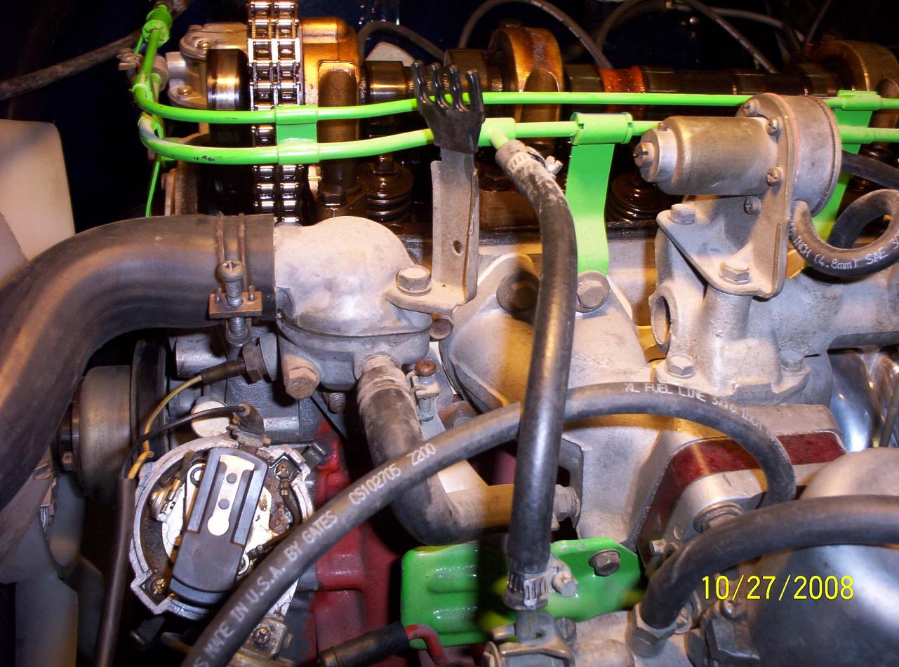

When (after changing the oil pump) did the problems begin? You may want to doublecheck the distributor spindle tang orientation at #1 TDC to make sure it's correct, since you have replaced the oil pump (they both run off the same gear.) I know you think it's "never [been] messed with" but it doesn't take much to mess it up dramatically.
Could you show us a pic of your rotor at #1 TDC?
Edited by xray
The rotor is definitely not pointing where it should. Like xray said, the #1 is around 7:30 on the rotor. You seem to be pointing at the 2 or 4 cylinder where the rotor is at. I think you have a significant timing issue.
I have a diagram that Stephen B sent me when I was going through my timing issues that shows exactly where the rotor and the tab on the dizzy shaft should be at for TDC. If nobody sends it to you first, I'll post it when I get home at 4 PM.
Actually I just looked at the link xray referenced, thats exactly what you need to get the timing right.
You'll need to remove the dizzy and the shaft and re-install until the tab lines up exactly like the pics in that link. When I did it, it took me about 15 tries to get the thing lined up right, but once I did, it ran perfectly.

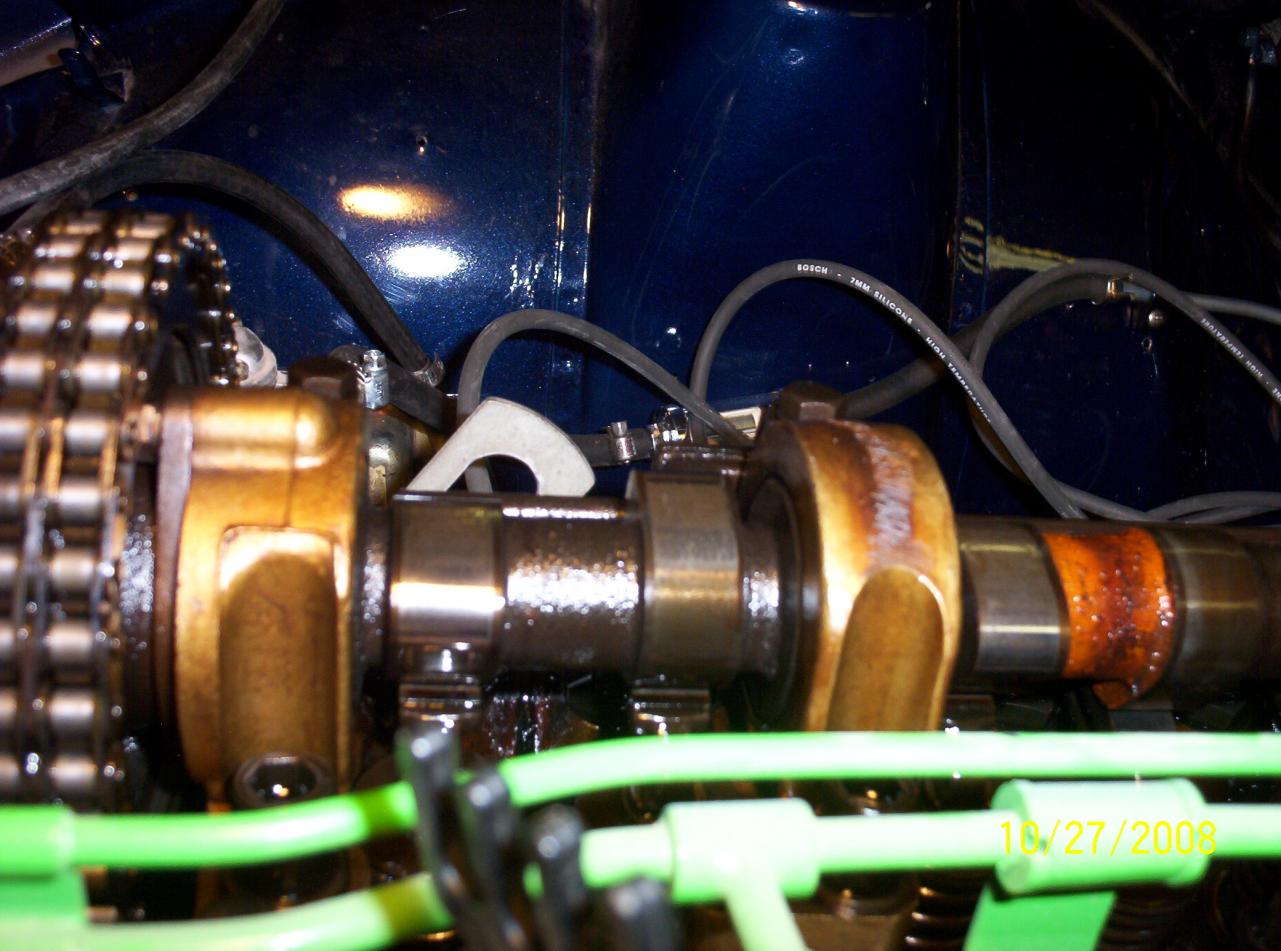

I am confident I am on the compression stroke due to both valves being closed.
http://www.classiczcars.com/forums/attachment.php?attachmentid=26192&d=1225162852
Not just a Z - zdisease
Both intake and exhuast valves are closed throughout the compression and power stroke, not simply only at TDC. TDC on compression can really be best determined by positively identifying the #1 piston at the top of its stroke when both valves are closed. The easiest way to figure this out is to place a thin wire through the #1 spark plug hole and rotate the engine by hand (rather, by socket wrench on the crankshaft bolt) When you feel the wire deflect with both #1 cam lobes pointing up/away, you're at TDC on compression.
Because of the deteriorating rubber ring in your crank pulley, those marks may or may not correspond to anything, so don't trust them. Once you've determined TDC #1 on compression, paint a small white spot on your crank pulley where your timing pointer directs. That is 0 degrees, regardless of the tick marks on your crank pulley. Static advance is 7 degrees BTDC (IIRC), so adjust your distributor accordingly.

The only missing picture was one of the rotor pointing at 7:30 ish
