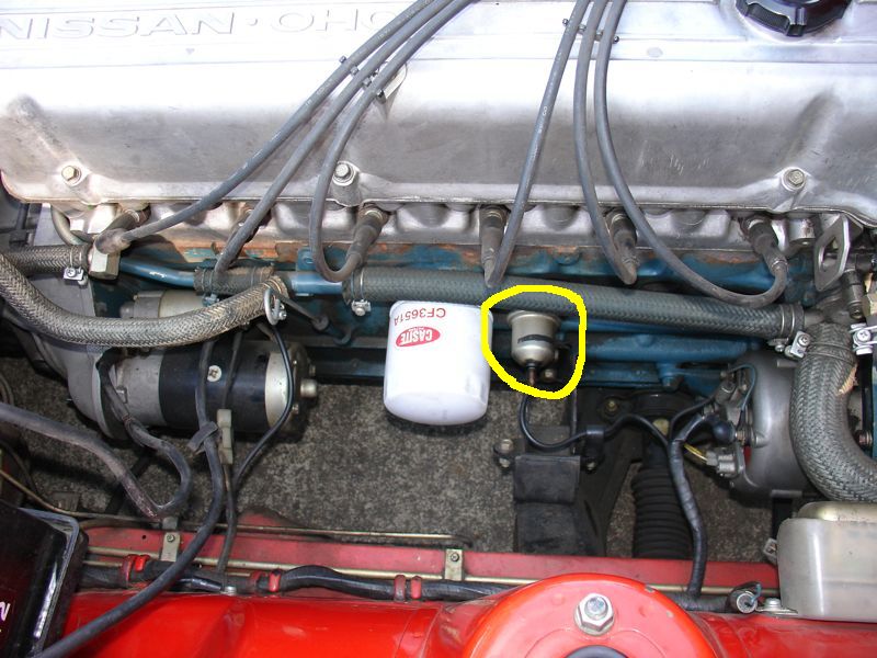

Hi everyone. My 78 has had a little oil leaking recently. I traced it to a canister looking thing next to the oil filter (opposite side from the dip stick). This part has two terminals on the end, and a connection to it covered by a rubber bootie. Anyway, can someone tell me what this part is, and how serious of a problem it is? Hopefully it's something I can fix myself. Any help would be appreciated.

If you decide to replace it with a new one, just be very careful when unscrewing the leaky one.
Gentle pressure with the correct size wrench on the hex thread at the very base of the sender, right up by the engine block.
You don't want to snap the threaded nipple off.
Some people have been there, done that:angry:

The sender is screwed into the main oil gallery in the engine block. It won't be under any pressure, just a reservoir ready to drain.
It will lose some oil when you remove the old one but if you are reasonably quick in doing the changeover it won't make much of a mess.
What does come out will be minimal so top up is hardly necessary.
Use some good quality thread sealant on the new one.
It will help seal the connection and protect the threads from seizing in the engine block.

If it is leaking at the thread [or block], then a sealant should go a long way to fixing the leak.
However if it is leaking from the body of the sender, it is probably due for replacement.
Clean up the area and check it now and then to determine where it is leaking from, then take the appropriate action.
If you do remove it, try to get a wrench on to the hex head right up by the block.
Don't try to unscrew it grasping the sender body, it may snap off:stupid:
