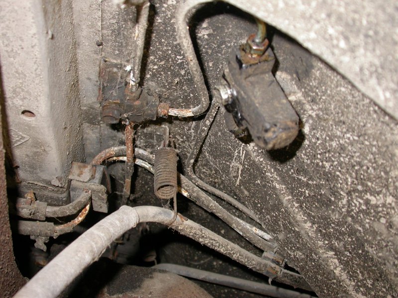

Posted November 9, 200816 yr comment_265904 Does anyone know how much pressure it takes to get the rear brake proportioning valve to open? I am trying to flush and clean the lines going to the rear brakes. I am using a 60cc syringe to force fluid thru but it won't go. So I'm thinking that I just cannot generate enough pressure to open the valve or its very blocked with crud. M/S is not installed as yet. Fittings on the valve are so tight I can't get them off. Mike Link to comment https://www.classiczcars.com/forums/topic/29925-1970-rear-brake-valve/ Share on other sites More sharing options...

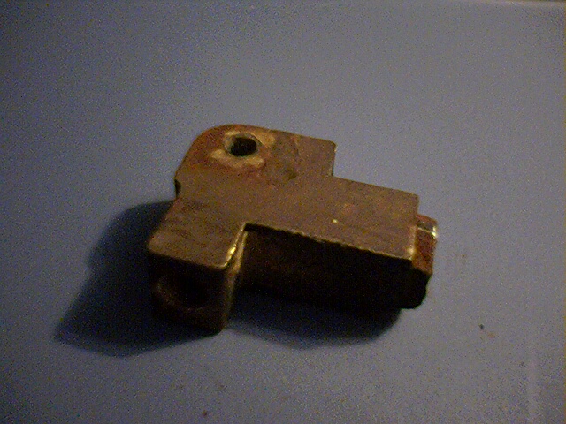

November 9, 200816 yr comment_265909 Does anyone know how much pressure it takes to get the rear brake proportioning valve to open? I am trying to flush and clean the lines going to the rear brakes. I am using a 60cc syringe to force fluid thru but it won't go. So I'm thinking that I just cannot generate enough pressure to open the valve or its very blocked with crud. M/S is not installed as yet. Fittings on the valve are so tight I can't get them off. MikeIf your talking about the one in the back it not a proportioning valve, its a residual pressure check valve. Its purpose to to maintain about 10 pounds of pressure to overcome the springs on the shoes and keep the shoes positioned at the point of drum contact. To flush it will take 10 or so pounds to open it. The distribution valve under the M/C has springs in both sides under the caps that fill up with crud also. Edited November 9, 200816 yr by Maples71240Z Link to comment https://www.classiczcars.com/forums/topic/29925-1970-rear-brake-valve/#findComment-265909 Share on other sites More sharing options...

November 27, 200816 yr Author comment_267526 Here is my happy update. I decided that my Autozone flair wrench was part of the problem, so I bought a new Craftsman flair wrench that has a deeper contact area. Cost about $15.00 bucks but it did the job. I got the lines off the Prop. valve, removed it and cleaned all the crud out. Yes, it was plugged up good! Now I can clear all the lines and finish the brake rehab. Lesson learned: get the best quality tools you can afford.Mike Link to comment https://www.classiczcars.com/forums/topic/29925-1970-rear-brake-valve/#findComment-267526 Share on other sites More sharing options...
