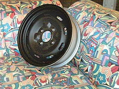

Here are some good pictures of correct coloring. The outside face is a satin black. and the other surfaces are silver grey.

The seller that I am meeting next week said the rims have silver on the inside and black on the outside. Does that mean something special or were all rims that color scheme?
That's normal, as shown in Chris' post above.
