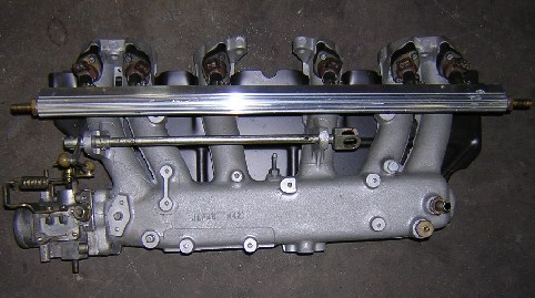

280~master,
In post #4 of this thread you posted some photographs of various types of Z intake manifolds. The first photo shows a polished manifold. Would you mind sharing with us specifically HOW you got that manifold looking so good?
Please be as specific as possible. I'd like to copy whatever you did to a T! Sanding by hand? Buffing wheels? I'd appreciate your willingness to share the secret!
Additionally, if others have achieved similar results with their polished manifolds, please chime in with your secrets as well. I'm familiar with the hand sanding process of polishing valve covers, but it just seems that intake manifolds don't lend themselves as easily to the same process because of all their curves/irregular surfaces.
