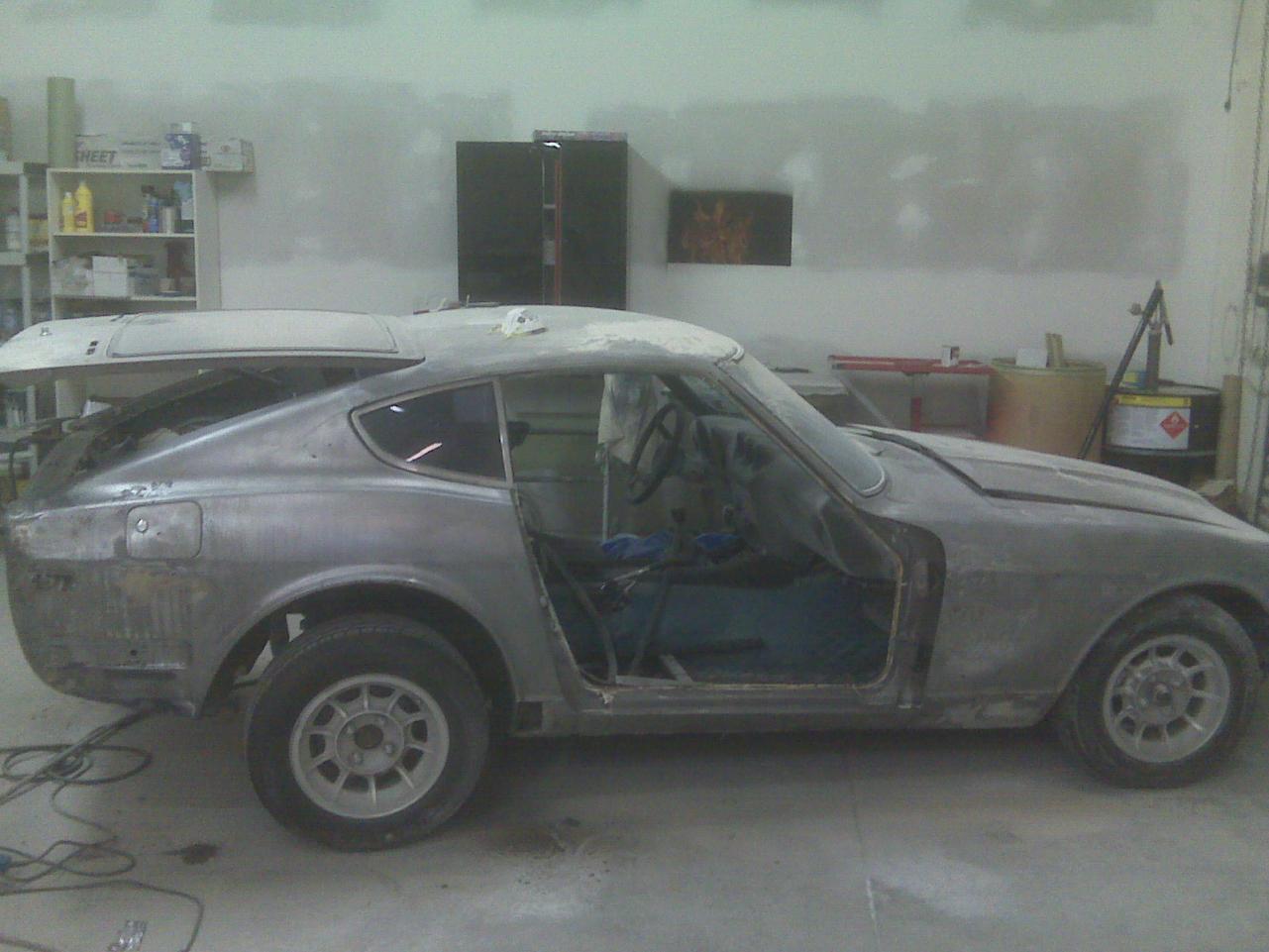

I decided when I bought 797 that I would be restoring her back to original condition, today the entire car including all jambs and engine bay was soda blasted........and the fears of the "Rust Monster" were not to be.
The entire car is very solid save the small area that was cut out, it was only just begining to rust so it was removed, had we not blasted it I'm sure it would have made it's way to the interior of the car. Engine, glass, hatch, fenders, hood, etc all come off later this week and hopefully will be ready for primer in a week or so.
Here's a picture, of course I forgot my camera so I had to use my cell phone. The shop however is documenting the entire process on digital.
I'll post some more pictures when I get back over there.

Why not strip the car to the bare shell before blasting it? Are you going to blast it again after you get the engine, glass, etc out? I had a parts car that someone had soda blasted with the interior in it and it was a mess. That soda gets in every nook and cranny.

Mike, yes once everything is out it will be blasted again. We wanted to see if there were any major issues hiding. I wasnt concerned with the soda going everywhere as the interior will be removed and the inside restored. (Thats the part I really enjoy).
