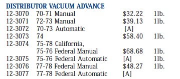

November 20, 200816 yr comment_266898 If your car is a manual transmission, you can get them new from MSA, as shown in the attached screenshot from the CD version of their catalog. And since MSA has them new, I'm fairly certain that they must be available other places as well. Link to comment https://www.classiczcars.com/forums/topic/30029-vacuum-dashpot/#findComment-266898 Share on other sites More sharing options...
November 20, 200816 yr Author comment_266917 That was the first place I called. They said they were no longer available. I have searched the internet but haven't been able to find one anywhere. Thanks Link to comment https://www.classiczcars.com/forums/topic/30029-vacuum-dashpot/#findComment-266917 Share on other sites More sharing options...
