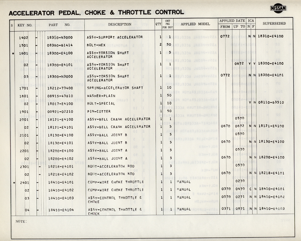

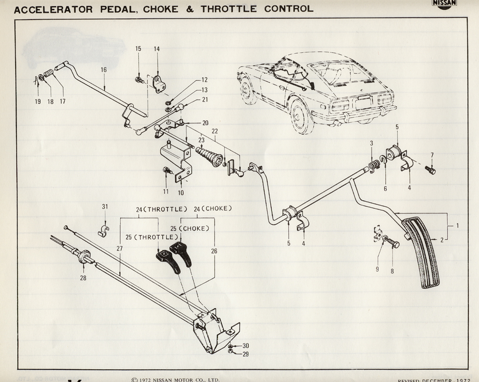

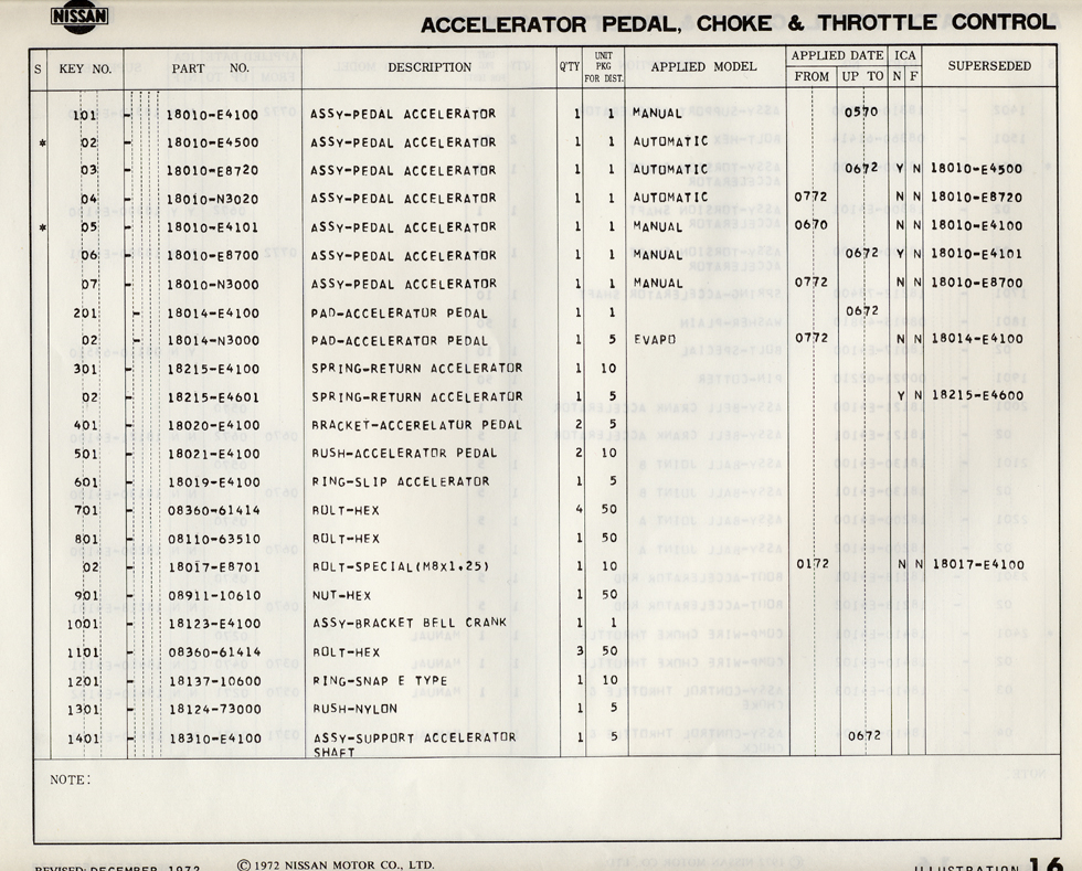

Take a look at the attached scans, which are taken from the 1972 RHD Export market factory parts list. They should give you a pretty good idea of what you have and don't have, I hope.

If you have the foot feed and the rest of the stuff inside the car, the blow up looks like everything else through the firewall and on to the balance tube is the same as the US models. Pretty sneeky how they did that.....
No, it's a little bit more complicated than that. The 'Bell Crank' and 'Bell Crank Bracket' in particular are completely different between RHD and LHD versions. Hopefully they will still be attached to his '72 RHD car, so he won't have to source or fabricate them.
The ball-jointed actuating rod that sits parallel to the firewall is very long on the RHD, but if that is missing it would be fairly easy to replicate.
I got with Steve this morning and he has everything you need with the exception of the long dogbone that goes across the fire wall. He can build you one fo those.
