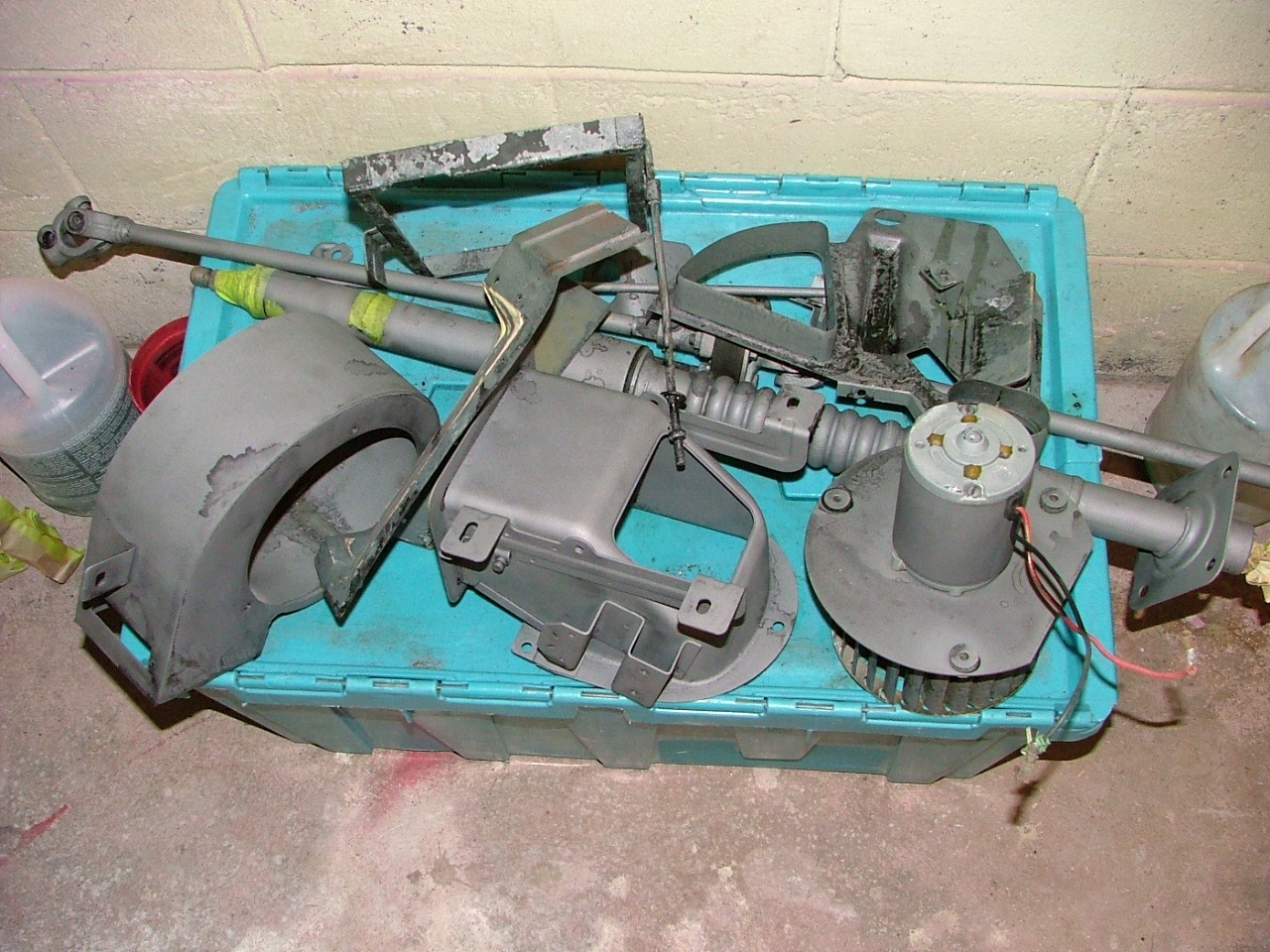

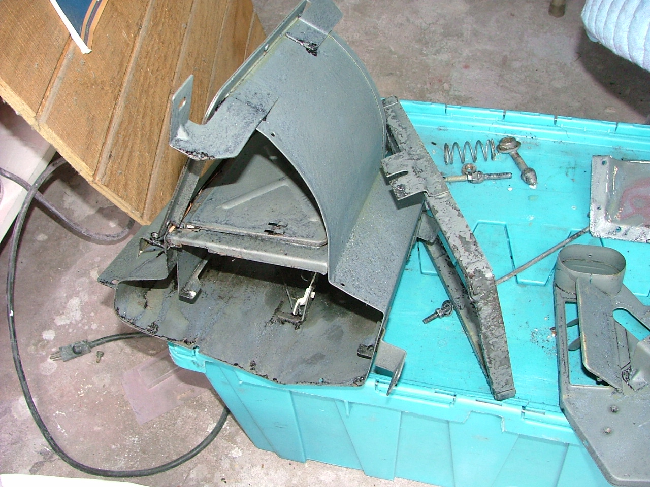

November 24, 200816 yr comment_267234 Here's some pics of sandblasted '71 240Z under dash parts. Black stuff is crusted ospho. Link to comment https://www.classiczcars.com/forums/topic/30056-help-me-get-some-heat-out-of-my-heater/#findComment-267234 Share on other sites More sharing options...

November 25, 200816 yr Author comment_267341 Here's some pics of sandblasted '71 240Z under dash parts. Black stuff is crusted ospho.Ospho?? Which is??Hmm well both heater doors are indeed opening. I may look into the leaves angle, although this car is only outside when driven on Saturdays, and for short periods.Thanks for the great link on the heater info. It's not from the regular service manual? Edited November 25, 200816 yr by deadflo Link to comment https://www.classiczcars.com/forums/topic/30056-help-me-get-some-heat-out-of-my-heater/#findComment-267341 Share on other sites More sharing options...
