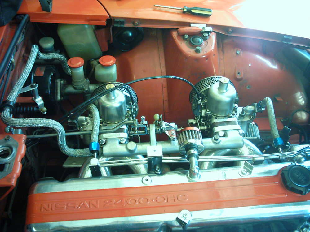

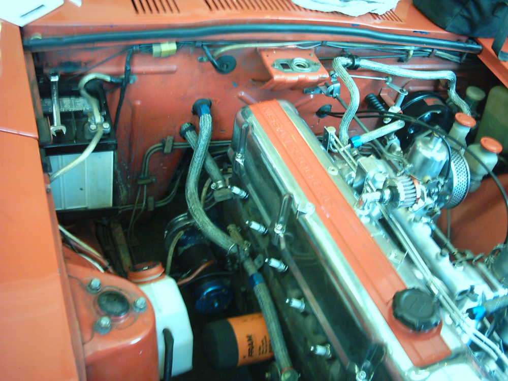

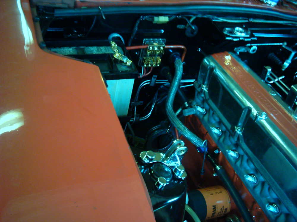

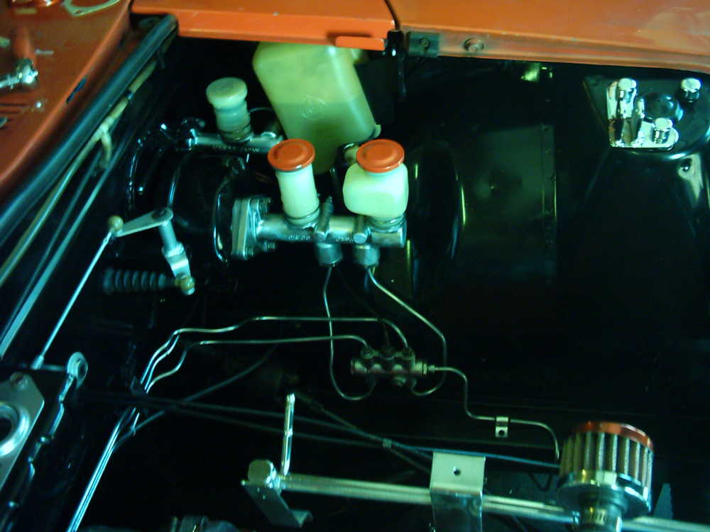

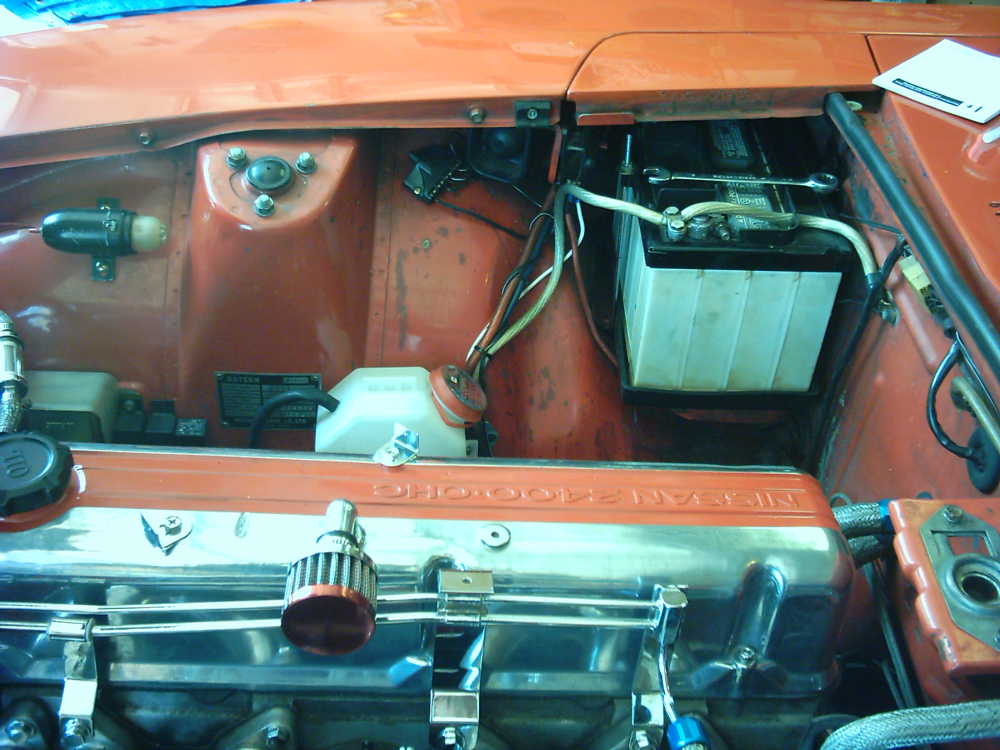

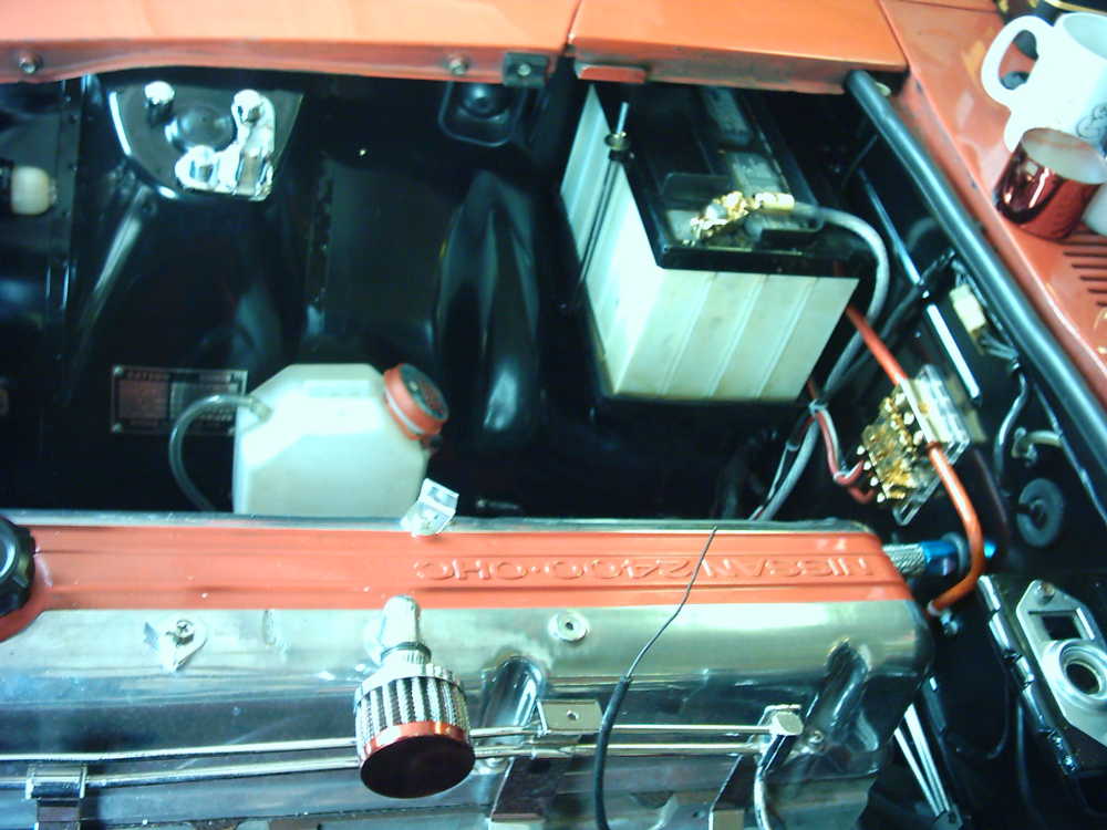

January 26, 200916 yr comment_272080 You can leave the brake lines in. I would just unclip them to see if you can pull them away from the firewall a bit so you can paint behind them. Then mask them. You can most likely pull the wiring harness loose and just lay it on the engine crossmember as I did. I just put it all in a bag and taped it up. If you pull the engine, radiator, carbs and all other loose bits, you can leave everything else in and mask it Link to comment https://www.classiczcars.com/forums/topic/30114-cost-to-professionally-refresh-engine-bay/?&page=2#findComment-272080 Share on other sites More sharing options...
January 26, 200916 yr comment_272102 If you can pull the motor, you'll have a lot more room to work with. I personally Left the block and head in, when I did my engine bay refresh. I loosened the brake and fuel lines then wrapped them with tin foil, as it stays in place and holds it's shape. Paper can be loose and absorb some paint, onto the lines or whatever is being painted. Just depends on what you use. I started off with stripping the motor of everything but the front cover and head. Then I taped off the aluminum parts, (head, front cover and valve cover) then sprayed Oven Cleaner on the block. This helps remove the baked on grease from years gone by. Then I used engine degrease on everything else to sort of preprep for the rest of the cleaning. Then I used good ol' fashion dish soap (Dawn) with a green Scotchbrite Pad to srub all the other crap loose. I used an air gun to get the water out of all the crack and corners, don't need any suprises later on. Grease and wax remover on everything. But before I piant, I used Red Scotchbrite on the brake and fuel lines to brine a little luster back to them. The powdery residue comes right off and they get a "Brushed" look. Then I wrap them in the tin foil. I shot everything with Duplicolor Black Sandable Primer. I used tape on the backside of all the holes (inside the wheel wells) and paper rolled up in the threaded holes. Then gave it a once over with the scotchbrite, blew it all off, then painted it with Duplicolor Ford Semigloss Black. Do Not remove the tin foil till everything is dry and the flakes from the foil won't contaminate the new paint. To get the Fresh Casting Look back on the Aluminum parts. I just used a steel wirewheel on my bench grinder. Just degrease it, dry it then wire wheel it lightly to bring back the shine and texture. The fluid resevoirs were cleaned with brake cleaner. Just hold it with a pair of needle nose plyers, Spray it with the brake cleaner w/ the stray attached, letting the old fluid and cleaner run off into a coffee can, this will leave no finger prints. Let it air dry by hanging them somewhere. It won't take long because of the evap time on brake cleaner. All in all, it only took a day to remove everything, degrease, scrub and clean, wrap parts, prime and paint. Then another day cleaning, small part painting and reinstalling everything. I wrapped the whole car in plastic up to the cowl, taped off the fenders then wrapped in plastic, covered the crossmember, Bagged the harness up to the firewall and taped off the radiator holes. It doesn't take long and the end result is envious of most, as most wish theirs looked like this. Hope that helps a little. Most will want to use something other than spraypaint but most of my pet projects are on a strict budget. But as you can tell, a tight budget doesn't mean it has to look like it was done by a "tight" wad, ya know? I spent less than $100 on the engine bay refresh. Dave. Edited January 26, 200916 yr by Zs-ondabrain Link to comment https://www.classiczcars.com/forums/topic/30114-cost-to-professionally-refresh-engine-bay/?&page=2#findComment-272102 Share on other sites More sharing options...
January 26, 200916 yr comment_272113 As others have said, Dave, nice engine bay! Nice to know that you can have nice results with little cost and even leaving the engine in. I had my car painted and didn't get the engine bay done. It is in need! You have inspired me!! Link to comment https://www.classiczcars.com/forums/topic/30114-cost-to-professionally-refresh-engine-bay/?&page=2#findComment-272113 Share on other sites More sharing options...
