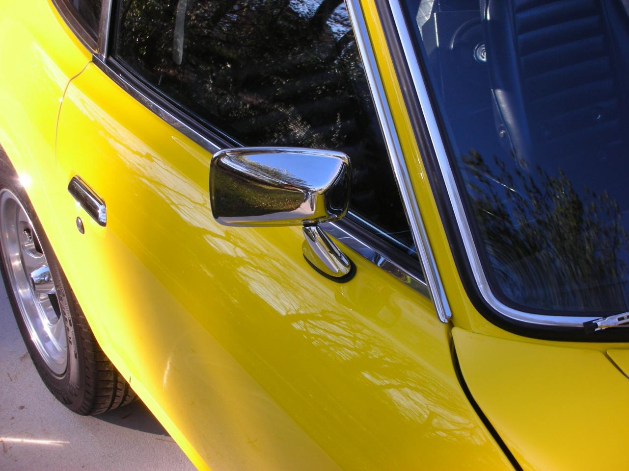

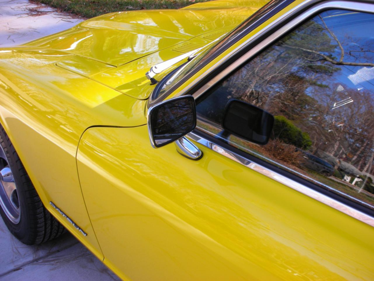

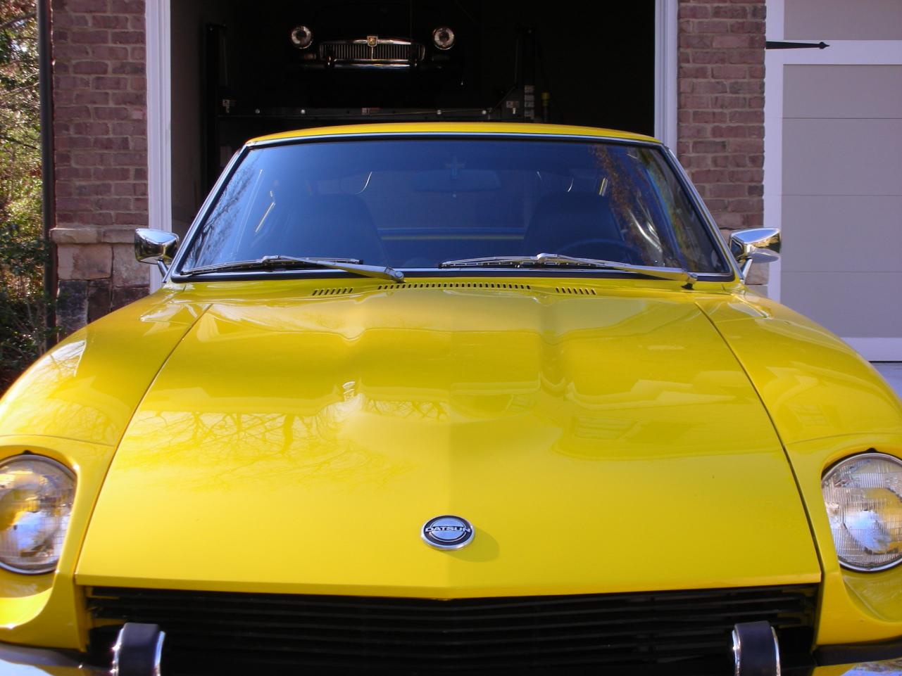

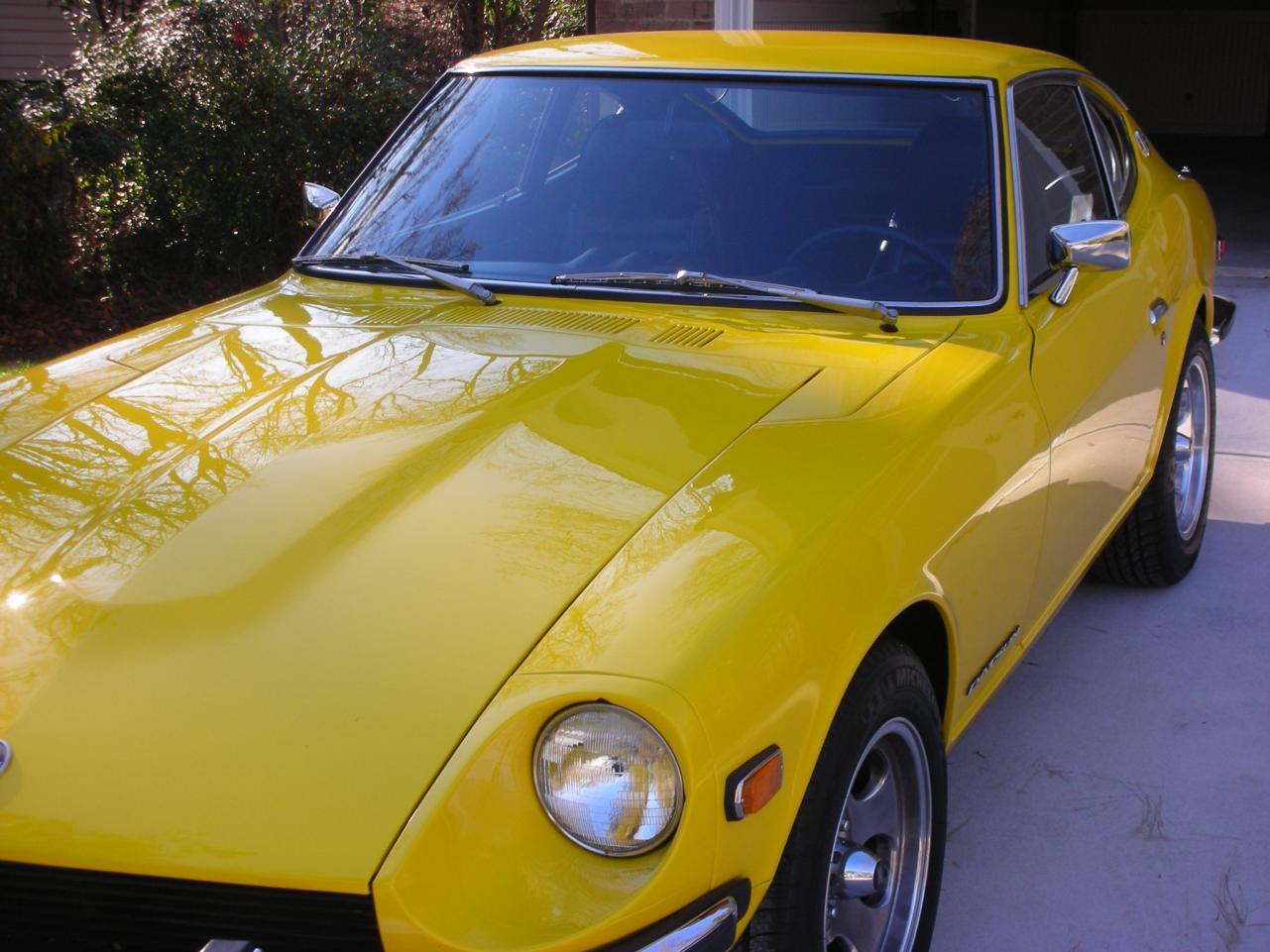

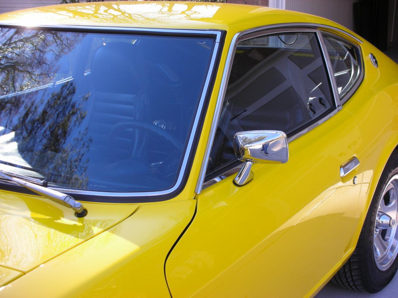

DougN Posted December 29, 2008 Share #13 Posted December 29, 2008 As an alternative, you could use some late MGB mirrors. I just put them on my Z when I had some paintwork done and got rid of the stupid, small black plastic useless mirrors the PO had put on. The MGB mirrors are available from Moss or Victoria British (aka Black Dragon) and are for a '77 ~ '80 MGB, and cost about $35 each new. You can grab some from a pick-and-pull for a couple bucks each. Here are a few photos I snapped in the driveway this afternoon. Link to comment Share on other sites More sharing options...
Tarmac Posted December 29, 2008 Author Share #14 Posted December 29, 2008 Well those look a hell of a lot better then the black plastic things on my Z now. And cheaper then the stock ones. I just looked again at courtesy and it says they are a special order item, and make take 3 months to deliver. Things that make you go hmmm.... Link to comment Share on other sites More sharing options...

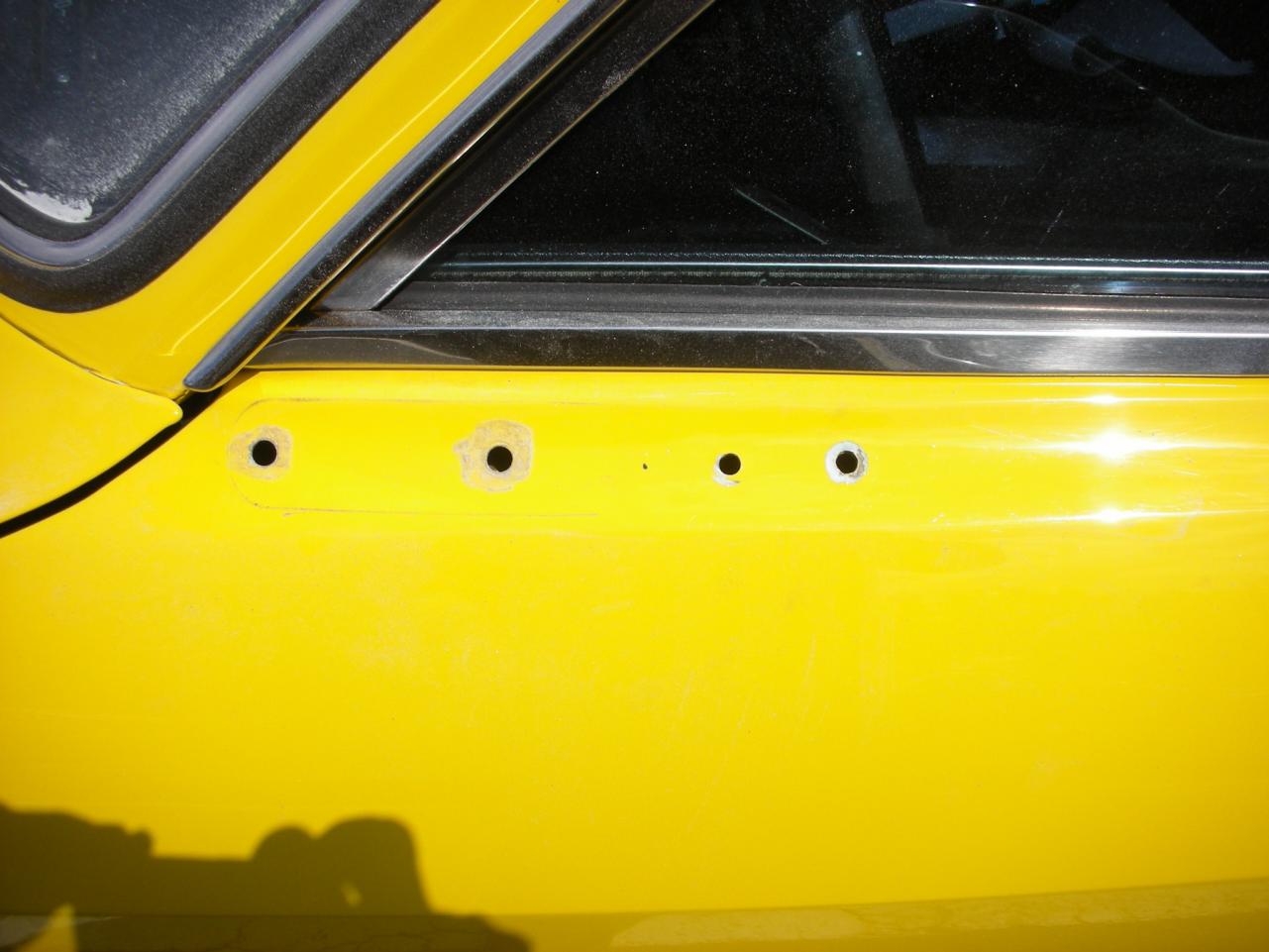

DougN Posted December 30, 2008 Share #16 Posted December 30, 2008 Jack, My car did not have the original holes, but my guess is you may need to drill at least one new hole. I'll measure the distance between them later and post it, so you can tell for sure. As long as the base covers the old holes, should be no worries. I drilled two new holes as the PO had put these plastic mirrors at the very front of the door. Here are photos of the old mirrors and the new holes drilled out (the rear set), and the old holes for the black plastic mirrors (front set) when I had the doors repainted: Link to comment Share on other sites More sharing options...

DougN Posted January 1, 2009 Share #18 Posted January 1, 2009 I got around to measuring the MGB mirrors, and the measurements are as follows:-- The base is 3.5" long, and 1.5" wide. -- Holes are 1 3/8" apart at the centers.Hope this helps you determine if you need to drill new holes, and/or if the base will cover whatever existing holes you may have! Link to comment Share on other sites More sharing options...
